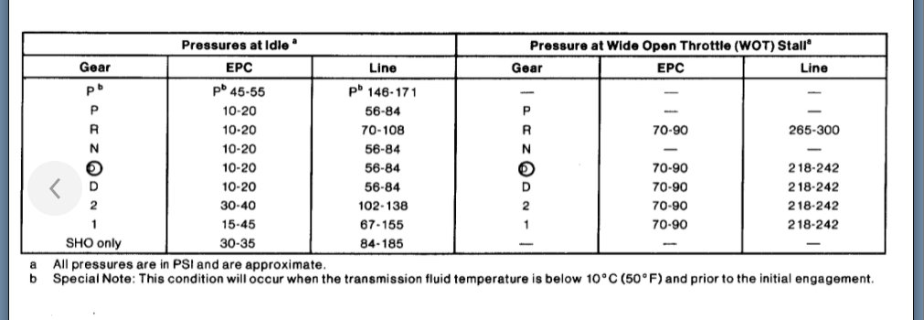

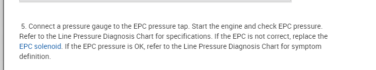

Replaced the torque converter. But since putting it back together the battery keeps draining so I have to jumpstart it and it doesn't move when shifting gears. The reverse lights illuminate in the back, but I can't hear or feel the transmission engaging.
Apr 1, 2022 at 8:28 AM
These are most likely going to be two different issues unless something was missed when putting the transmission back in.
However, let's address the transmission issue first. If this was not an issue prior to replacing the torque converter, then the likely issue is that the fluid is low, or we have an issue with the converter.
https://www.2carpros.com/articles/how-to-check-and-add-transmission-fluid

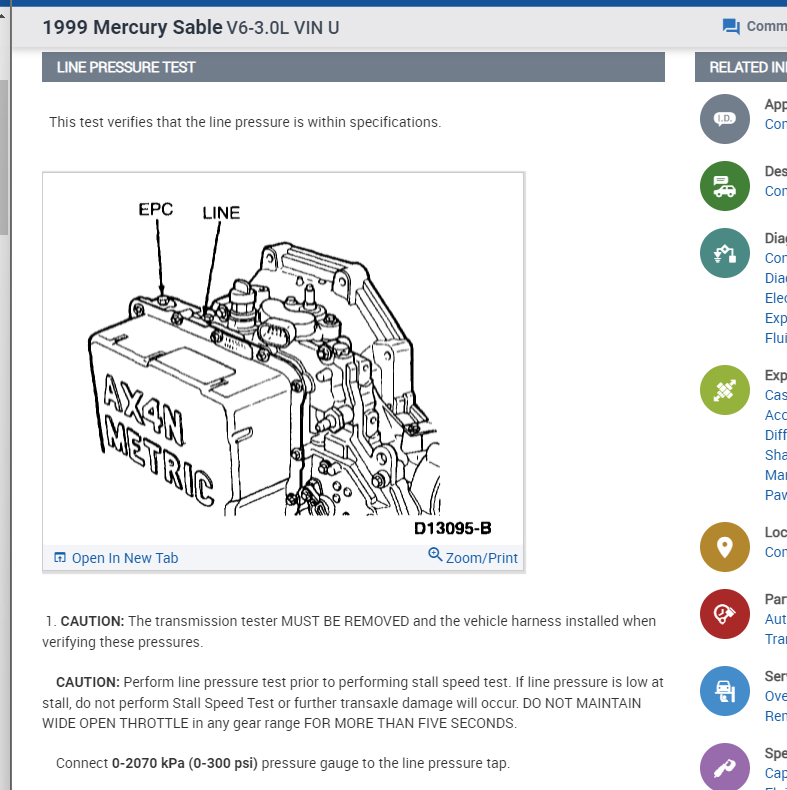

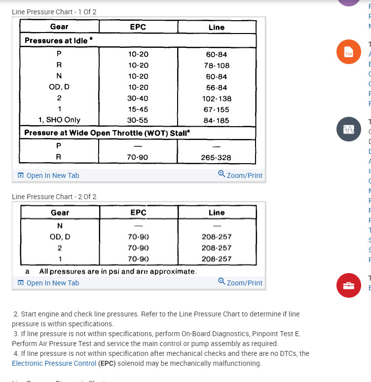

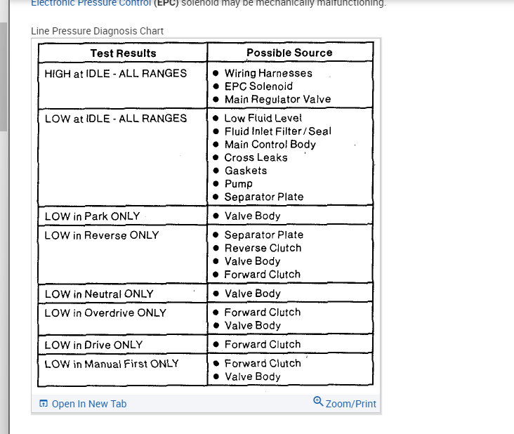

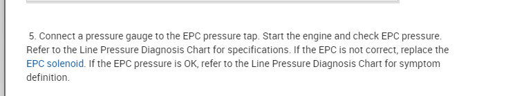

If the fluid is at the correct level, then the likely cause of this is the converter is not fully seated causing the pressure not to build to allow the vehicle to engage.
Below is a process on how to check the line pressure which should confirm this is the issue.
Let's run through this info and go from there.

Found out that the rod went through the valve body and got stuck. So, I put a new valve body on the transmission. But now my battery keeps draining and the starter keeps clicking. so, I'm going to replace the alternator and see what happens.
