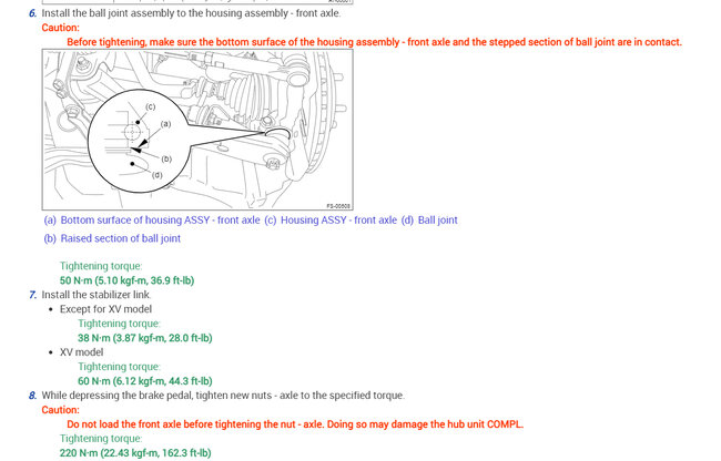

Slight knocking sound clearly coming from front right tire area, sounds related to cv joint. This started occurring when i turned sharp right (not all the time). Now it is still not all the time, but definitely more frequent and happens when i accelerate and turn right.

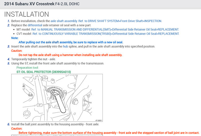

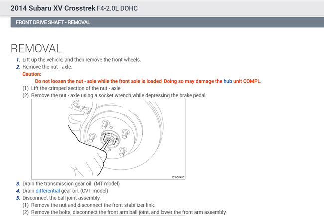

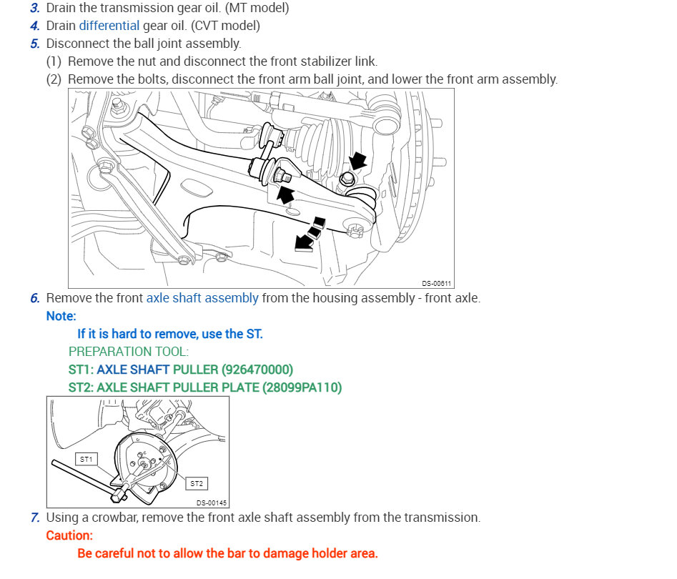

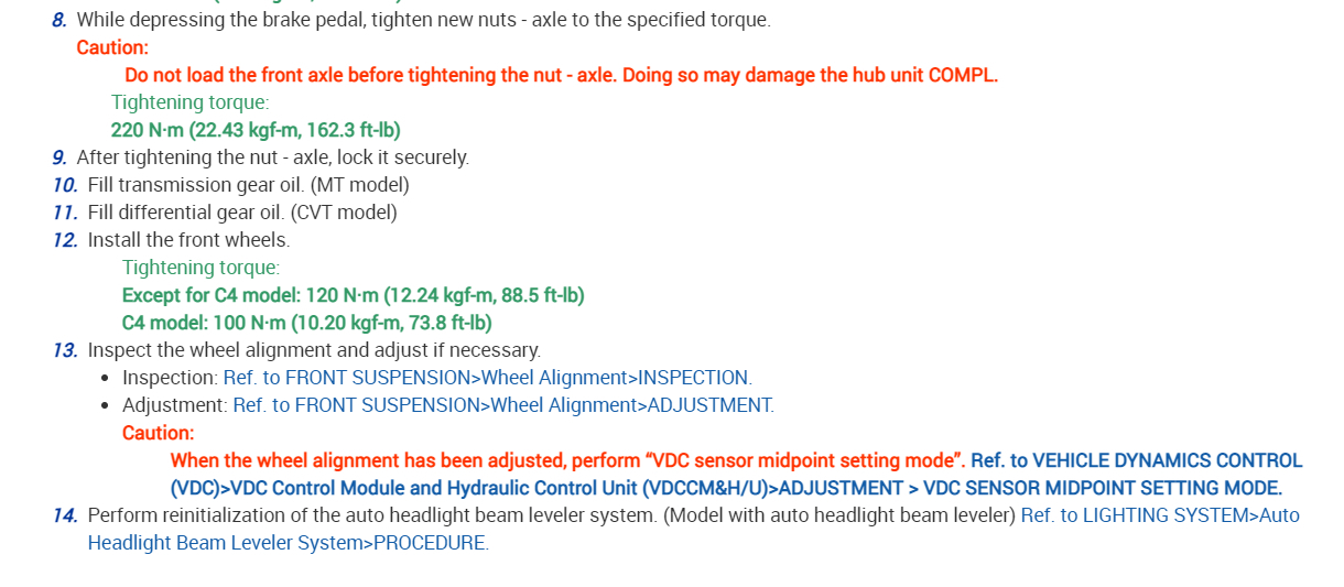

Please start a new question for the additional problems, one handle one problem per thread. It does sound like the CV axle is worn out. You can get a new axle from Amazon for $79.00.
Here is a link:
https://amzn.to/3Kwu6HC
Here are the instructions to change it out in the images below. Check out the images (below). Please let us know what happens.
