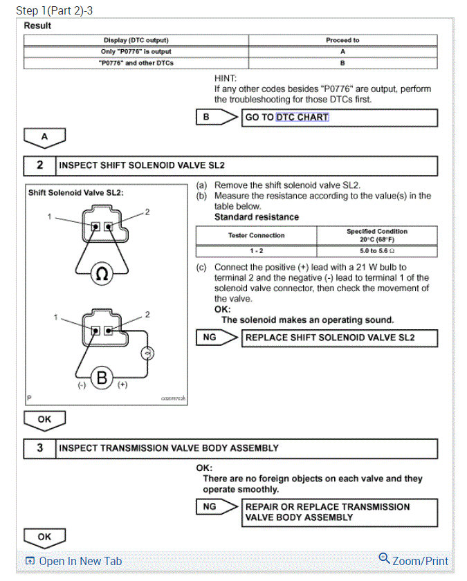

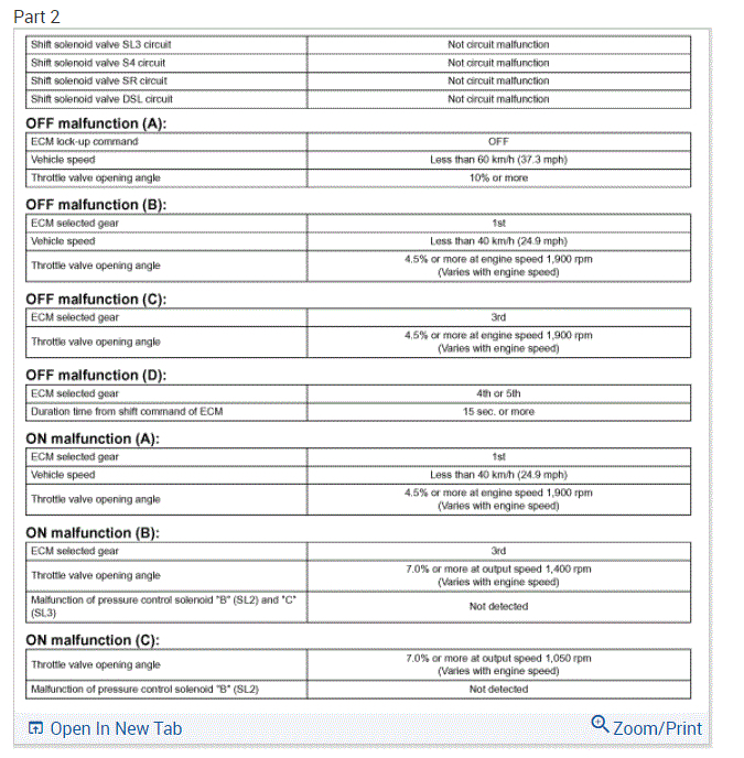

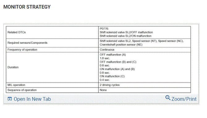

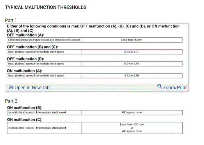

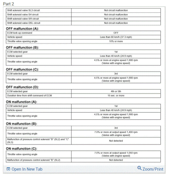

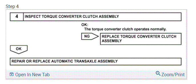

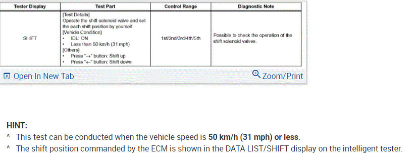

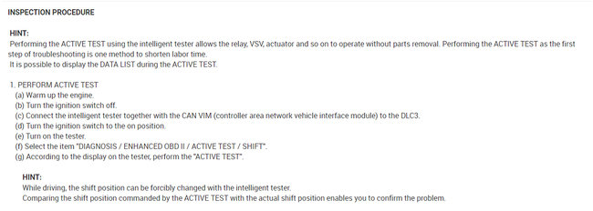

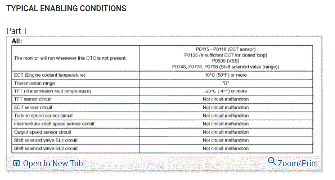

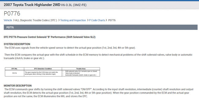

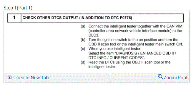

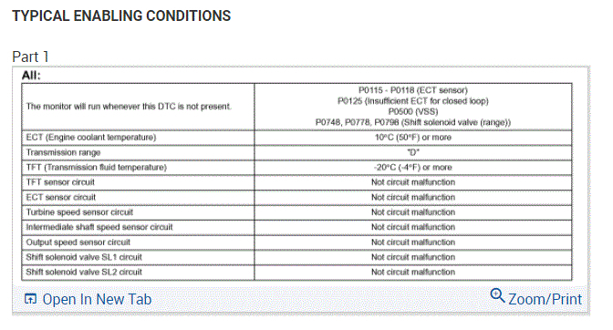

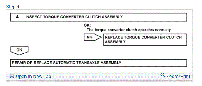

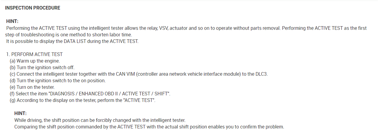

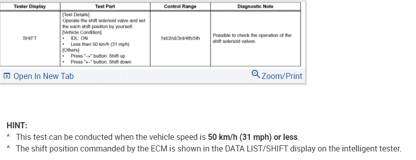

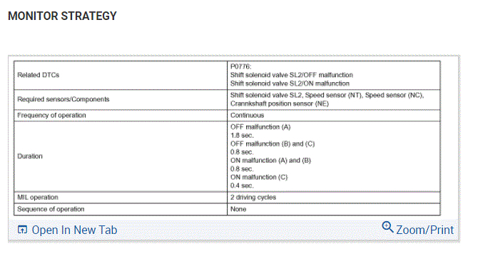

The code is specific to the pressure control solenoid B. Did you actually replace it or just check the ones in the vehicle? As far as applying voltage to them, that isn't always a good way to check. How much voltage was applied?
If you did replace the solenoid, take a look through the attachments. They provide the diagnostics specific to this code and vehicle. Let me know if you are comfortable performing the tests.

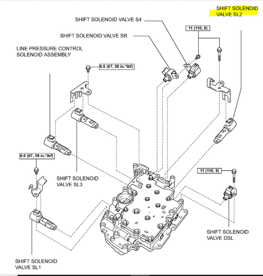

The voltage applied to them was 12-volts. and how will I know the exact solenoid? any diagram please?
Oct 15, 2021 at 2:51 PM
  • 110,240 POSTS
The solenoid valve (SL 2) is mounted on the valve body. If you look at the attached pic below, I highlighted it for you.
Let me know if this helps.

It is now working fine.
Oct 19, 2021 at 6:19 PM
  • 110,240 POSTS
Glad to hear that. Was it the solenoid valve (SL2)?
Oct 20, 2021 at 11:07 AM
BLESSING EWOBOR
  • 753 POSTS
I replaced the valve body.
