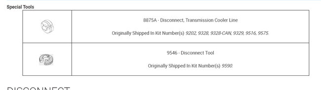

Special Tools
Pic 1
8875A - Disconnect, Transmission Cooler Line
Originally Shipped In Kit Number(s) 9202, 9328, 9328-CAN, 9329, 9516, 9575.
9546 - Disconnect Tool
Originally Shipped In Kit Number(s) 9590.

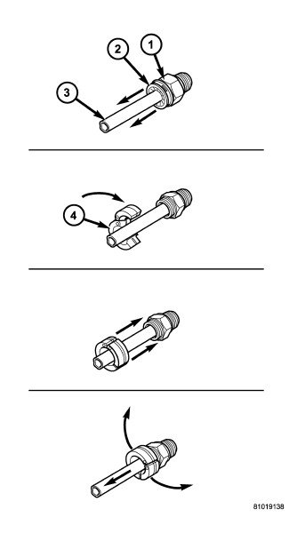

DISCONNECT
Pic 2
Remove dust cap by pulling it straight back off of quick connect fitting
Place disconnect Special Tool 8875A onto a3 /8 inch transmission cooler lines or Special Tool 9546 onto a 1/2 inch transmission cooler lines with the fingers of the tool facing the quick connect fitting.
Slide disconnect tool down the transmission line and engage the fingers of the tool into the retaining clip. When properly engaged in the clip, the tool will fit flush against the quick connect fitting.
Rotate the disconnect tool 60° to expand the retaining clip.
While holding the disconnect tool against the quick connect fitting, pull back on the transmission cooler line to remove.

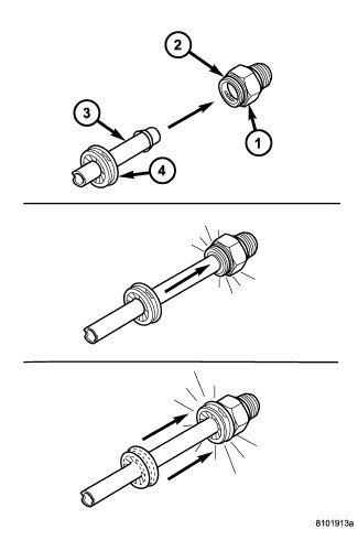

pic 3
Align transmission cooler line (3) with quick connect fitting while pushing straight into the fitting.
Push in on transmission cooler line until a click is heard or felt .
Slide dust cap (4) down the transmission cooler line and snap it over the quick connect fitting until it is fully seated and rotates freely. Dust cap will only snap over quick connect fitting when the transmission cooler line is properly installed.

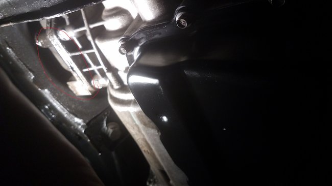

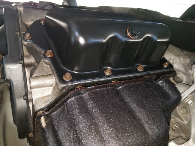

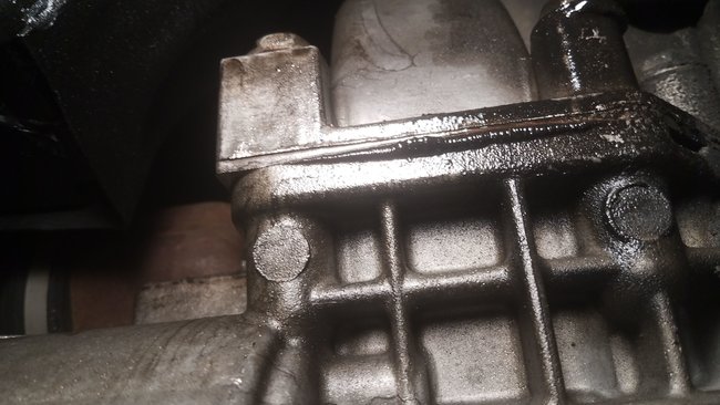

Thank you for the info. I was able to switch out the pan and the transmission cooler lines and no more leaks from those but I discovered three additional leaks once I got under the van. Hopefully you can give me a tip on those.
1) I cleaned up around the pan and front cover then I took the car for a 15 minute drive and when I came back I saw trans fluid on the front cover (please see Photo 1.jpeg) would fluid be coming out of the cover that covers the solenoid pack? are there seals on the solenoid pack that need to get replaced and also is RTV gasket on that cover?

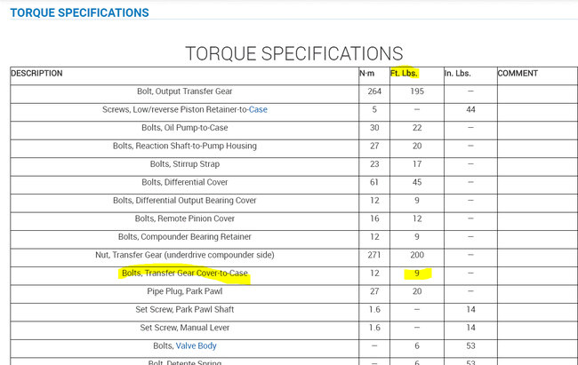

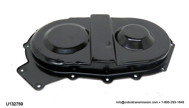

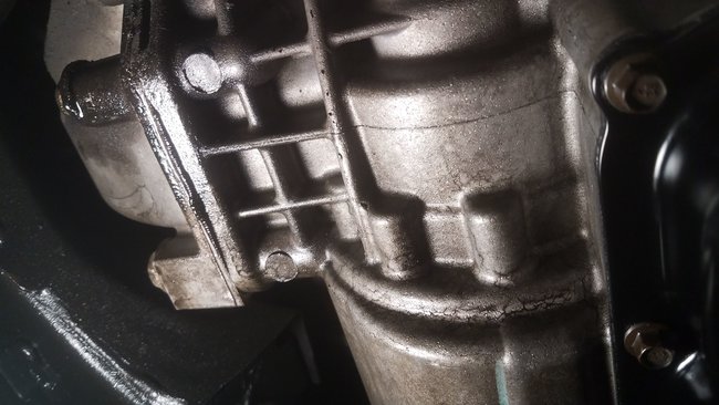

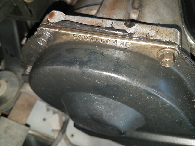

2) I also saw a leak on the transfer gear back cover (please see photo 2.jpeg) it looks like the RTV is swollen in one little spot but hard everywhere else and it drips a couple of drops once I park it from there.should I just remove the cover and put new RTV? or are there seals behind the gears that need to be replaced or is it normal to have fluid behind that cover?
can you please provide me with the torque specs for the bolts for the transfer gear cover?
3) I found a third leak where RTV is swollen in one spot ,drips a drop or two after parking. (please check photos 3.jpeg 4 and 5) I think there is where the transmission meets the engine (not sure). does that require the transmission to be completely removed to seal it with RTV?

Nice work! As far as pic 1, yes there is fluid behind that pan. I believe Chrysler uses an RTV from the factory when they seal them. You could get a gasket to replace it if wanted or use the Black RTV (form a gasket). As far as the solenoids, they wouldn't cause that leak.
Now, I can't tell what I'm looking at in pic 3. Can you explain?
Pics 4 and 5 appear to be what you said, where the trans and engine meet. Now the interesting thing with that is it could be ATF or motor oil. At the end of the crankshaft is a seal referred to as a rear main seal. For that to be replaced is extensive because the trans and engine need separated and then the engine oil pan needs removed. It's not a fun job, LOL So, confirm if it is motor oil or ATF. If ATF, then it most likely is the front pump seal. There is an input shaft that goes through it and a seal there can leak.
Let me know if you determine which type of oil it is. I will be happy to walk you through the process. Also, please confirm what you are referring to by transfer gear. Do you mean the differential?

for the second leak, by the transfer gear cover I am referring to this second picture. there is a leak from the bottom in one spot. If I may get the torque spec for the bolts as well and steps. It seems straight forward. For these pans, should I be placing the RTV silicone on the pan or the body where these pans sit? does it matter?

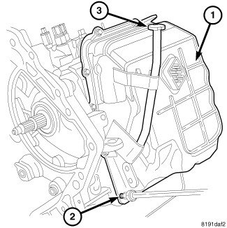

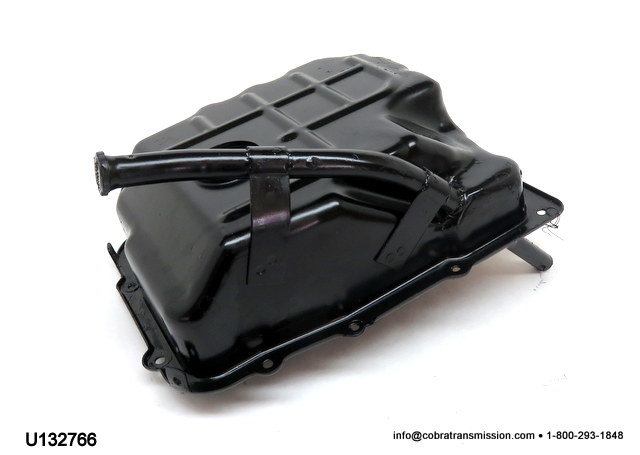

Here are the directions for removal and replacement of the side pan which covers the valve body. The torque specs are included and the attached pics correlate with the directions. The transfer gear cover directions are last. I attached a pic of the torque specs.
If a gasket is available, that is what I would use. If not, then use the RTV. Just make sure to follow the directions for the specific RTV you get.

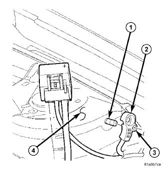

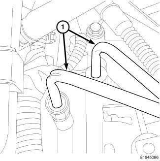

Pic 2
Disconnect oil cooler lines (1) from transaxle using Trans Cooler Line Disconnect 8875A . (Refer to 07 - Cooling/Transmission/TUBES AND HOSES, Transmission Oil Cooler - Standard Procedure)
Position oil cooler lines aside away from the valve body pan.

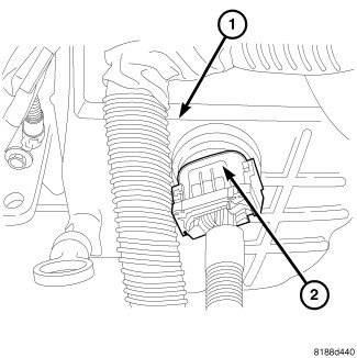

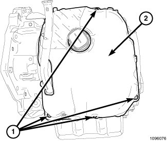

Pic 4
Remove the solenoid pack connector (2) at valve body oil pan (1).

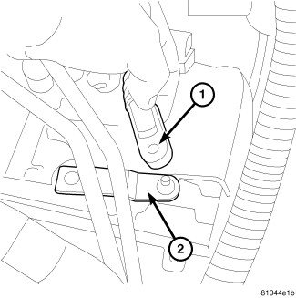

pic 5
If equipped remove the push pins (1) to front lower closeout.
Remove the front lower closeout.

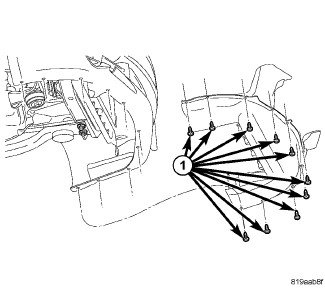

If equipped remove the fasteners (1) and the Front Sound Damper Cover (2).
pic 7
Remove the top valve body oil pan (3) bolts.

Install the valve body oil pan, use a bead of MOPAR® ATF RTV (MS-GF41).
Install the upper valve body oil pan bolts and tighten to 6 N·m (50 in. lbs.).
Install the pressure tap at valve body oil pan and tighten to 6 N·m (50 in. lbs.).

Install the left side inner wheel splash shield screws (1).
pic 11
Install the Front Sound Damper Cover (2) and the fasteners (1).

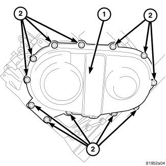

pic 13
Remove transfer gear cover-to-case bolts (2).
Remove transfer gear cover (1).
Install and torque specs attached in pic 14.
