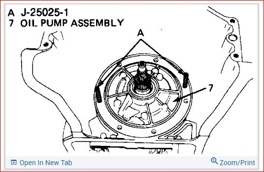

If this is truly coming out from the bell housing most likely it is the seals that seal the torque converter to the front pump. This is assuming it is transmission fluid which is why you are saying it is a transmission leak. However, if it is engine oil, then it is most likely the rear main seal for where the torque converter and the crankshaft meet.
Here is a picture of the pump with the torque converter removed to try and illustrate this for you.

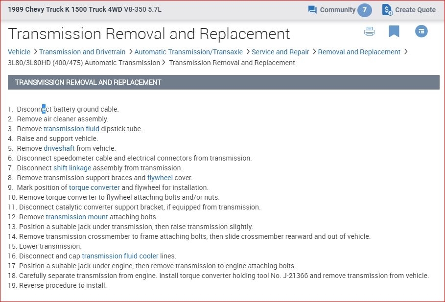

The repair for this is to remove the transmission, remove the torque converter and replace the seals. Then reinstall the transmission. If it is the rear main seal, it is the same procedure but instead of removing the torque converter you just leave it as is and replace the rear main seal on the engine. However, both require you to remove the transmission.

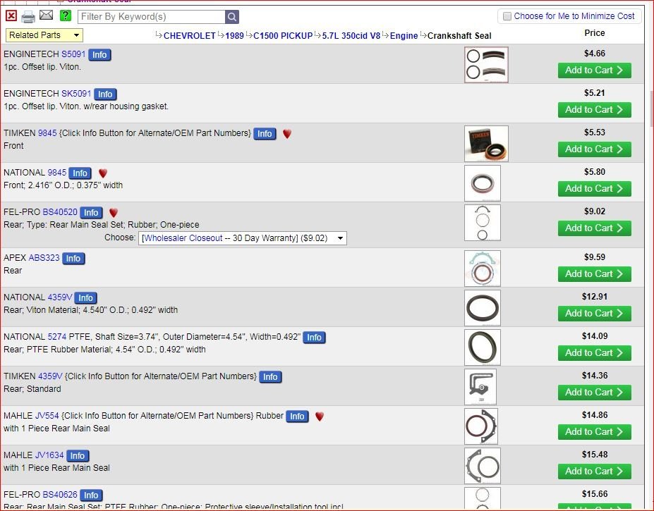

Okay, thanks for the information. How much does a new rear main seal usual cost for just the part, I'll do the labor myself?
May 14, 2021 at 4:32 AM
There are a ton of options for this engine. They range from $5.00 to $20.00 and up.
It is just a seal that looks like an axle seal.
