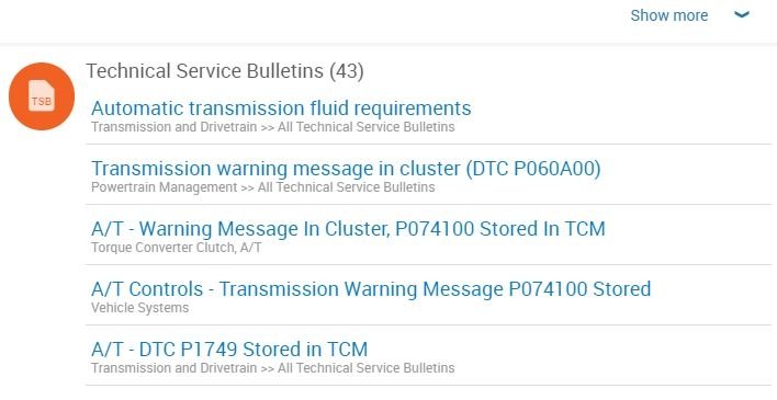

Honestly, yes it could need reprogrammed, but I checked and don't see any technical service bulletins related to shifting. I attached a picture. It shows what transmissions TSB's are active.

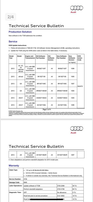

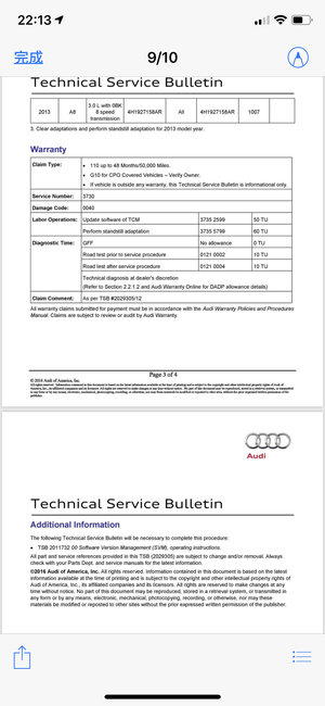

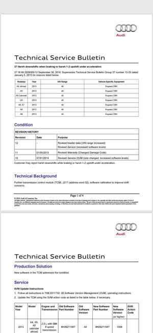

Hi Joe,
Thanks again for the response. The TSB regarding TCM update is Group 37 #16-69 (see pictures). It was released on September 30, 2016. Yet I didn’t notice such shifting issues back then; it’s only a recent thing. But it seems like the TSB addressed the similar issue I’ve experienced so I’ll give it a try. I’ve scheduled for dealer visit next week so I’ll report back if the TSB helps or not.

Sorry forgot to attach the pictures. Here they are.

Hi Joe,
Sorry it took a while to report back. Finally got the car back from dealer. New TCU software was applied and now the shifting issue is gone. As for your brother’s there’s a TSB for its engine/transmission SW too so maybe it will fix the problem for his car as well. Refer to TSB 2033046/1. Be sure to pick a good dealer cuz mine was not willing to do TSB for out of warranty and even lied to me there’s no new SW to update...
