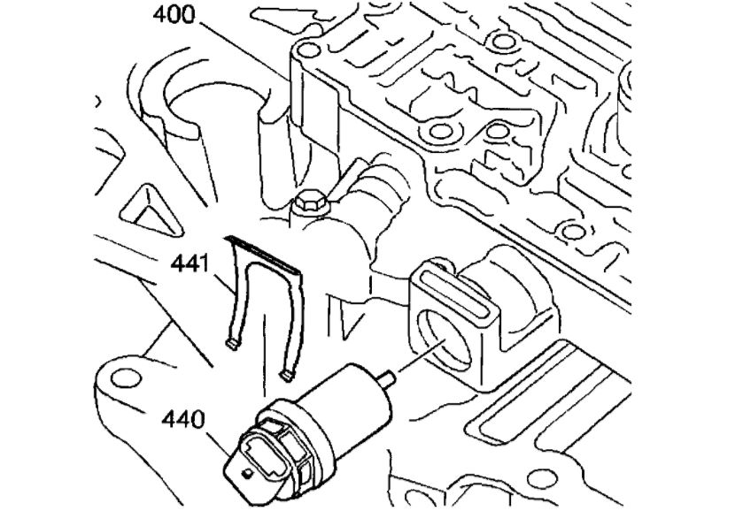

I have the car listed above custom model. The transmission is not shifting right. It will go into gear to drive but while driving down the road it just revs and will not go any farther. i shut it off and start it back to get it to go in gear. Went to a shop and the only code that came up was PO717. Input speed sensor but the guy sold us an output sensor and said that it was more than likely the problem but that did not work. I need to know where the input sensor is located on my car.

the input speed sensor may be there because the input shaft was not turning fast enough to send a signal.
The sensor is inside the transmission under the side cover on the drivers side of the trans.

Picture of the location.
