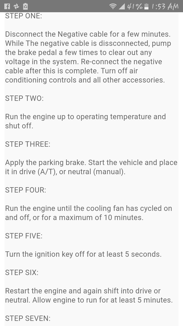

I recently bought a 2000 chevy impala ls. I had to replace the fuel pump along with the line and a few other items to the 3 stage fuel system. Also a complete tune up with new plugs and spark plugs. The work was done by a friends back yard mechanic that's done work on my cars for 10 years now. I was at work the day he competed the work and he left my idle running high. He told me it just needed to be driven for the computer to reset, that didn't work. I read a forum online saying to unplug the negative battery cable, let car run in neutral with ebreak on until fan kicks on then turn car off turn back on, pit it back in neutral with emergency break on again. Now my transmisson is slipping going into 2nd and It didn't do that before the fluid was at level. I went to work car sat for 4.5 hours to cool got off went to corner gas Station by my job which is a block away and checked the transmission it seemed real runny, but full. I want to do a flush on the transmission for my car to see if that helps, but I can't find anything online that's step by step for my car. I obviously did wrong with resetting the computer for the idle because all I needed to do was unplug the negative and plug it back in. I just hope you don't say I ruined my transmission!

I'm not sure what you're asking, but I can clear up some misinformation. The idle speed is indeed controlled by the Engine Computer, but the last thing you want to do is disconnect the battery. Each time you reconnect it, the computer has to start relearning things all over again. Some things take time and some only take place during specific conditions during the drive cycle. In the case of the idle speed, if that is too high, that is usually the result of a vacuum leak.
I've never seen all those steps you listed for doing relearns in any service manual. About the only thing they didn't tell you was to rub your belly while patting yourself on your head. There are a few things you can adjust on some car models, but those usually apply to customer convenience things like horn chirps with remote power locks, and sometimes with programming a new key. There's a real lot of things the computers are going to relearn, but for almost all of them you won't notice any symptoms or know those things are taking place.

Thank you for the information! The question I was meaning to ask was how could I do the flush myself. I just caught up with what I did wrong because I know I'm the reason the transmission is acting funny now. I'm happy to read about the car needing to relearn the transmission because that's what I truly believe is wrong. It had no issues before I did the the steps in the pictures I provided. Don't even ask why I would do it lol. I don't have the cash to go to a shop right now and I need my car to be in working order. I'm going to hope that after a day or so of driving that it fixes itself. I will also take it to my near by auto part store for a reading for help on it as well again thank you for the information.

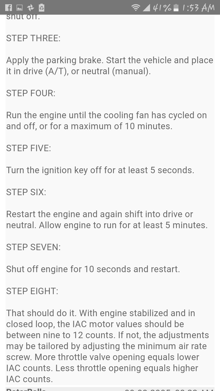

The charts you posted are for much older cars. There were some weird procedures when throttle position sensors were a new thing and were stuck inside computer-controlled carburetors. I wrote a paper on the 1980 models for a graduate class in college that covered them under "new technology". The first clue was the reference to the idle speed adjusting screw. No engine has had that since the mid to late '80s. When we did have those, air could enter the engine through the partially-opened throttle blade, which we could adjust, and through the controlled air passage around the throttle blade, which is what the computer uses to set the idle speed. If you adjust the idle stop screw for a higher idle speed, the computer will just come along and close the valve more to bring the idle speed to where IT wants it to be.
On your engine, the idle speed motor is the same exact part that is used on Chrysler products. The computer pulses the motor to one of 256 positions, and as it rotates the armature very slowly, it is turning a threaded rod that has a pintle valve on the end. As the steps increase in number, more of the valve opens up, and more air can bypass the throttle blade. For a properly-running engine, step 32 is typically what you'll find it set to. With a single-cylinder misfire, you can expect to see it on around step 50. In the case of Chrysler products, if "minimum throttle" hasn't been relearned after the battery was disconnected, idle speed will be too low, and stalling and hard starting are common unless you hold the accelerator pedal down 1/4". This is a case where the drive cycle I mentioned becomes the issue. A very specific set of conditions, including unusually-high intake manifold vacuum, and a perfectly steady reading from the throttle position sensor, are required for the computer to know when your foot is off the accelerator pedal. All of the relearn conditions are met by driving at highway speed with the engine warmed up, then coasting for at least seven seconds without touching the pedals. Moving the accelerator pedal, (throttle position sensor) or tapping the brake pedal, cancels the relearn.
The clue the instructions you were given did not come from GM is the phrase, "That should do it" in step 8. Technical manuals, to include manufacturers' manuals, are never written like that. Those instruction were written by a technical person. They just wouldn't appear in the service manual that way. This is how a description would be written on a consumer-level web site to disseminate information.

Thank you for the information! I wish I had asked how to do the idle through here rather me goggle it and obviously do what's wrong. I will take the car on the freeway today and let it coast to see if that will help. With me following the steps in the picture do you think I runied my transmission? I didn't complete the steps after 5 because it was back at regular idle speed so I just stopped. Idle has remained normal. Now I just worry that I runied my transmission.
