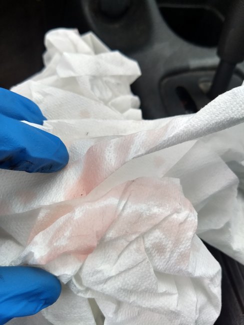

Thanks for the reply. The transmission fluid is full and it's a light pink color. There is no check engine light on.
Sep 12, 2019 at 1:54 AM
DMS88
That is the color of the transmission fluid. I tried to get the picture as best as I could.

Welcome back:
That looks and sounds normal. Now, it could be several other things. It could be related to a partially plugged transmission filter reducing line pressure, a pump issue, a shift solenoid issue, or even a problem with the transmission control module (TCM). Since the check engine light isn't on, most likely there are no diagnostic trouble codes stored. At this point, it becomes a guessing game. When I say guessing, I mean which thing do we check first. The easiest would be to drain the fluid and check for contaminates in it such as clutch material or metal shavings. Next, transmission line pressure would need checked to make sure it is within spec. And the list goes on.
If you want to walk through it, let me know. Honestly, without a trouble code, it makes things much more difficult.
