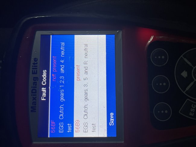

Code 56C0, transmission is not shifting properly
2011 BMW 328XI
114,000 MILES • 6 CYL • 4WD • AUTOMATIC
BHAMDOC1
  • 341 POSTS
I changed the oil after finding out there was a leaking oil cooler and there was only 1.5l of fluid in the transmission, and the car wouldn't move at all. Now with full fluid if i put it in drive or neutral it acts as drive, and nothing happens when i shift into reverse, doesn't move at all. Only code I have now is 56C0. Looked it up couldn't find anything. EGS: clutch gears 1, 2, 3 and 4: stall test.

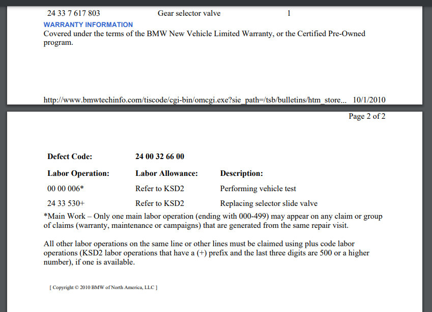

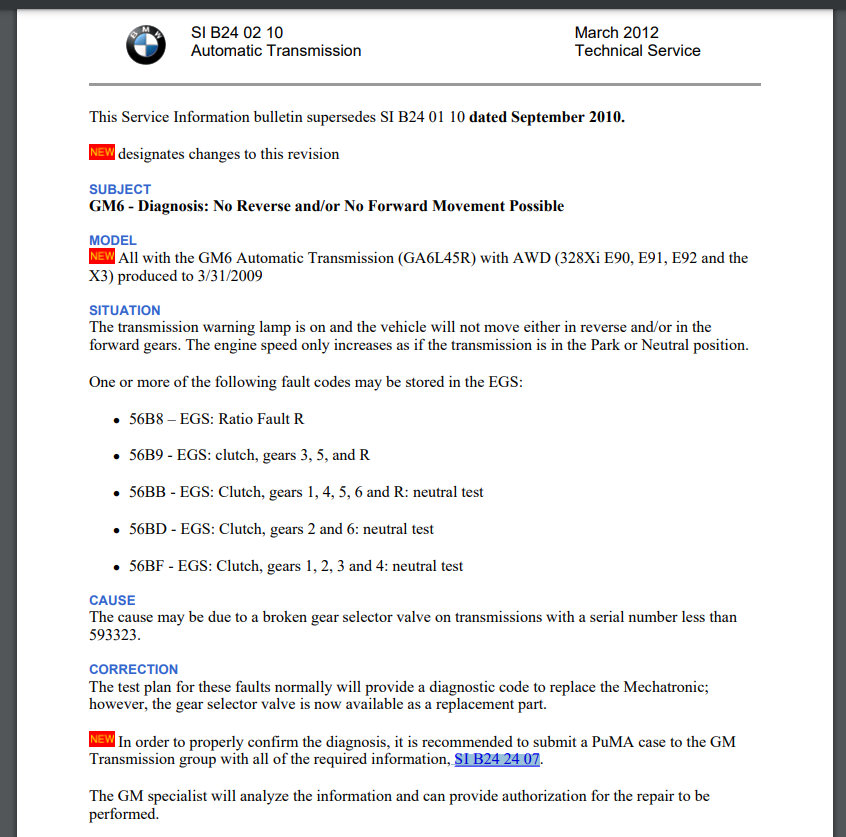

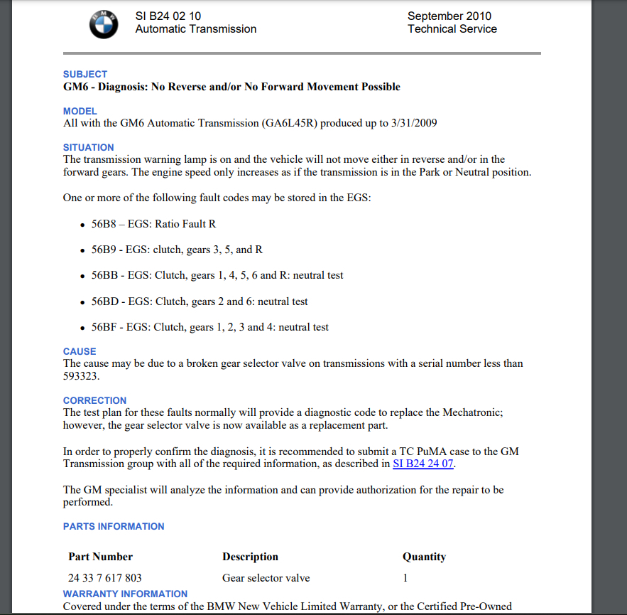

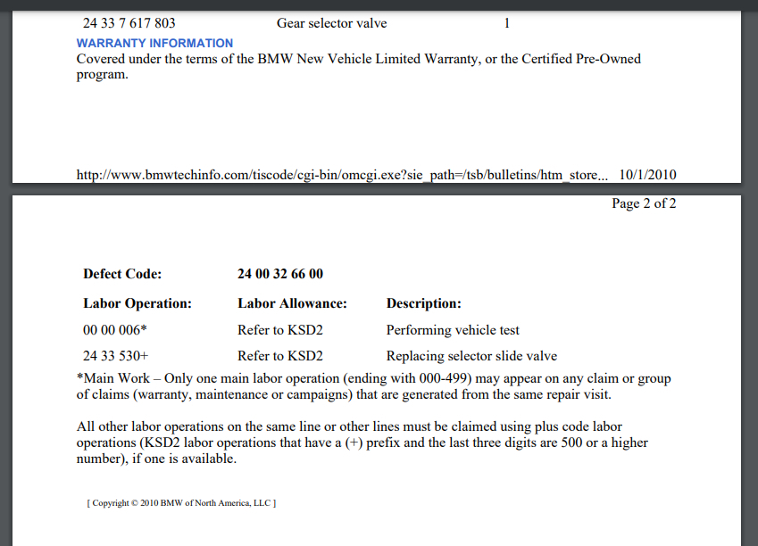

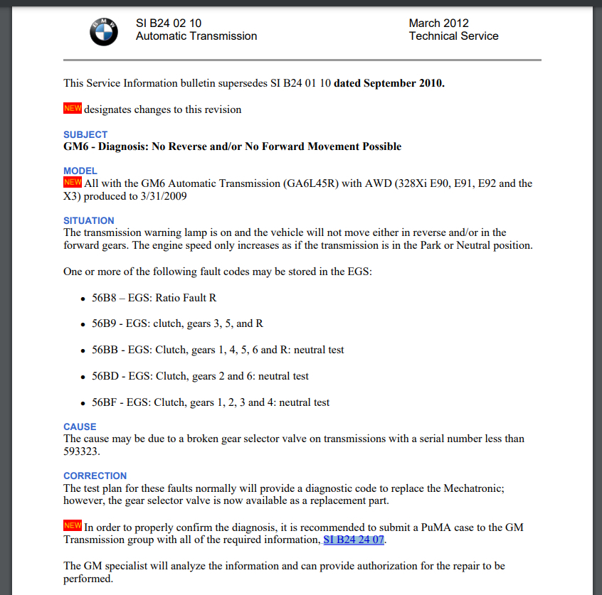

I suspect you saw the attached TSB which is why you inspected the selector valve.
However, the TSB has been updated in 2012 that still points to a selector valve, but it is saying that the dealer needs to submit a ticket to their help desk so that they can evaluate for a transmission replacement.
From what I can tell the dealers were finding the same thing that you did which is it has these codes, but the selector was not broken.
At which point it appears they are replacing the transmission.
This would match what you are seeing where the wheels don't move much.
The only alternative that I see is to rebuild the unit but unfortunately, they don't list any info on these codes that would point to a specific cause to look for when inside the unit. Which means I would think we will see the obvious issue once it is apart.
Based on this info and codes, this is the direction I would be going.

Good question. This was written for the dealership specifically as they have an online system to submit these. I do not know of a way for people outside the dealer to do this.
You may be able to call the BMW hotline and talk to them about this as they may have an internal process to help owners. However, they may tell you to just go to a dealer and have them submit it.
