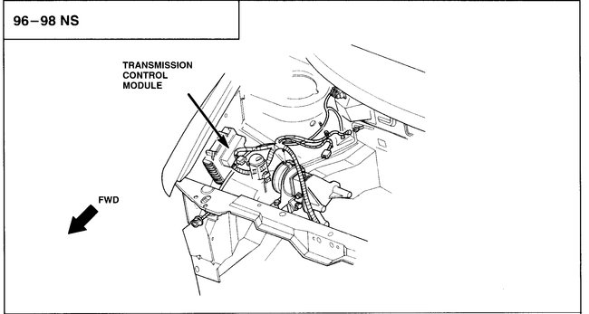

The PRND3L indicator lights all appear to work appropriately and vehicle will start in park and neutral only. But when I switch to "drive" and then come to halt and go back through gears the "N" no longer shows square around "N" and "D" often remains selected even though vehicle is in neutral. "R" lights up appropriately and reverse is selected. However "P" doesn't have the square until I switch the engine off and turn it back on. I do not have an OBD scanner. Any ideas?

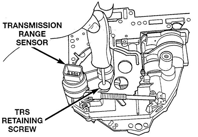

My first suspect is the transmission range sensor. That is what determine the gear you are in and what you see on the dash. However, you really should scan the computer with a live data scanner to determine if it is faulty. I realize you don't have one, but because of the work required to replace the sensor, it would be with having done.
If you decide you just want to try replacing the sensor, here are the directions. It isn't an easy job. You will have to remove the transmission pan and the valve body in the transmission to access the part.

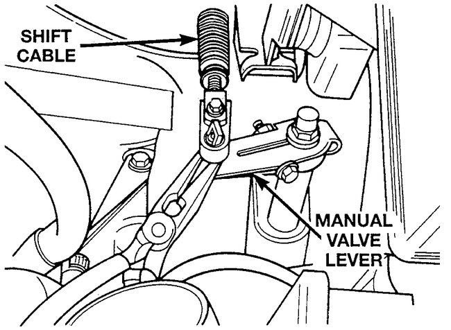

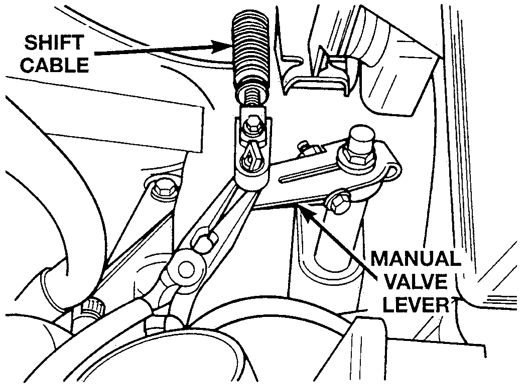

3. Remove gearshift cable.
4. Remove manual valve lever.

10. Extract park rod from guide bracket and remove valve body from transaxle.
See Picture 2

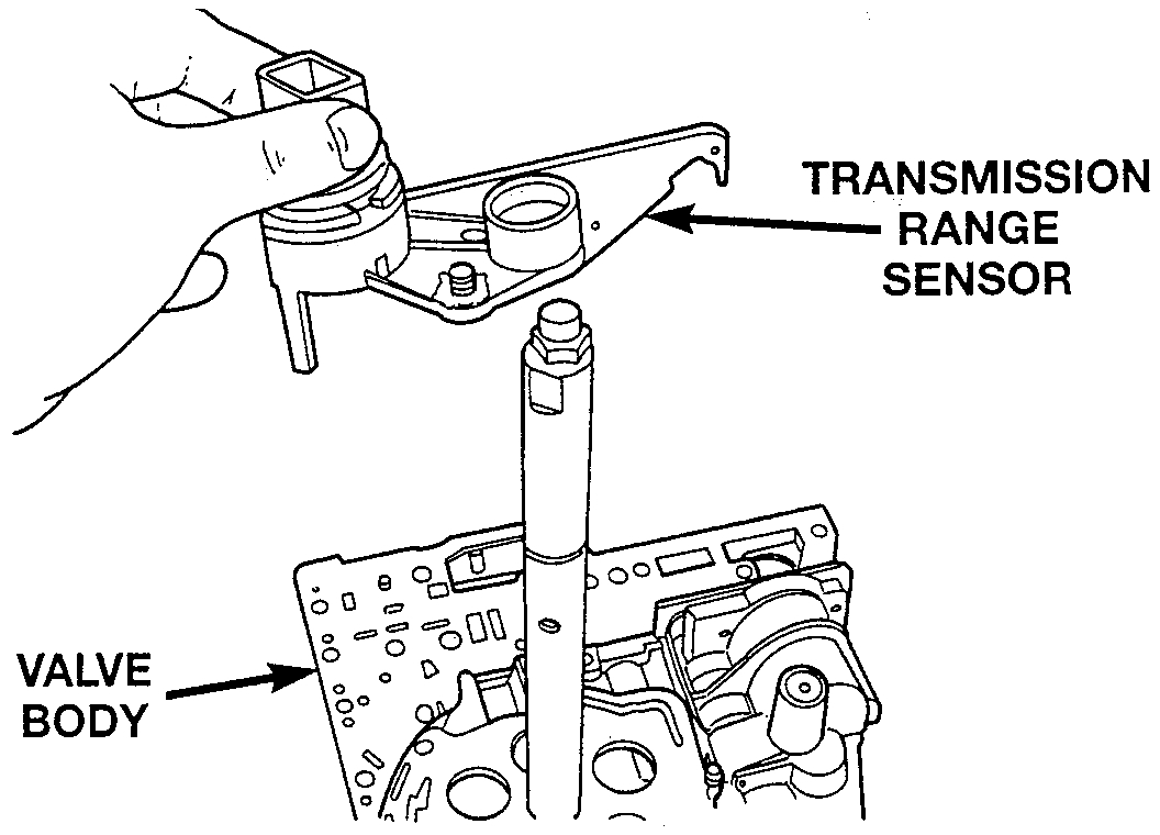

11. Place valve body on workbench.
See Picture 3

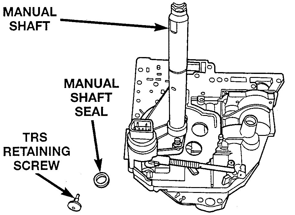

12. Remove TRS retaining screw.
See Picture 4
13. Remove manual shaft seal.

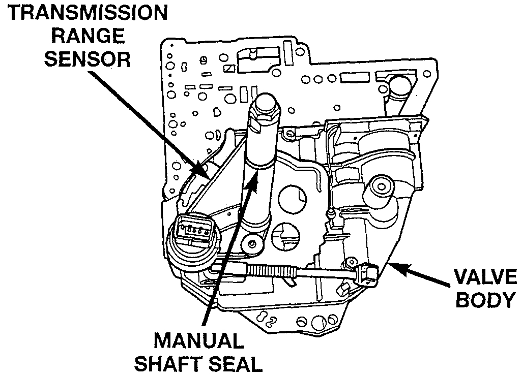

See Picture 5
14. Slide Transmission Range Sensor up the manual shaft and remove.

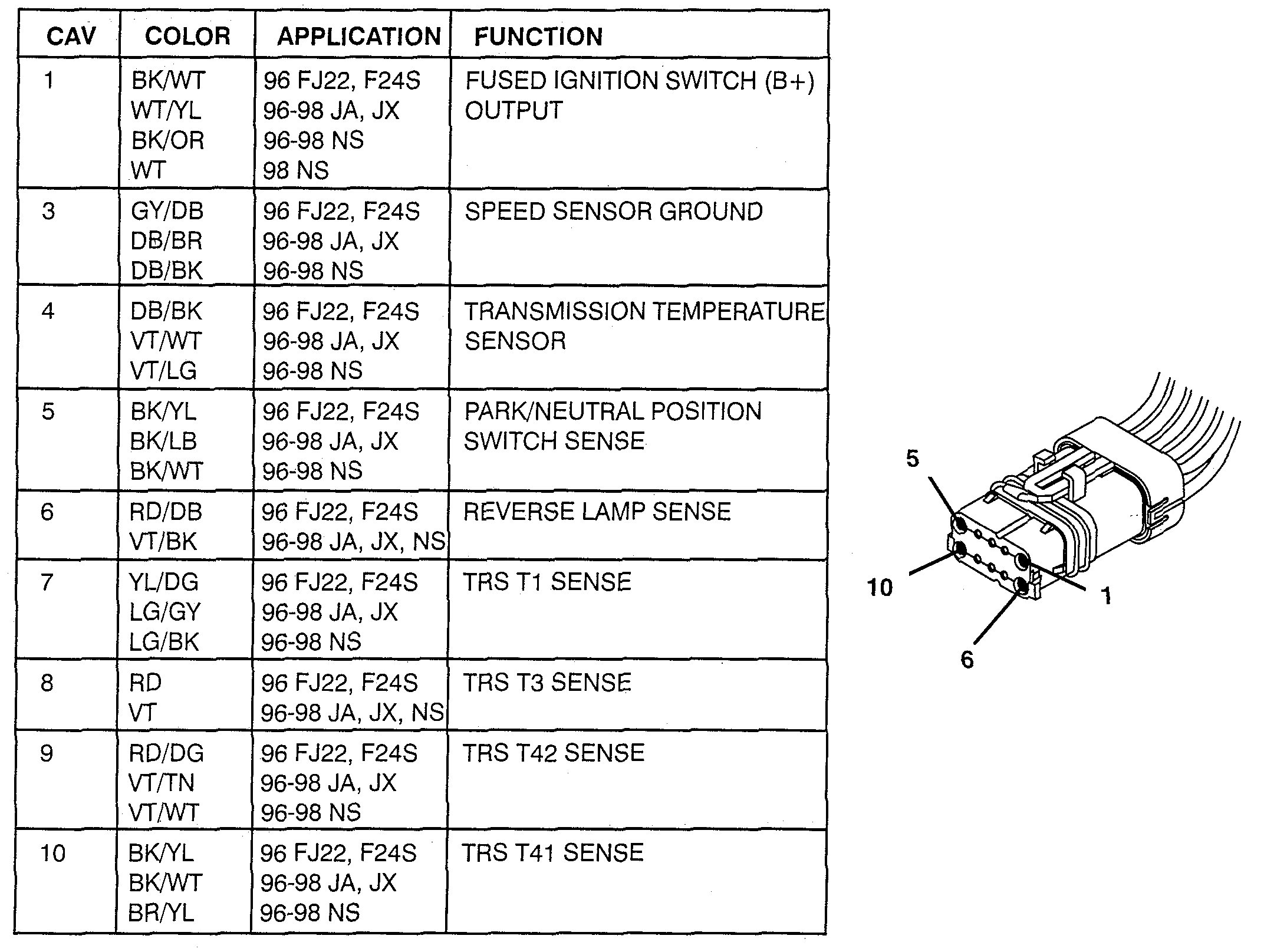

Thanks for the prompt response, I am here in Australia. so mechanics not overly familiar with vehicle. Took it to mechanic who used OBD readout, but it did not show any fault codes. Transmission appeared to be working as it should, just lack of light up on the "N" when shifting back from drive to reverse. "R" stays on when you go into park and park does not light up until you re-start. Is it possible that there is a problem with the contacts on the transmission range sensor? Any ideas and diagrams of this circuitry and how to replace? Regards, Rodj.
Mar 31, 2019 at 8:25 AM
  • 110,240 POSTS

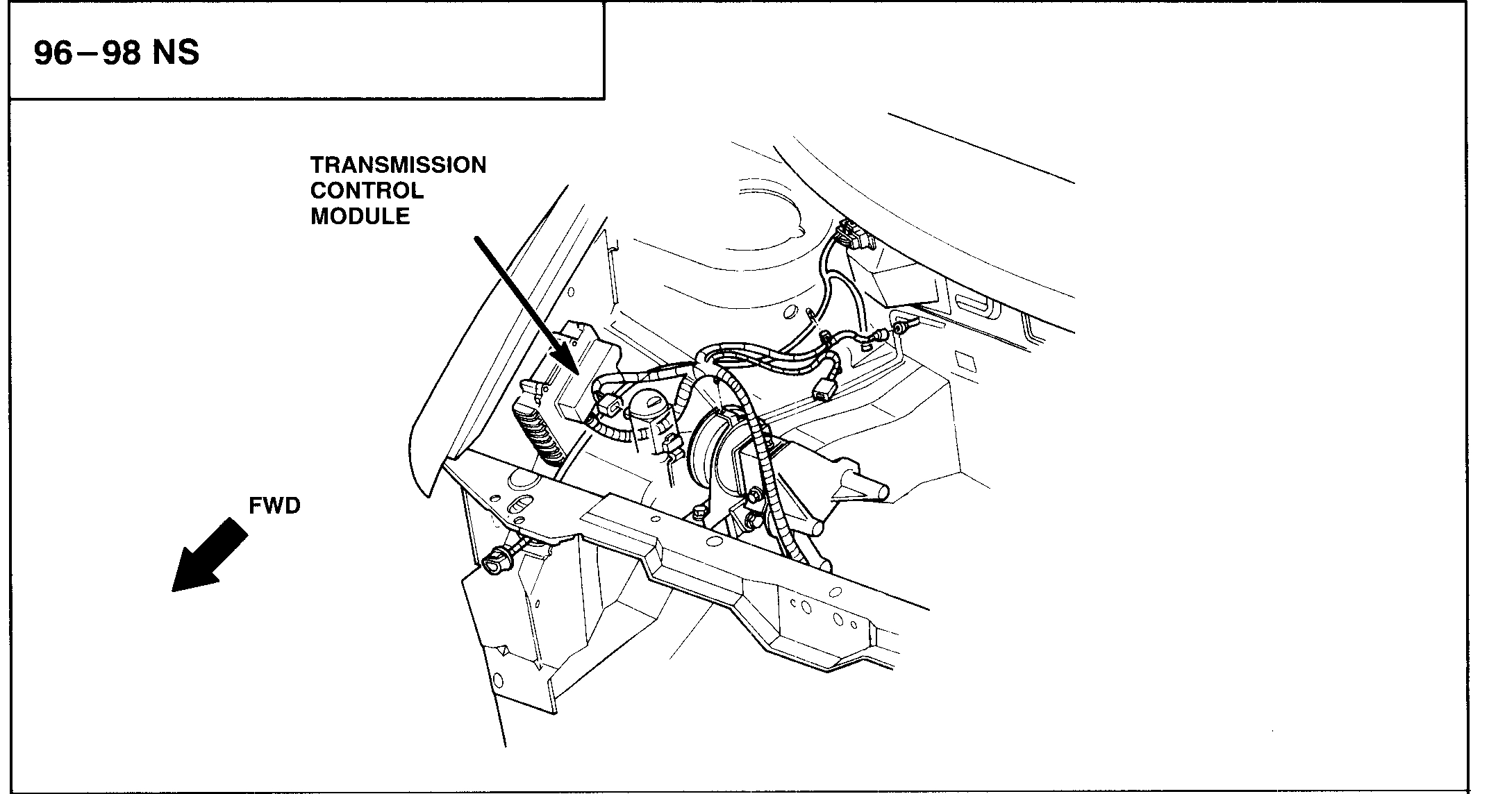

It's possible there is a weak connection. I attached a picture of the range sensor plug and what each pin does. Also, here are a few links you may find helpful if you want to check it:
Let me know if that helps. Also, if you decide you want schematics, let me know.
Mar 31, 2019 at 11:50 AM
RODJ
Thanks, you have been most helpful. Where do the wires on the other other end go to? is it another plug or multi connector? On a picture of a replacement plug it appears to end in a mass of pigtail connections?
Mar 31, 2019 at 5:00 PM
  • 110,240 POSTS
The other side will lead to the transmission control module. It is located under the hood on the passenger side inner fender. I attached a picture of its location.
Let me know if this helps.
Apr 1, 2019 at 9:57 AM
