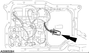

IF you determine the pressure is too high and the solenoid needs replaced, here are specific directions for your vehicle to remove the valve body (which is in the transmission under the transmission pan) from alldata. You will see wiring colors which are related to all electrical components. The pressure solenoid is listed.
Removal:

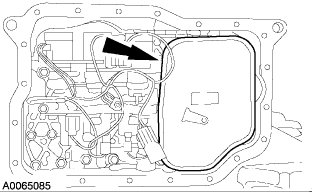

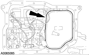

Remove the fluid pan.
Disconnect the transmission fluid temperature (TFT) sensor electrical connector.
Remove the fluid filter.

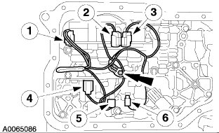

Note: It is necessary to note the location of the main control wire harness connectors so they can be connected in the same positions. Connector color letters are cast into the solenoid body.

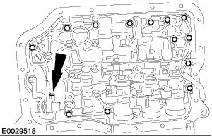

Remove the ground wire bolt. Disconnect the electrical connectors and remove the main control wiring harness.
Solenoid SSC; Color N (Neutral/White).
Solenoid SSE; Color G (Green).
Solenoid SSD; Color L (Blue).
Solenoid EPC; Color B (Black).
Solenoid SSA; Color N (Neutral).
Solenoid SSB; Color B (Black).

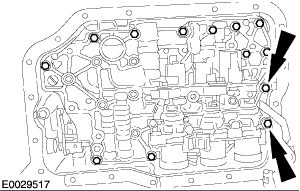

Note: Note the locations of the two long bolts.

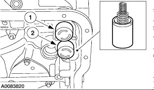

Remove the main control valve body and accumulators.
Note: Each accumulator is equipped with two springs. All four springs are different sizes.
Note: Note the size and location of the accumulator springs to aid assembly.
Note: Note the shape of each piston and the piston bore from which the piston was removed. The shape and size will very depending on application. The piston must be installed in its correct bore during assembly.
Remove the accumulator pistons and springs.

Note: The thin longer springs are for the neutral and drive accumulator.
Note: Accumulator bore and pistons are matched by depth; some pistons may have steps. Install the pistons in the same bore as removed.
Install the accumulator pistons and springs.
Accumulator 1 and 2.
Accumulator N and D.

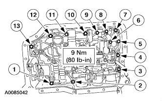

Note: Do not fully tighten the main control valve bolts at this stage.
Install the main control valve body.
Tighten the main control valve body retaining bolts.
Tighten the bolts in the sequence shown.

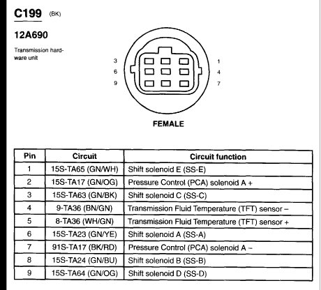

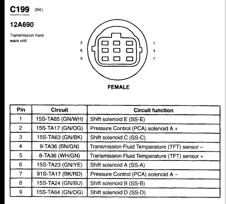

Note: It is necessary to connect the electrical connectors in the same positions as noted in disassembly. Connector color letters are cast into the solenoid body.
Install the main control valve wiring harness, connect the electrical connectors and install the ground wire bolt.
