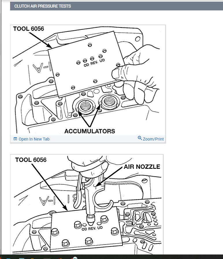

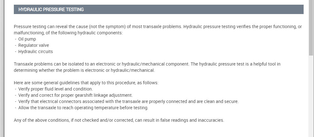

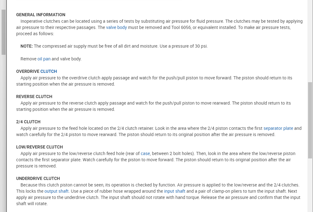

Next is the pressure in the unit is not correct or there is a leak as the pressure builds. So, we would need to check the pressure in the unit to find out if this is the issue. We need to check it when you are getting the slipping, but I suspect we have a leak in the system that is allowing the pressure to bleed off which releases the gear.
I am attaching the info below from the manual on this so please run through all this and let me know what you find, and we can go from there.
Thanks
