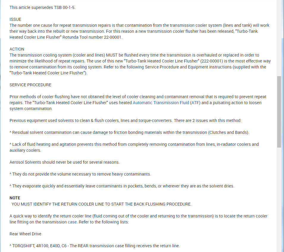

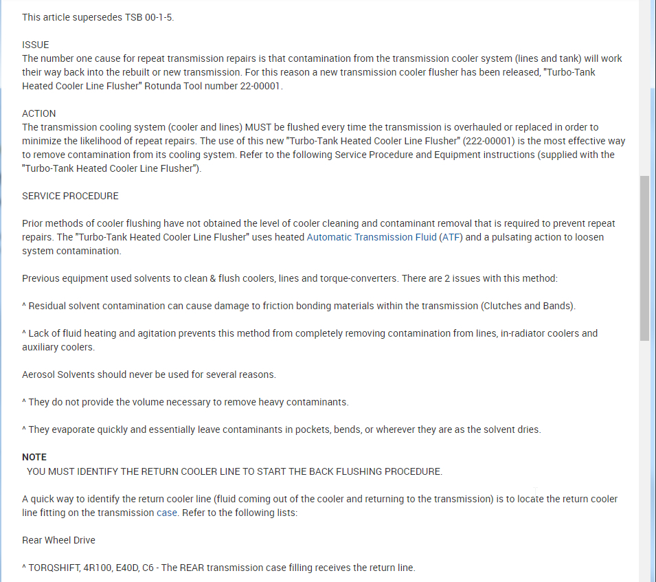

Flushing the unit is not the issue. That is just fine because all you are doing is exchanging the fluid. I think this whole "rumor" of "do not flush the transmission because it will then fail" got started because most don't understand what is actually happening when you do flush it.
Most all flush machines heat the fluid or require you to do this when the transmission is hot. That is so that the fluid is thinner and will flush out any contaminates with it. The problem is the transmission coolers trap all of these contaminates/metal in it and when you flush the transmission, it does not remove all the contaminates from the cooler. So when you then start driving the vehicle again, those release from the cooler and cause the transmission to fail.

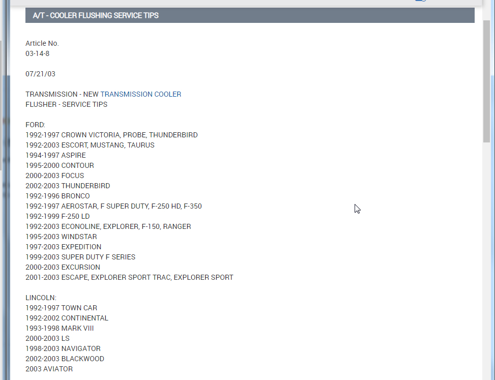

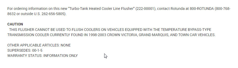

Ford addressed this on rebuilt transmission with the attached TSB but the same theory applies to just flushing the unit.
That brings me to what you should do. I would flush the transmission on a regular basis as it is more effective then just draining and filling. To do this just disconnect both lines from the cooler so that the cooler is not being flushed and use them to attach the machine.
As for using the DIY flush machines, they are just fine. I have even just put the return line in an empty bucket and the supply line in a full bucket and allowed the pump to pull in the new fluid. When the return line ran clean you shut the vehicle off. Clearly this takes some coordination as you don't want to suck air so one of those set ups would be best.

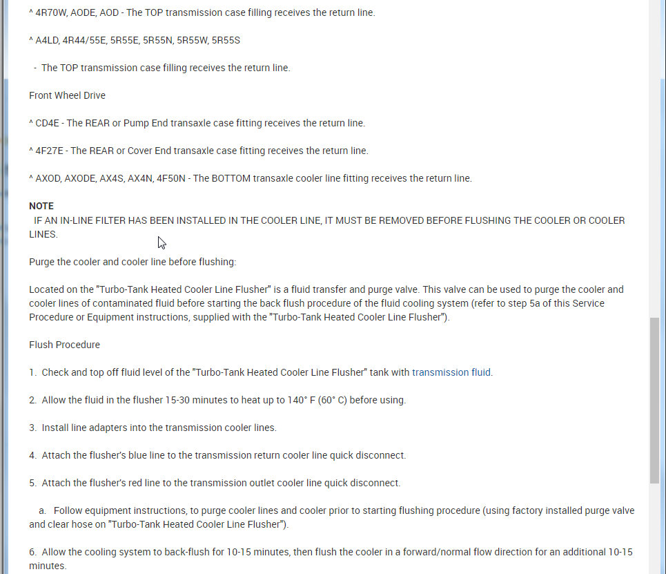

To identify the return line, I would take one of them off and put it in a bucket and start the engine for just a second and see if it shoots some fluid out. Normally the return line is on the passenger side but this manual does not tell us which it is.
If you are rebuilding the transmission I would replace the cooler. If you are not sure about the cooler, I would replace it and flush the unit before installing the new cooler.

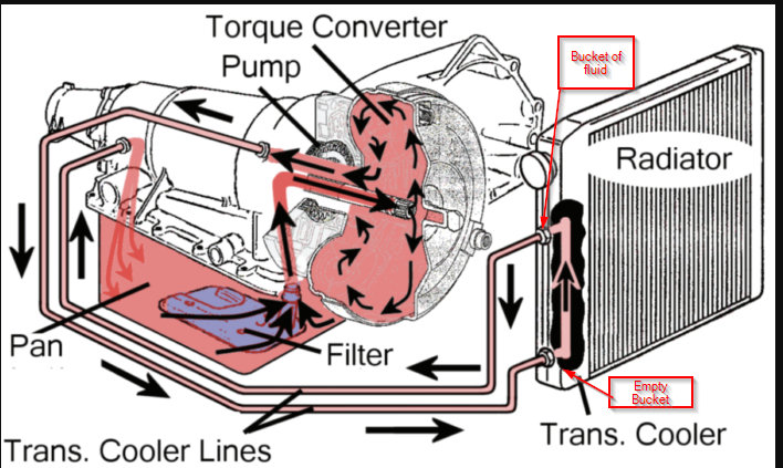

Just to be clear, you are taking the lines off the cooler? Put the line from the cooler that is returning fluid to the transmission in a bucket of clean fluid. This way the pan is being filled with clean fluid. Then the line that is supplying fluid to the cooler in an empty bucket.
I have not had a transmission get an air lock but in theory it is possible if the pump is not strong enough to pull the fluid out of the bucket. Most all return lines are in the pan so they will be submerged which creates the suction to pull the new fluid out of the bucket. If this is not working then this is what they are talking about doing one quart at a time. Basically you have to fill the pan using the dipstick tube. So you are putting in what comes out. If you do it this way, you only need to remove the line coming from the transmission to the cooler. Hope this make sense.

You diagram is an outstanding portrayal of the procedure. Thanks. And yes, that was what I ended up doing (return line that was coming out of the cooler going to the transmission pan is now deeply submerged in a container lifted up to the level of the cooler and filled with 4 quarts of fresh transmission fluid and carrying it out to the transmission). However, the line coming out of the transmission into the cooler I did not disconnect. Instead, I let the old warm transmission fluid flow through the cooler and then flow out into a hose I connected to the other end of the cooler and into an empty container (the idea was to flush the cooler on the way out).
That return hose I also had to extend to reach the container but it developed a pich (bending) in it when I looked at it later, so I am not sure if it collapsed at the very beginning. The other possibility (more likely in my case, and I have to say I got lucky that I did not keep it running for more than 1/2 quart at a time) would be exactly what you said 'an air lock or barrier' an empty space in the pan which would've prevented suctioning: meaning my sister must have been driving the car (before she gave it to me to work on it) with 4 quarts of fluid not 6.3. So, the pan was emptying very quickly and there was no way for me to measure the total amount. In fact, I ended up adding two and a half quarts of fluid after the procedure was done. I took it out after the flushing for a test drive and the car was driving with very good shifting. It isn't slipping intermittently she said afterwards. That's what made me think that she didn't have enough fluid and the TCC was acting up on her. Now, it is working great. Thanks for your help. Thanks for the excellent advice I got from you.
