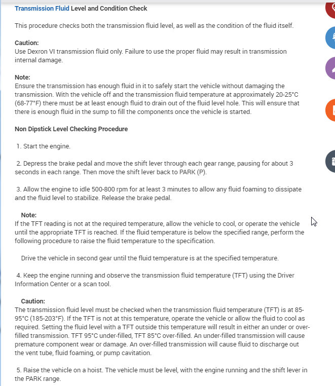

I went and got a flush, oil change and spark plugs replaced. When I was driving it home after picking it up. It had delayed shifting. Most of it smoothed out but there is a delay in second gear. There no smell no noise and no grinding just a quick 2 second delay and a jerk. Will this smooth out.

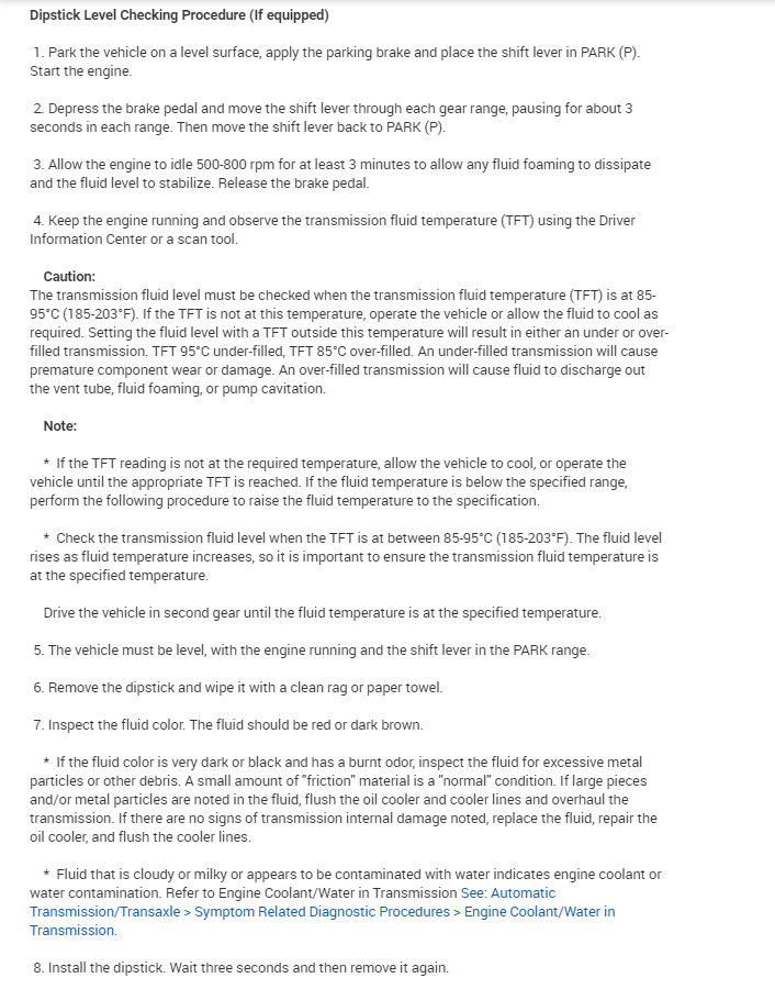

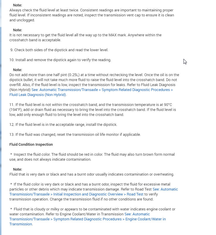

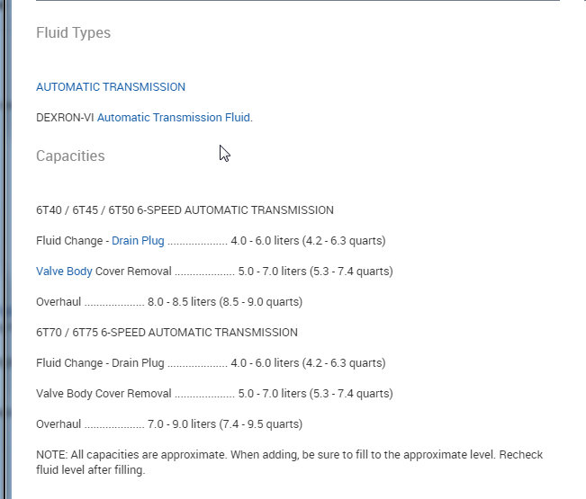

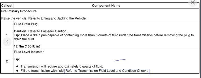

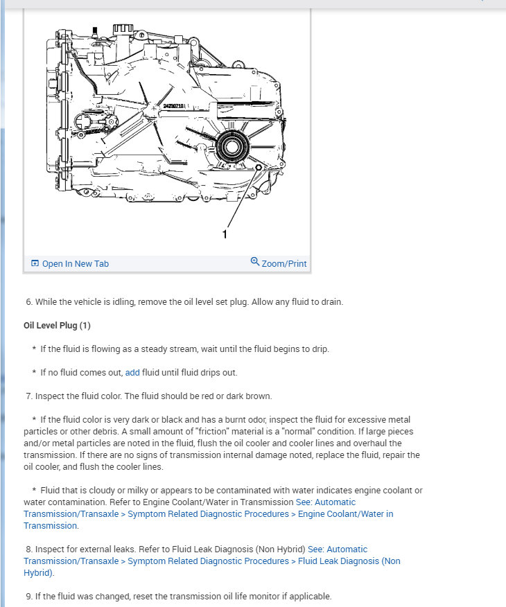

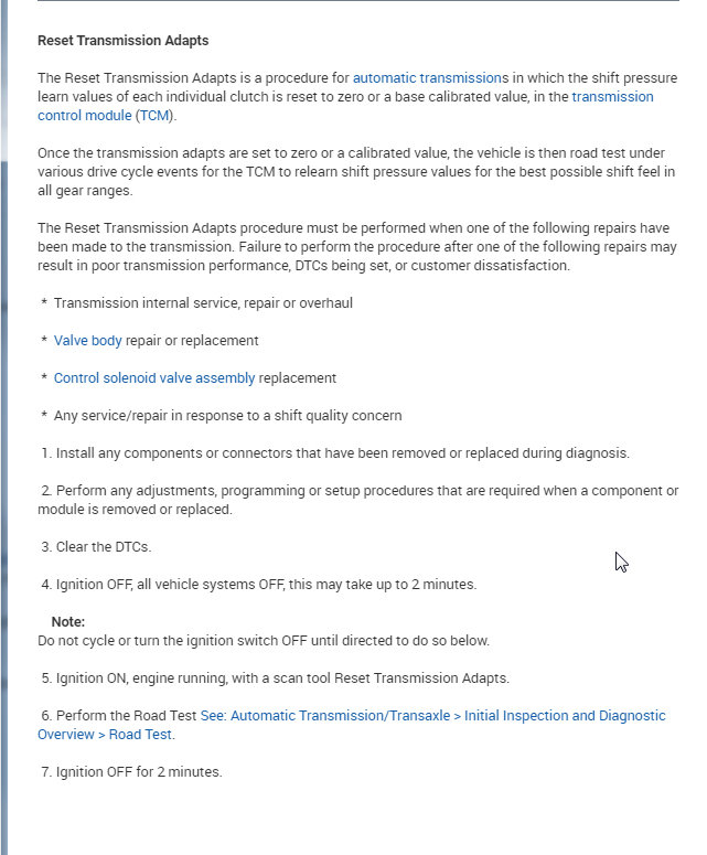

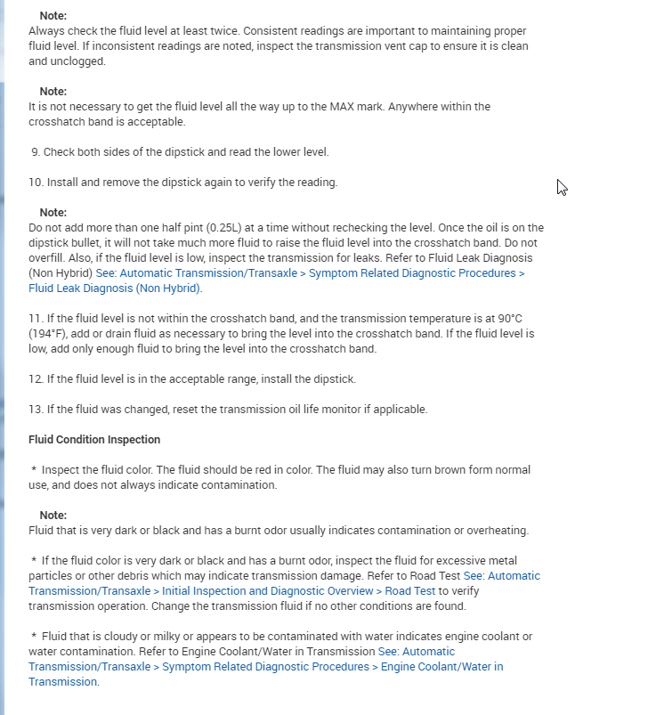

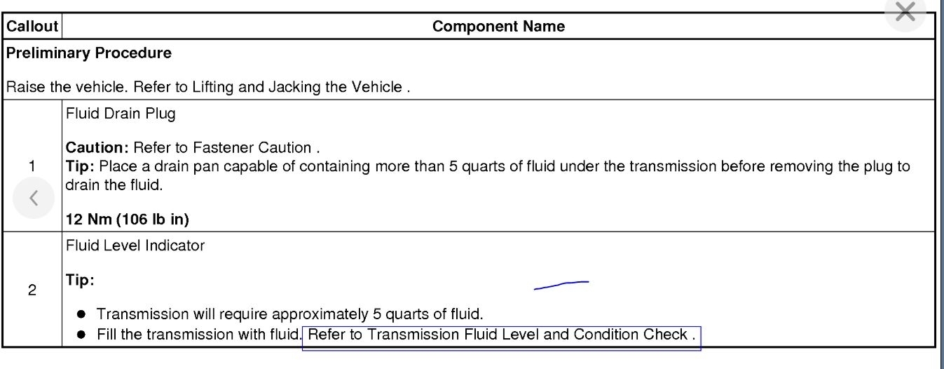

It depends on how harsh this is and if they performed a relearn of the transmission adaptives. This means if they reset the learned shift pattern.
The main cause of this after a service is the fluid is low. I attached the procedure to check the fluid. I would start with that and then ask if they reset the adaptives.
Keep us posted on what they say and if the fluid is low and we can go from there. Thanks

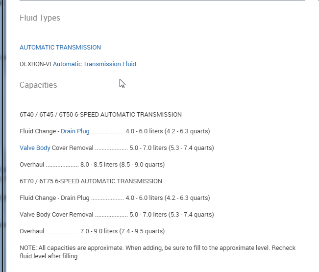

Good afternoon,
A flush was a bad idea. The additive for flushing does not react well with the clutches and could damage them.
Just changing the fluid and filter is enough.
