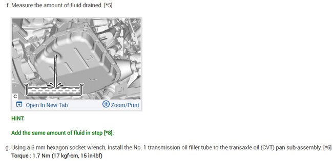

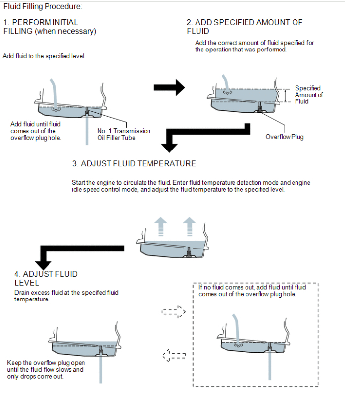

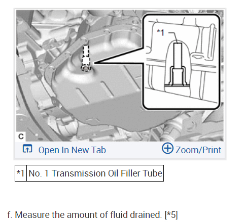

I bought new in 2017. should i change gear oil/transmission fluid.
May 5, 2024 at 5:10 PM
  • 55,447 POSTS

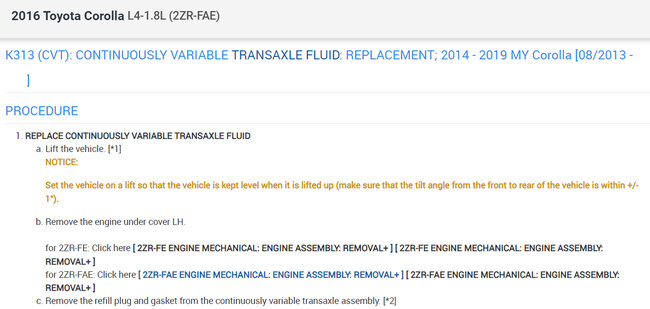

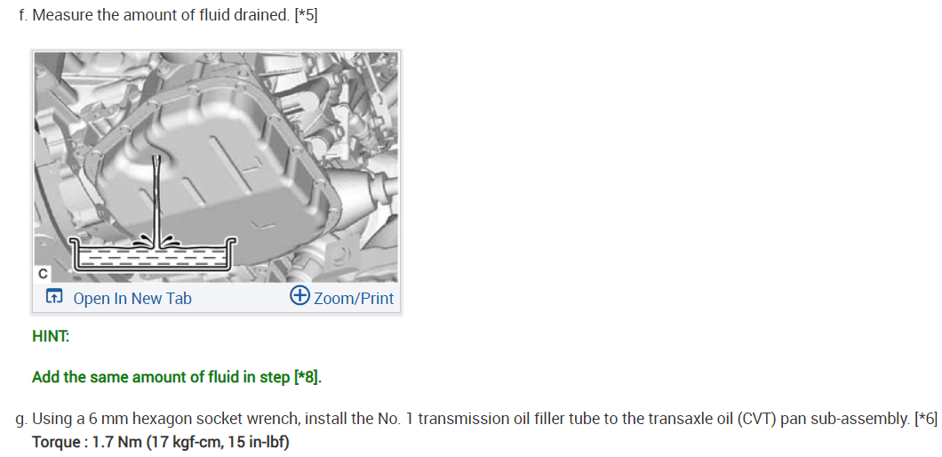

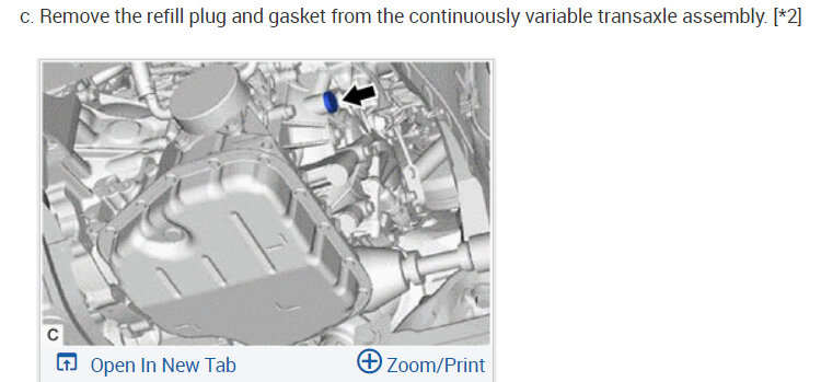

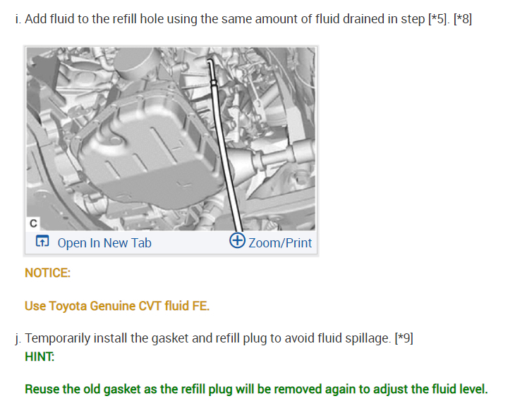

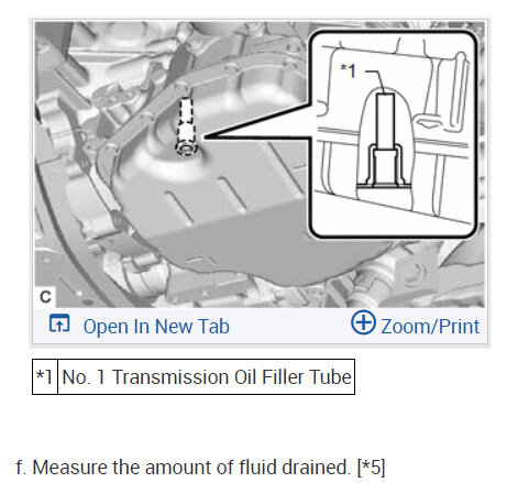

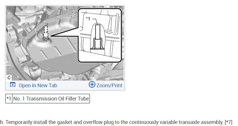

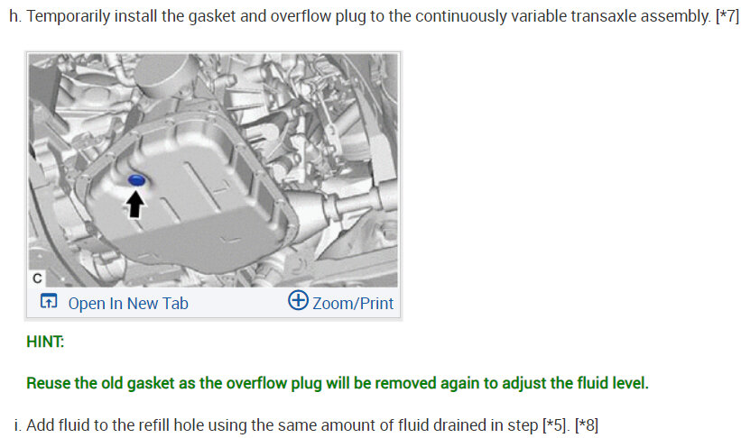

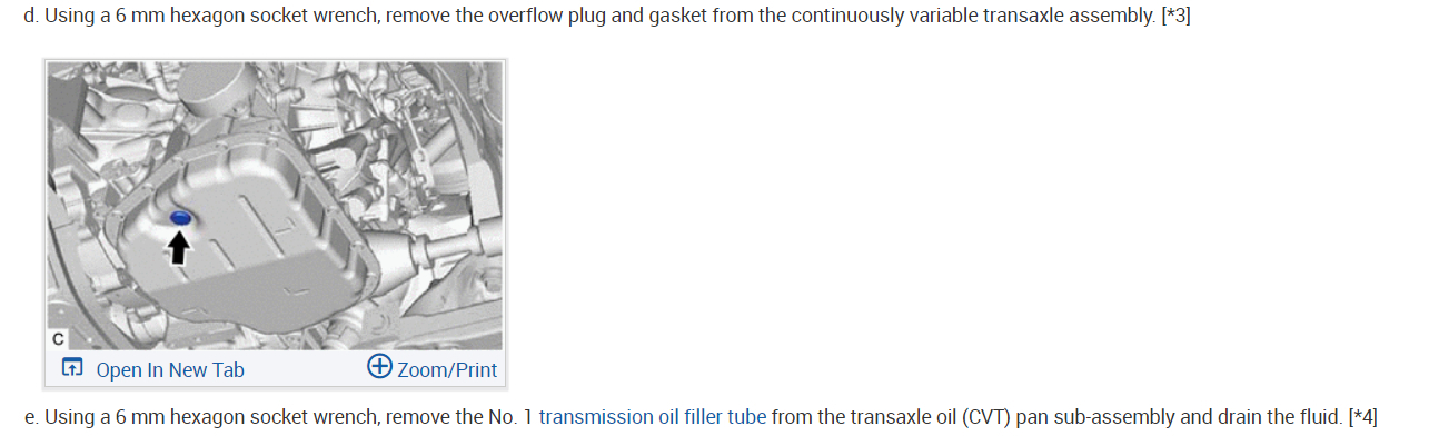

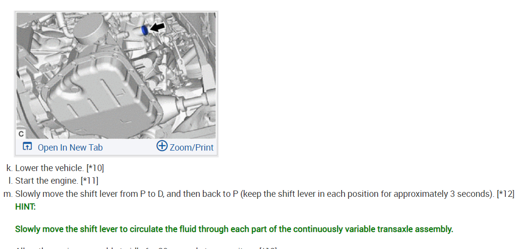

Not at 49,000, I would service the transmission when it gets to 60,000. Here is a generic guide to help you step by step with instructions in the diagrams below to show you how on your car:
Check out the images (below). Let us know if you need anything else.
May 6, 2024 at 1:18 PM
  • 110,244 POSTS
It is never a bad idea to service the transmission. On this vehicle, you have a CVT unit. According to the manufacturer, it doesn't need to be serviced. I check all the way to 150,000 miles and every time the manual indicates to inspect and fill as needed.
Since this is a CVT transmission, do not add traditional automatic fluid to it. It does require a specific type of fluid designed specifically for this design. Make sure to use Toyota Genuine CVT fluid FE or equivalent.
