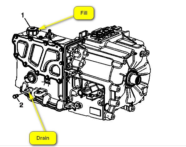

How can I change the transmission fluid in my vehicle listed above?
How many liters are needed?

Your vehicle is equipped with the 1ET35 transmission.
The transmission oil change is due at 97,000 miles.
To carry out transmission oil change you will require a suitable scan tool to operate the transmission oil pump to be able to check the oil level after refill.
Total fill capacity is 4.4 quarts, approximamtely 4.2liters.

TRANSMISSION FLUID DRAIN AND FILL
Remove the front compartment air deflector.
Place a suitable drain pan under the transmission fluid pan.
Remove the transmission fluid pan from the transmission to drain the transmission fluid.
NOTE:
Replace the fluid pan gasket with a new gasket every time the transmission fluid pan is removed.
Position a new transmission fluid pan gasket to the pan, then install the transmission fluid pan and gasket to the transmission.
Image 1: Transmission Fluid Fill Cap Assembly And A/Trans Case Hole Plug
Using a commercially available hand pump, add transmission fluid through the case fill hole (2)
CAUTION:
Check the transmission fluid level immediately after adding fluid and before vehicle operation. Do not overfill the transmission. An overfilled transmission may result in foaming or fluid to be expelled out the vent tube when the vehicle is operated. Overfilling will result in possible damage to the transmission.
Check the transmission fluid level. Refer to Transmission Fluid Level and Condition Check. see article lower down
NOTE:
Continue to monitor the transmission fluid temperature, if the fluid temperature falls below the specified range. Operate the vehicle again, until the transmission fluid temperature is reached.
Operate the vehicle until transmission fluid temperature is 86-122°F (30-50°C).
NOTE:
The auxiliary transmission fluid pump must be running when the transmission oil level check plug is removed or excessive fluid loss will occur, resulting in an under-filled condition.
NOTE:
When the oil level check plug is removed with the auxiliary fluid pump OFF, excessive loss of transmission fluid will occur.
Using the scan tool, command the auxiliary transmission fluid pump speed to ON for 10 minutes and keep it running throughout the process.
Remove the transmission oil level check plug (2) and verify a light drip of fluid comes out.
CAUTION:
Refer to Fastener Caution .
Install the transmission oil level check plug (2) and tighten to 12Nm (106 lb in).
Using the scan tool, command the auxiliary transmission fluid pump speed to OFF.
Install the front compartment air deflector.

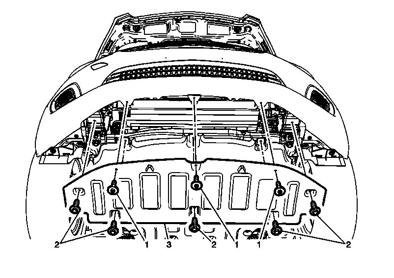

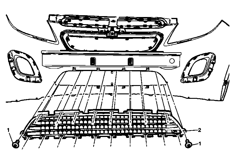

How can I remove the front compartment air deflector? In a proper way.

Front Compartment Air Deflector Replacement.
Preliminary Procedure:
Remove the Front Bumper Fascia Opening Lower Cover. See images below.
1 Front Compartment Air Deflector Bolts (Qty: 5)
CAUTION:
Refer to Fastener Caution.
Tighten
22 Nm (16 lb ft)
2 Front Compartment Air Deflector Plastic Retainers (Qty: 3)
3 Front Compartment Air Deflector Nuts (Qty: 2)
Tighten
4 Nm (35 lb in)
4 Front Compartment Air Deflector
