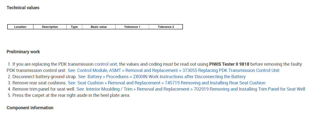

Hi, I'm facing transmission problem in my car which has just driven 6,000 km and I have used sports exhaust. Now it is out of warranty and they're asking to replace the transmission before that I have changed the control unit but still the malfunction is coming.

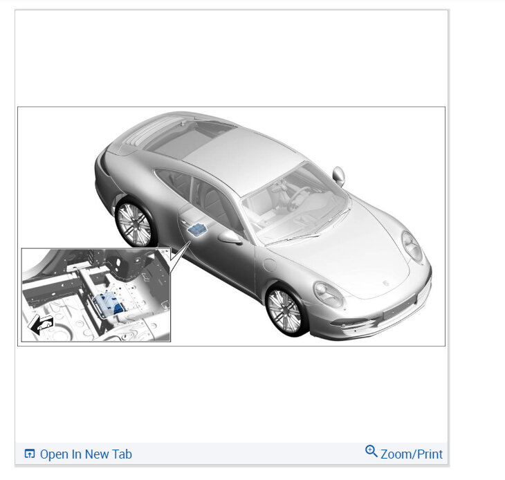

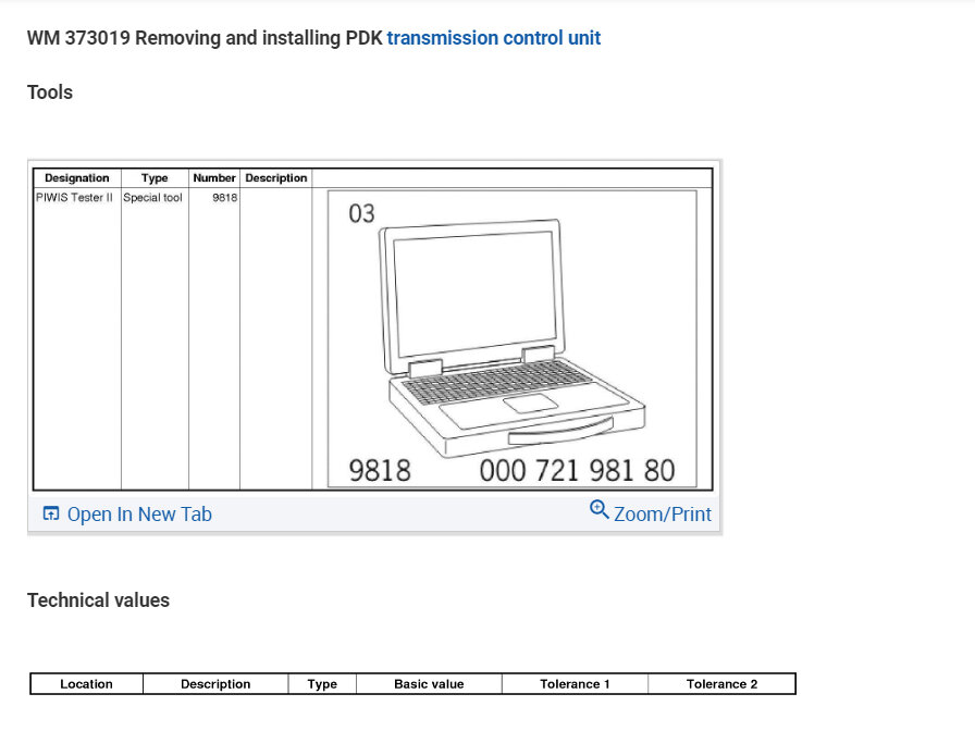

We need to scan the car for trouble codes before we can help you fix the car. I would use a CAN scanner which are not that expensive on Amazon, here is one for $199.00:
https://amzn.to/3Hbv37O

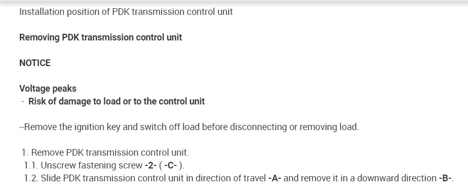

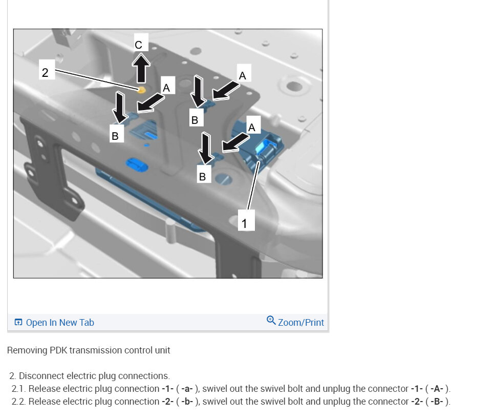

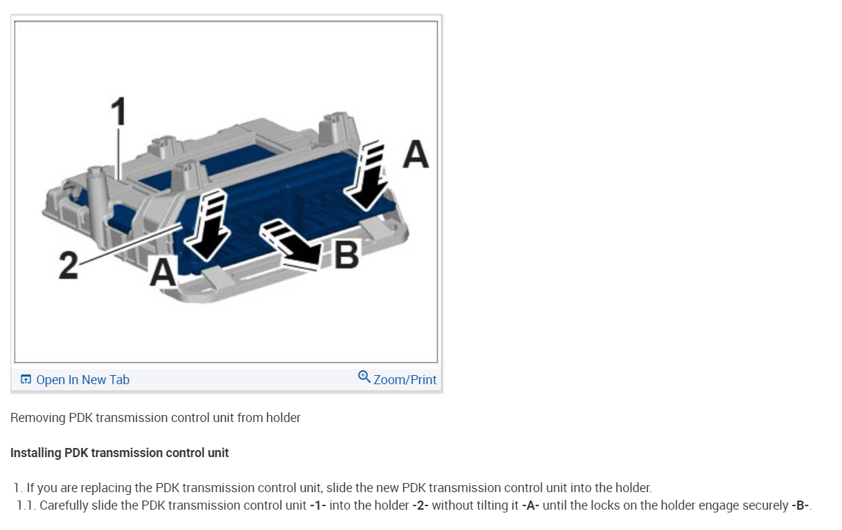

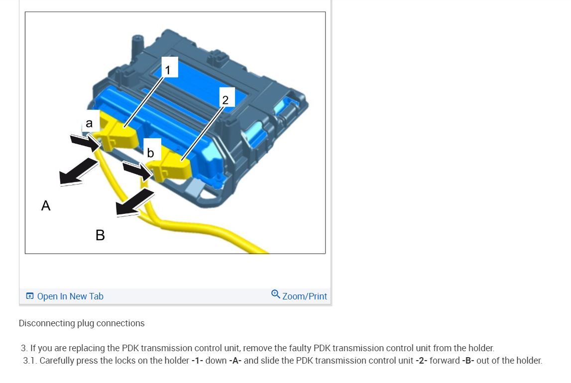

Is the transmission acting normal? Also is this an automatic or manual transmission car. The PDK sits low in this car and can get wet which will cause problems, the connectors or not watertight. Here is the location of the controller so you can check it out. Disconnect the battery before checking. Check out the images (below). Let us know what happens and please upload pictures or videos of the problem.
