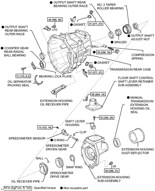

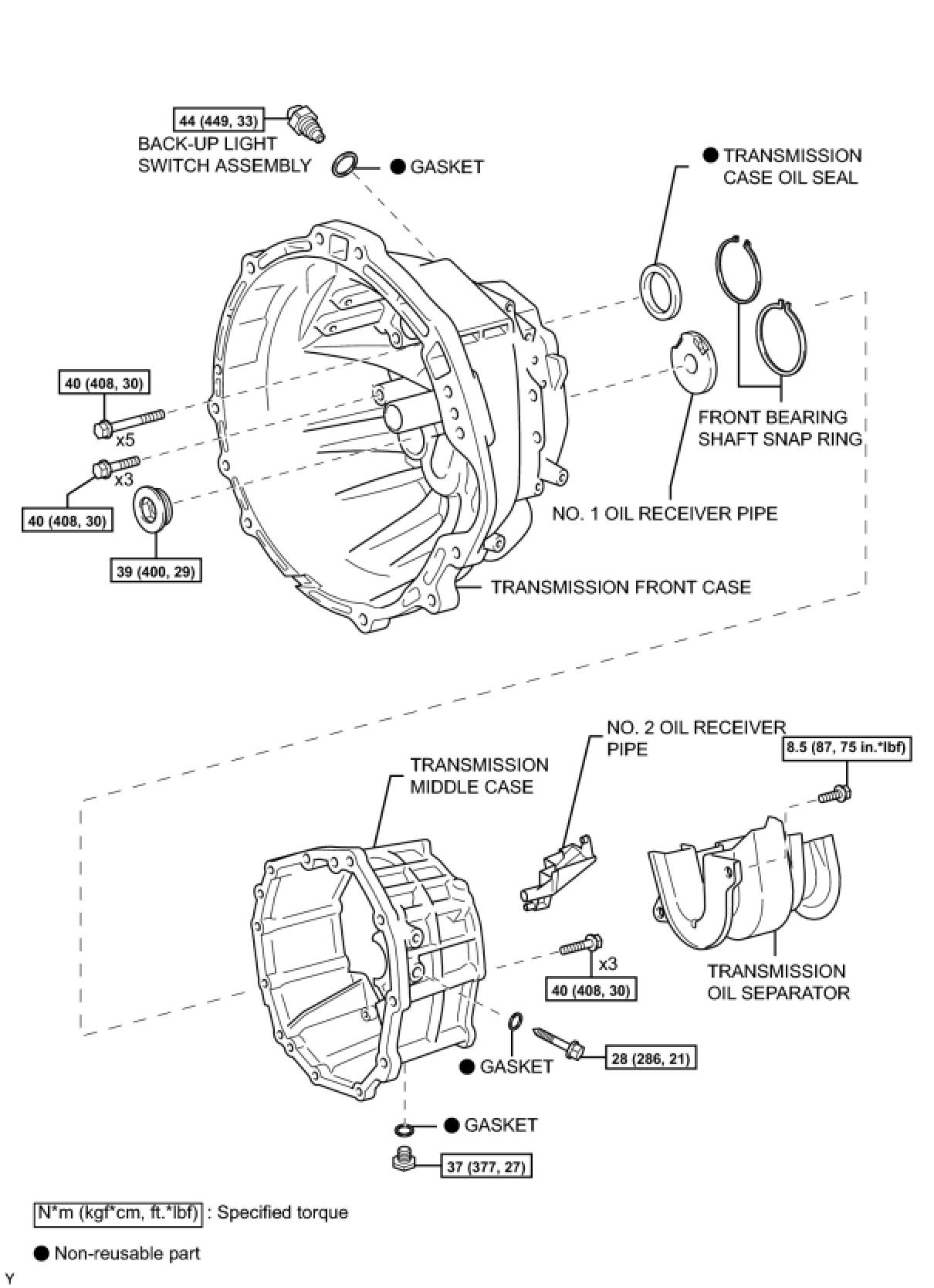

I have a Prerunner SR5, transmission type is a750e. my wife and I are trying to rebuild transmission and I need to know how to put it back together and I need a layout part by part on how it goes back together and where the seals go? so if someone can help me with a diagram a greatly appreciate.
Sep 15, 2017 at 8:14 AM
STEVE W.
  • 15,322 POSTS
To make it a lot easier, I would suggest you get a one year single vehicle subscription to AlldataDIY www.alldatadiy.com for about thirty dollars and if it does not show the items you need they will refund the purchase within the first ten days.
Or check with your local Library, many have access to Alldata, Chiltons or Mitchell. Then you can print out all the pages and instructions to go with that transmission.

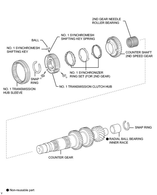

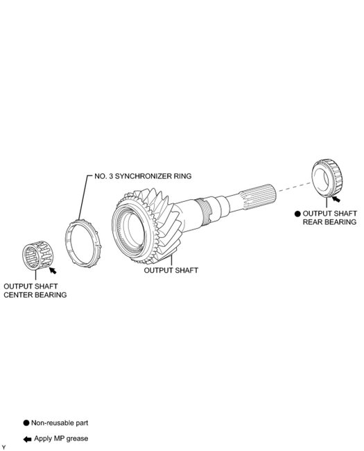

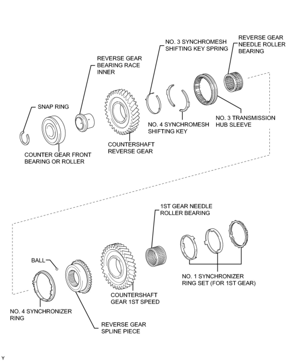

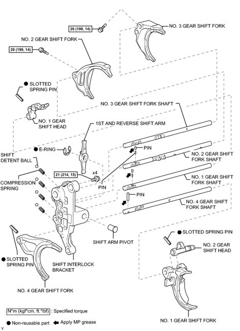

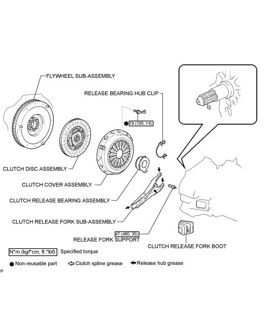

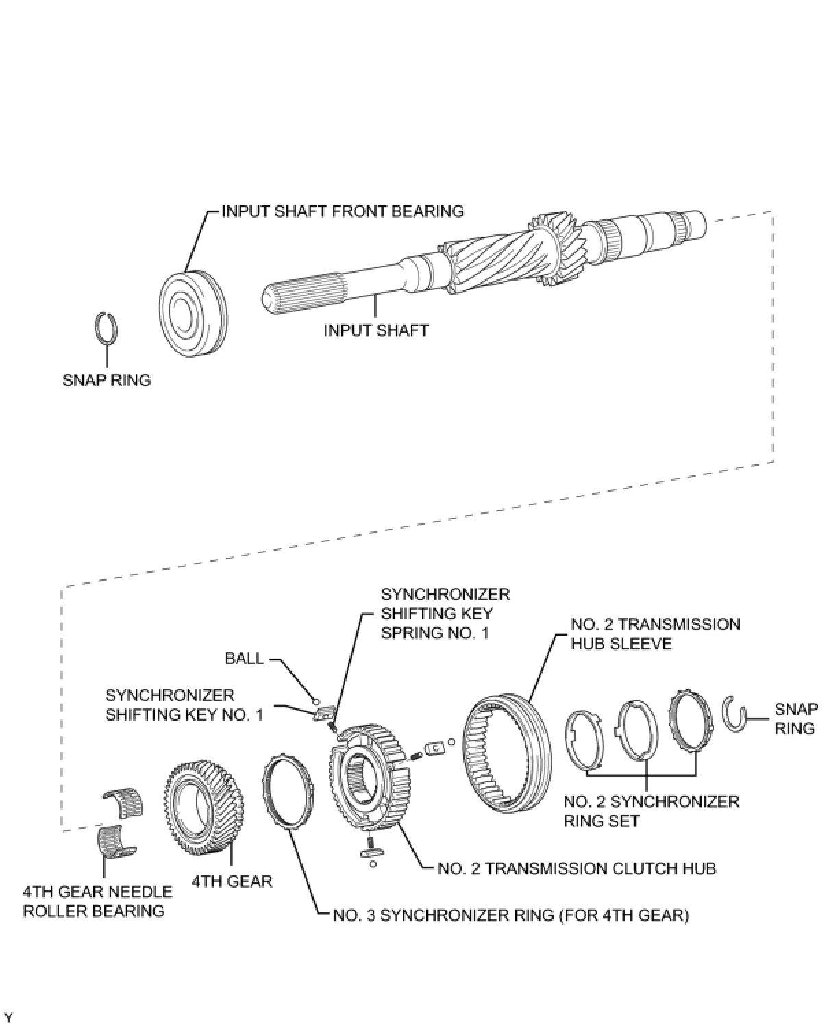

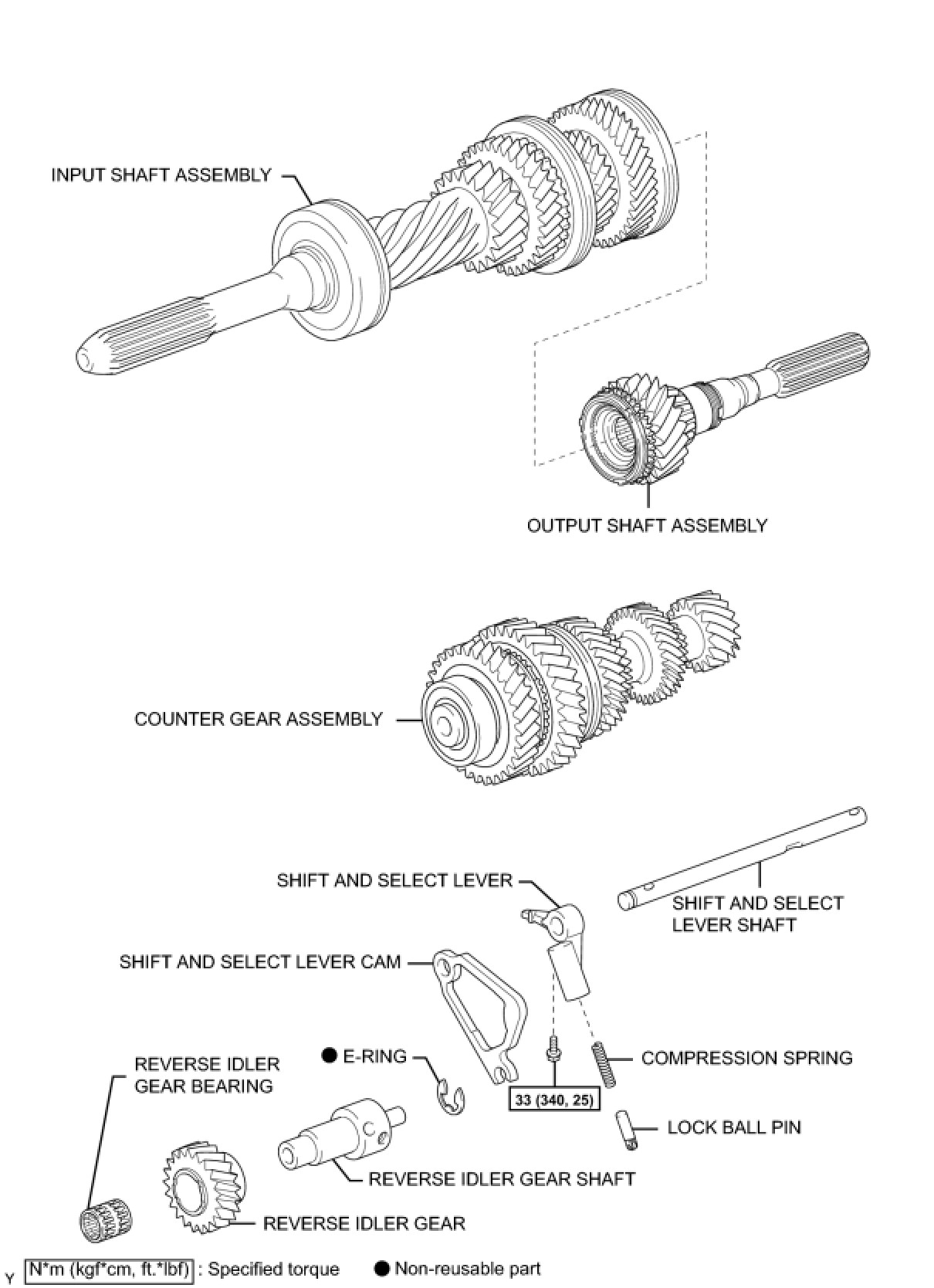

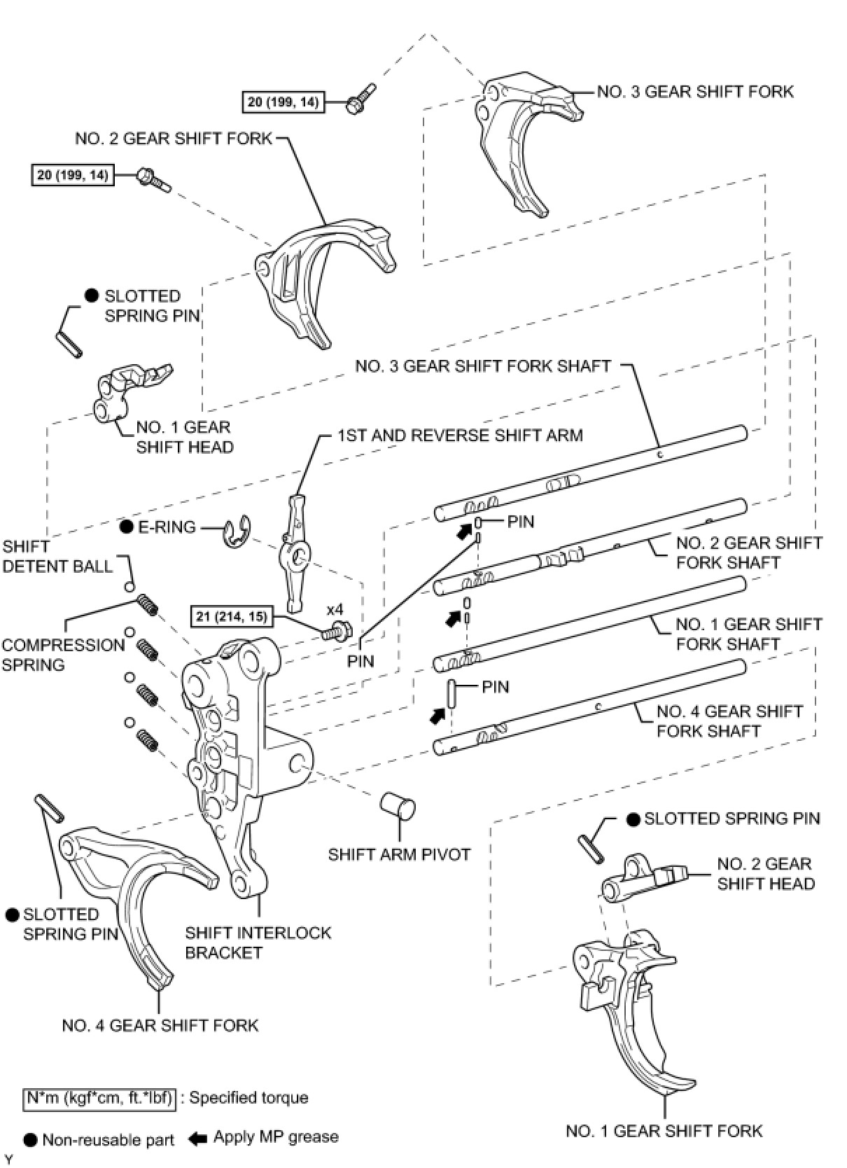

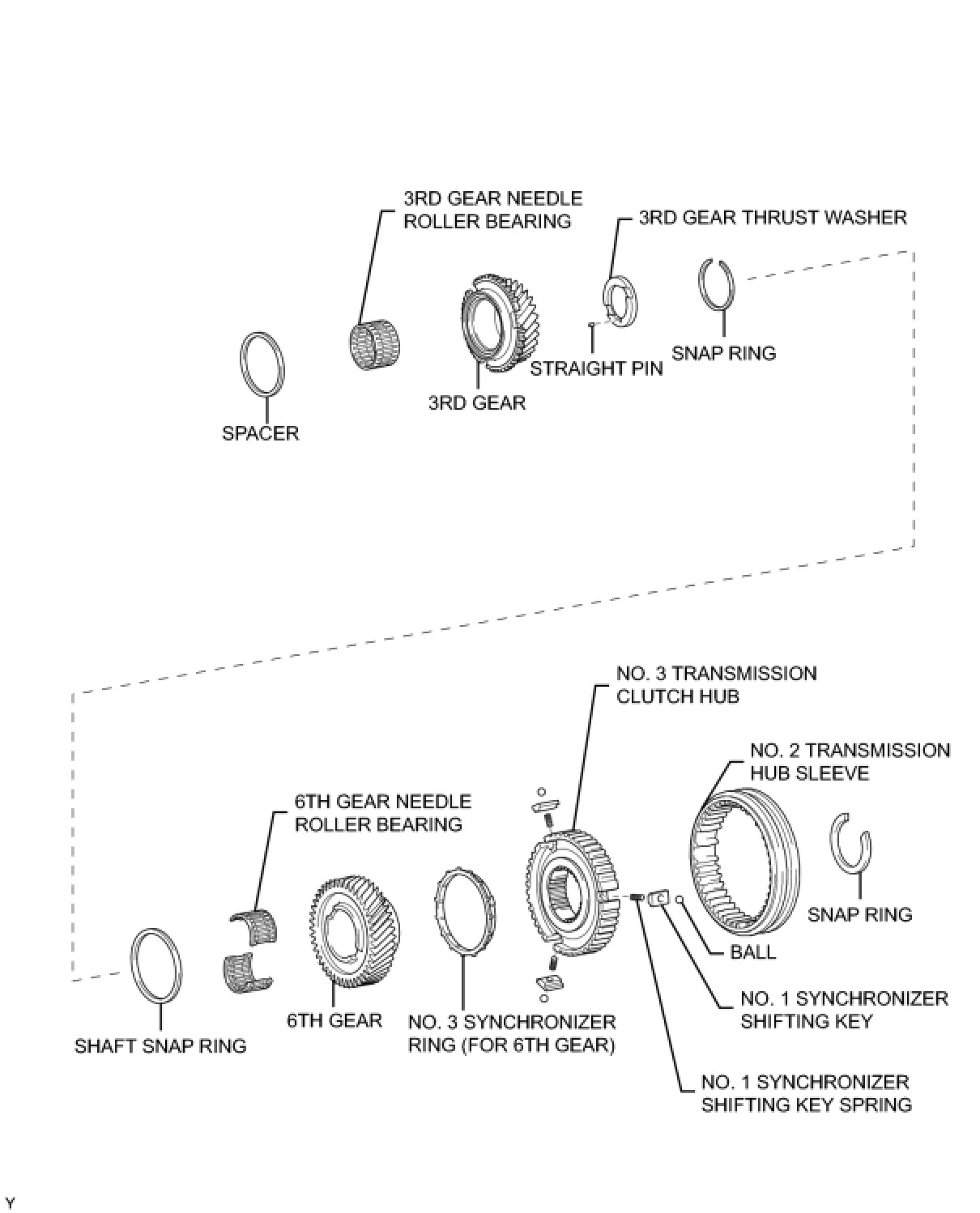

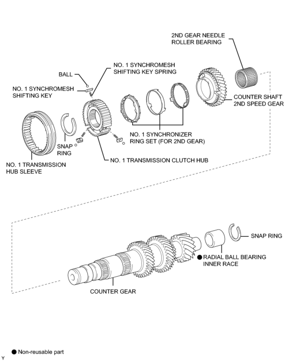

Below are some of the diagrams, but they do not show the individual clearances and how to install some parts.

The subscription should show all of what you want. It is the same place I got the images from. I just have access to all the vehicles they cover while the one you would get only covers your one vehicle.
