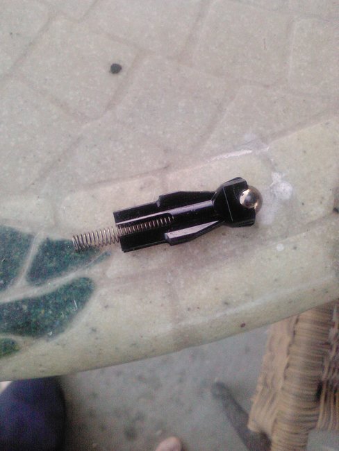

This is the part that fell out with the arm:

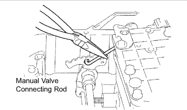

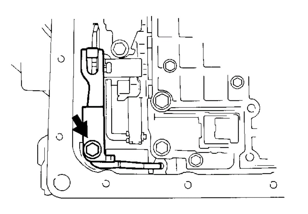

You indicated "...removing the internal I had the arm." Can you explain? As far as the part, it looks like part of the detent spring/ball. That ball rides on a lever that is grooved. See picture 1 and let me know if that is where it came from. Also, picture 2 shows a different view.
Let me know. Also, where did the three springs come from? Do you have pictures of them?

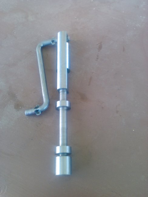

The arm that came out.

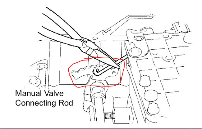

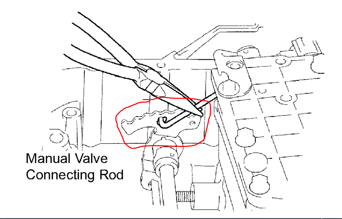

That looks like the manual valve / lever. See the attached pic and let me know if it helps.
