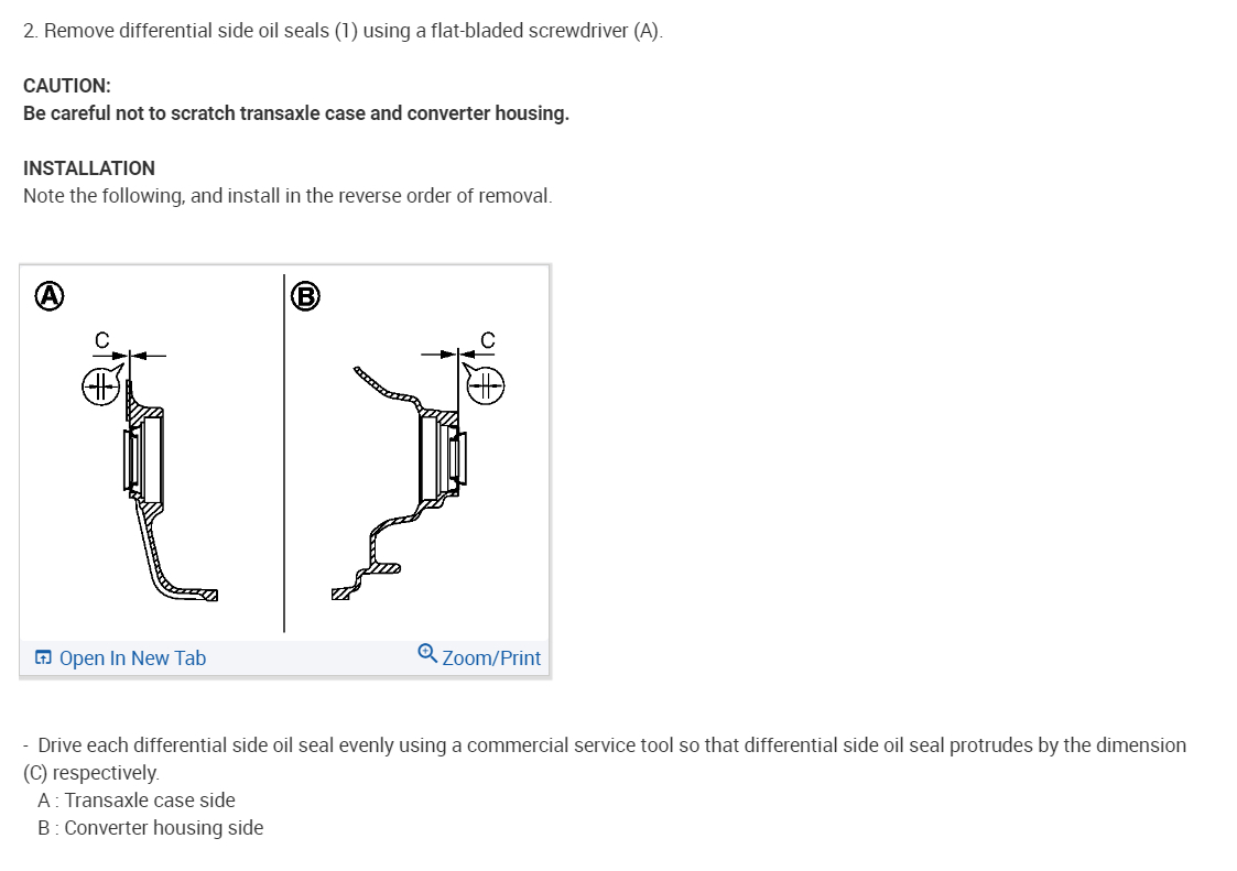

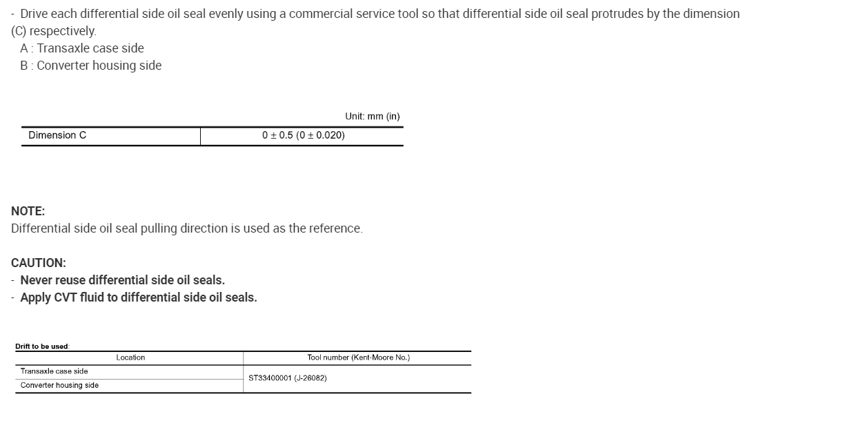

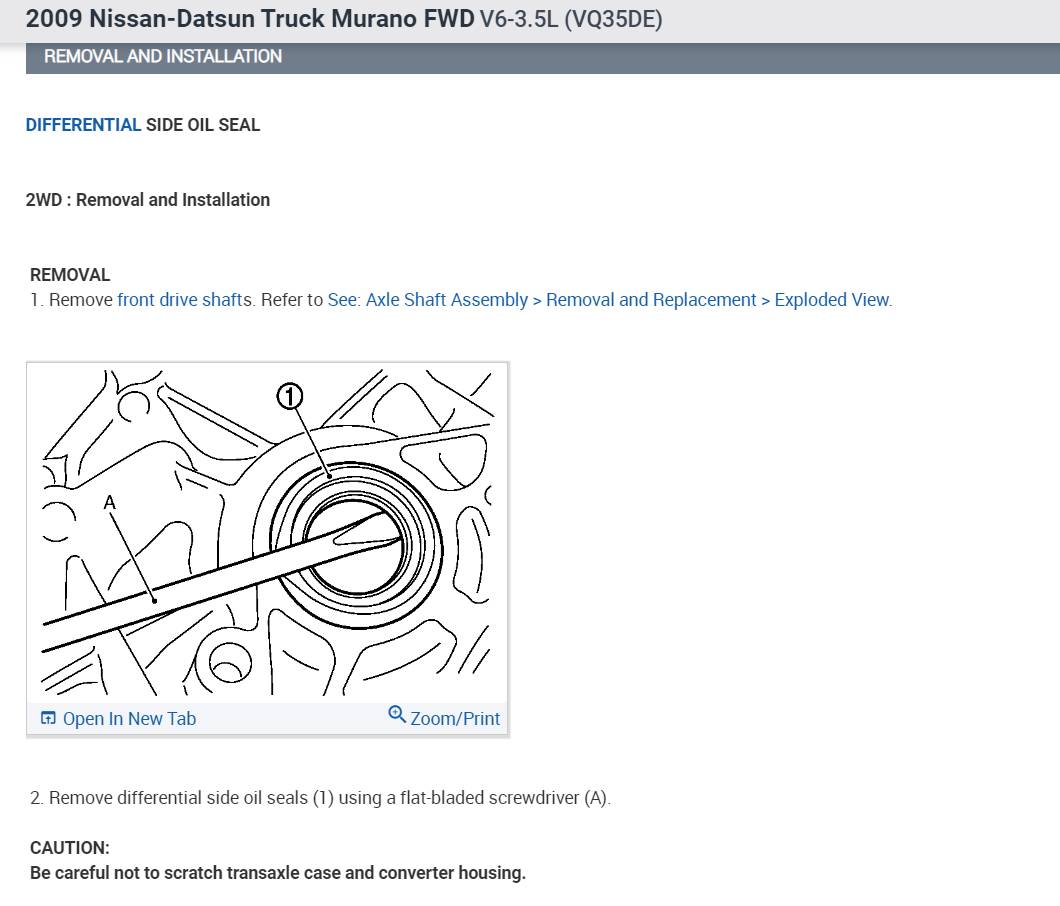

It would be good if you could take a picture of the metal cap you are talking about and upload it. Also, I have had to freeze the seal to shrink it down slightly and use a heater to warm the transmission seal area which will expand it slightly. Do not run the transmission when it is down on fluid. Here are the instructions on how to replace the seal to help you with the repair in the images below.
Sep 13, 2022 at 2:49 AM

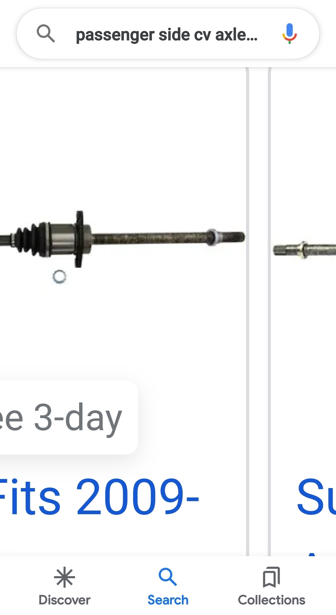

I'm going to upload again a picture of what my axle shaft looks like on the shaft end that goes into my transmission there's a metal cap like lip that slides onto the rubber of the seal once completely inside the transmission it's on the far left of the pic.

Sorry for the delay. yes, you need to replace the CV axle the metal seal retainer cannot move on the shaft.
