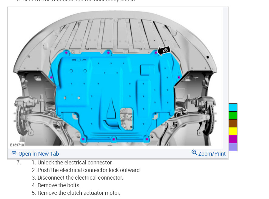

I may be getting a cheap deal on this car which has codes. Have you ever seen these codes before?
P07A3
P2872
P144A
P1450
Apr 29, 2023 at 4:04 AM
  • 55,423 POSTS

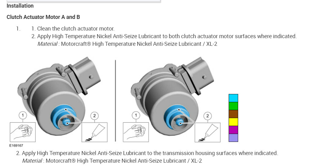

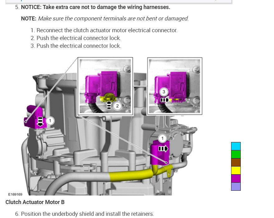

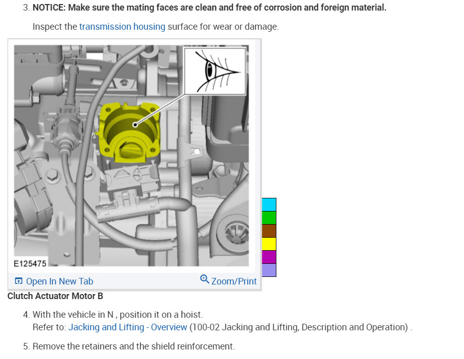

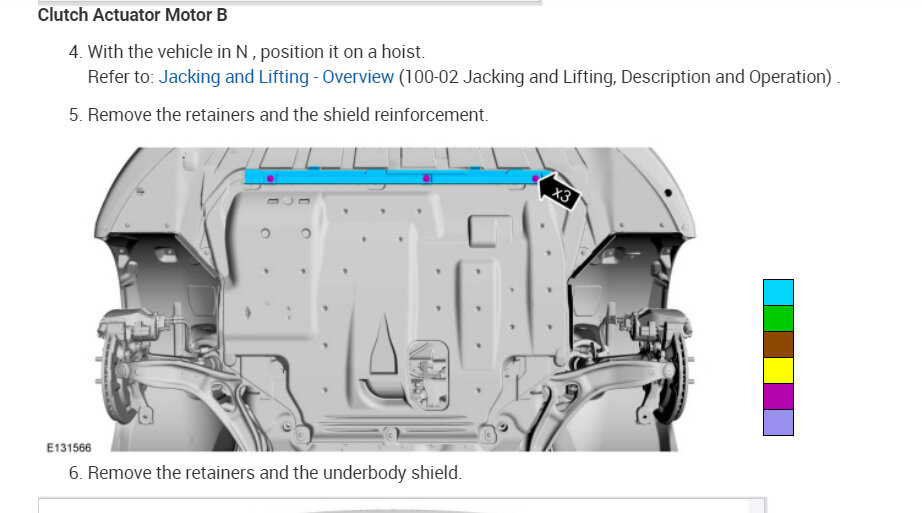

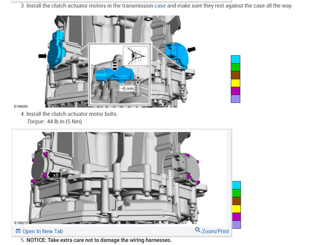

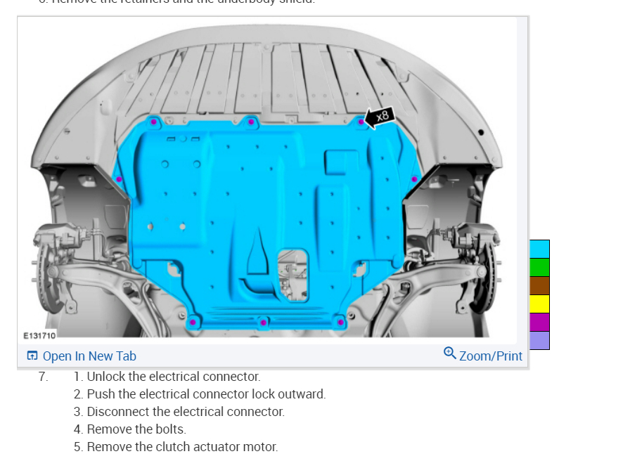

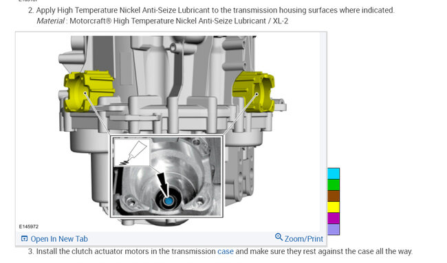

Here are what the codes mean:
P07A3: Transmission Friction Element B Stuck On
P2872: Transmission Friction Element E Stuck On
P144A: Evaporative Emission System Purge Vapor Line Restricted
P1450: Unable to Bleed Up Bleed Fuel Tank Vacuum

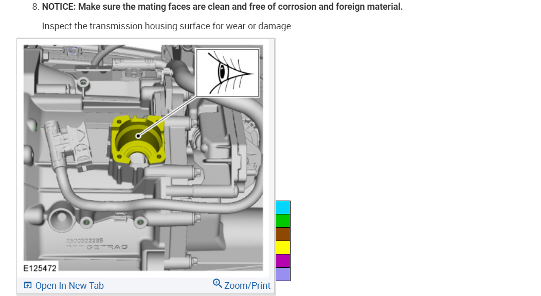

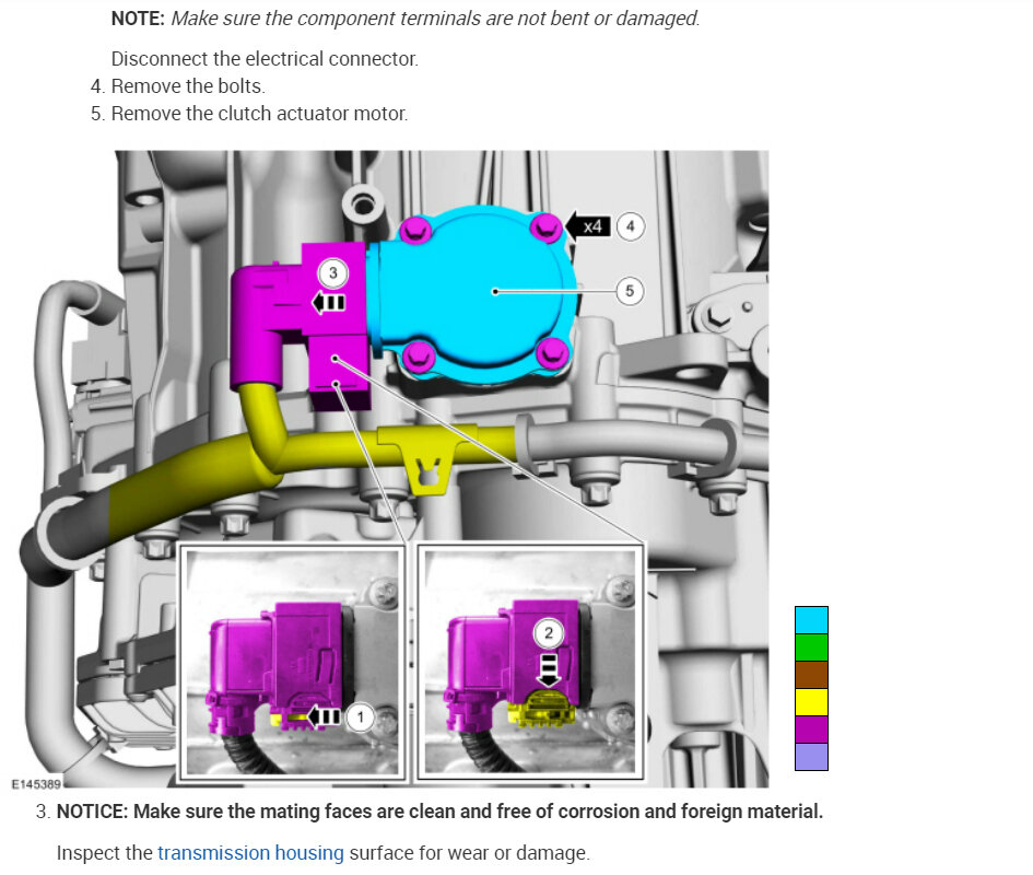

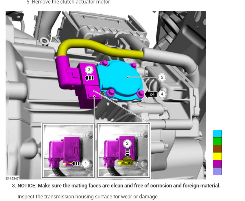

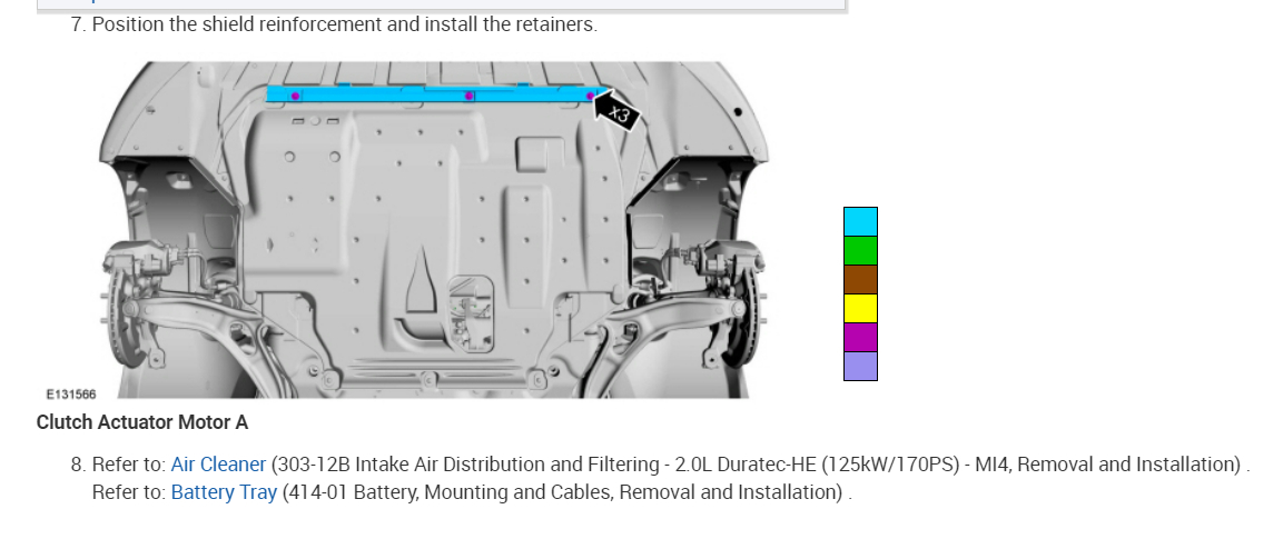

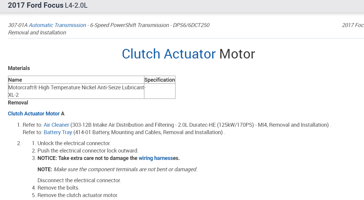

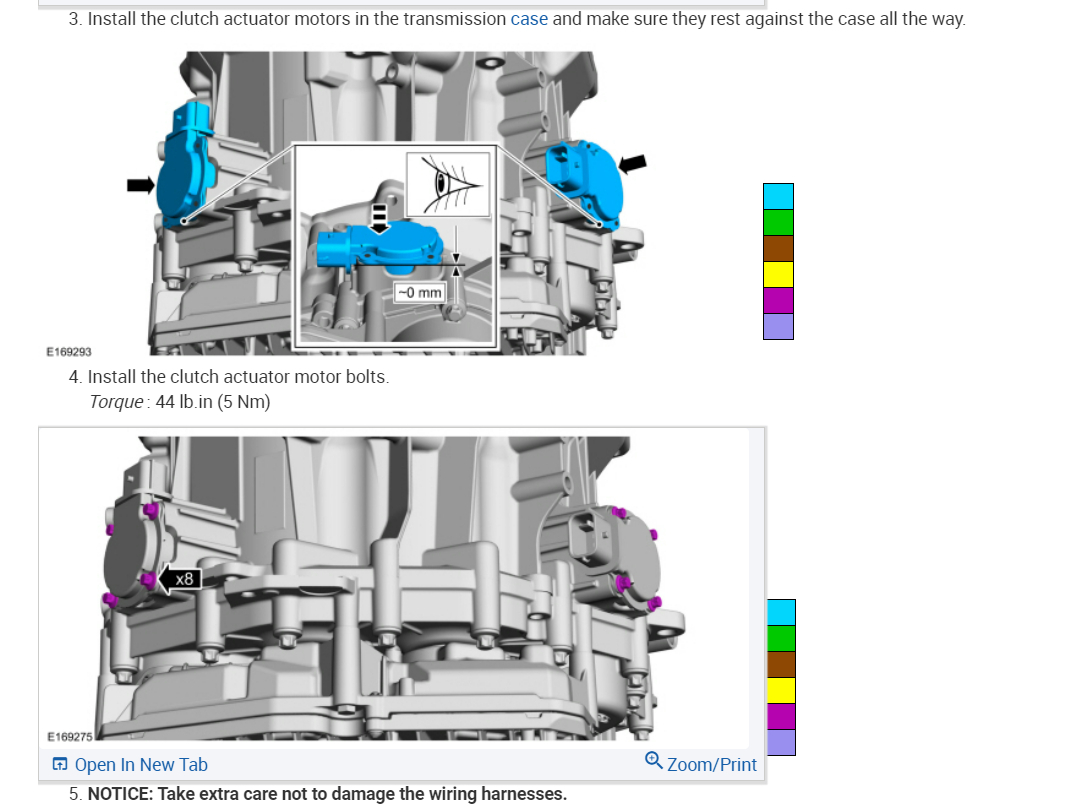

So, this car has a DCT (dual clutch transmission), and it looks like one of the clutch actuators stopped working. here is how to change them out which I recommend you replacing both of them. The last two codes are for a different system so please start a new question featuring these codes because we only handle one problem per thread. Check out the images (below). Let us know what happens and please upload pictures or videos of the problem so we can see what's going on.
