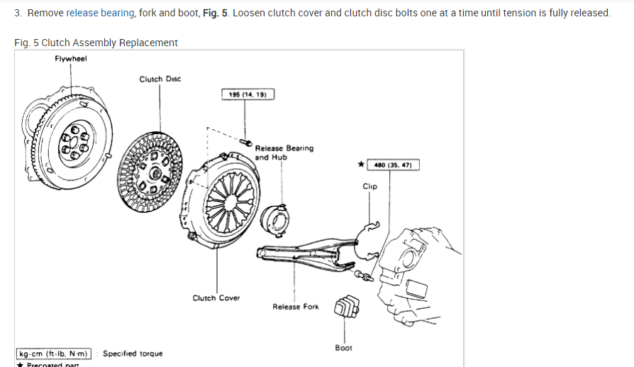

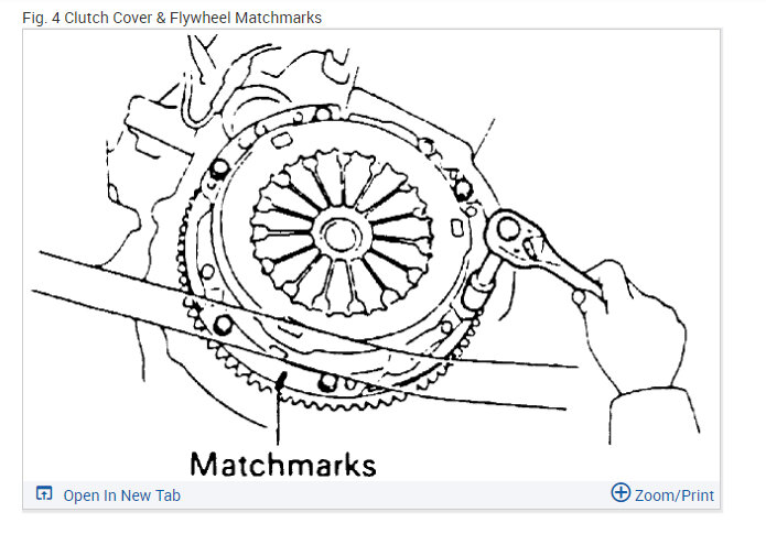

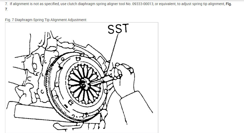

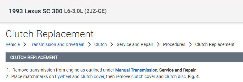

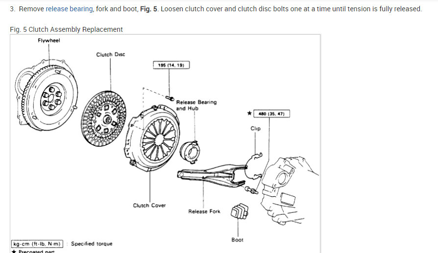

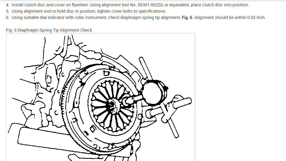

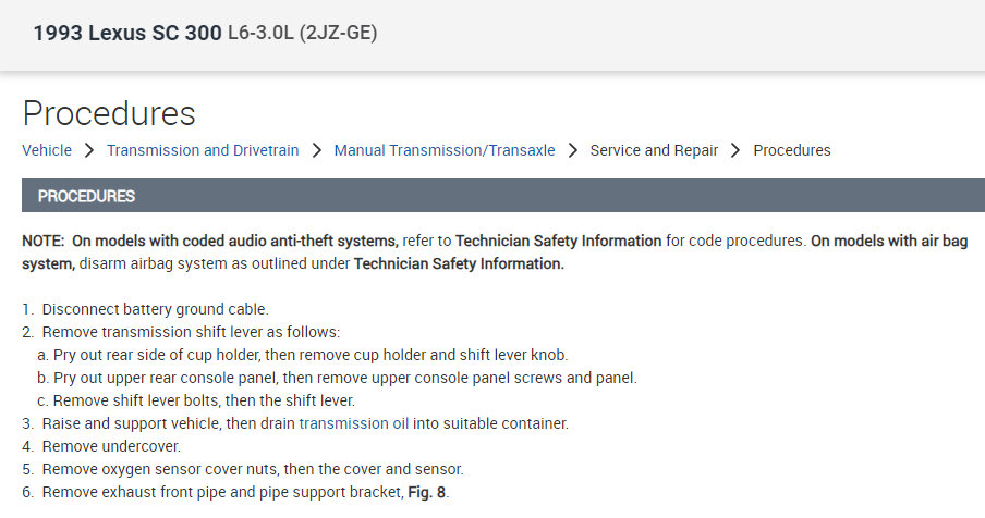

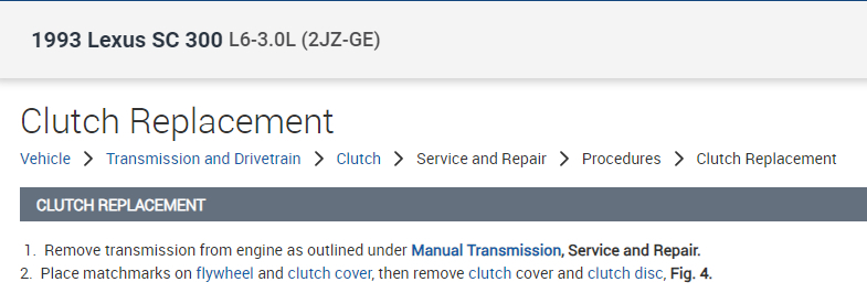

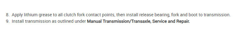

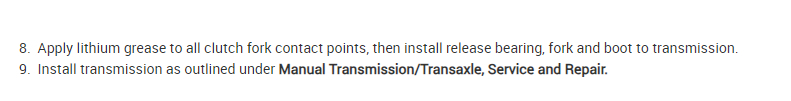

What are the steps to replace the transmission clutch?
May 27, 2024 at 8:09 AM
  • 110,244 POSTS
I attached the directions for the clutch assembly (pressure plate, disc, throw-out bearing). Take a look and let me know if it helps.
Also, this procedure is after the transmission is removed from the vehicle. Let me know if that is something other that you need.

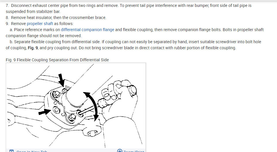

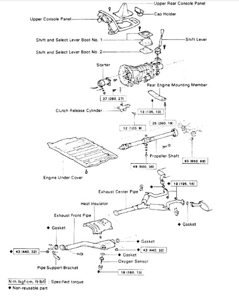

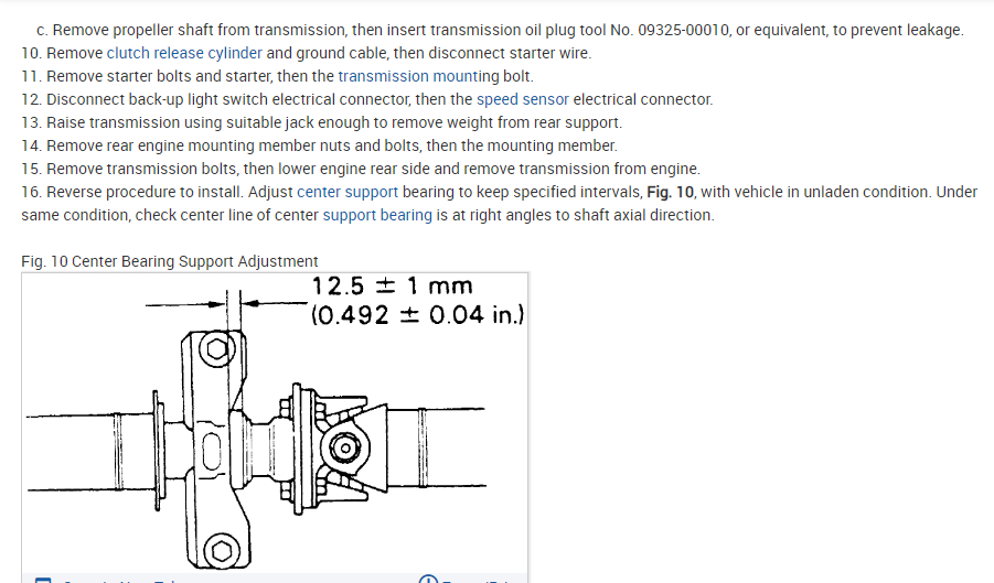

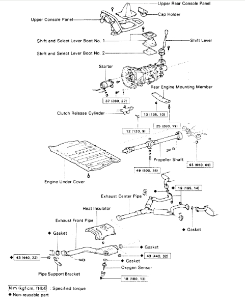

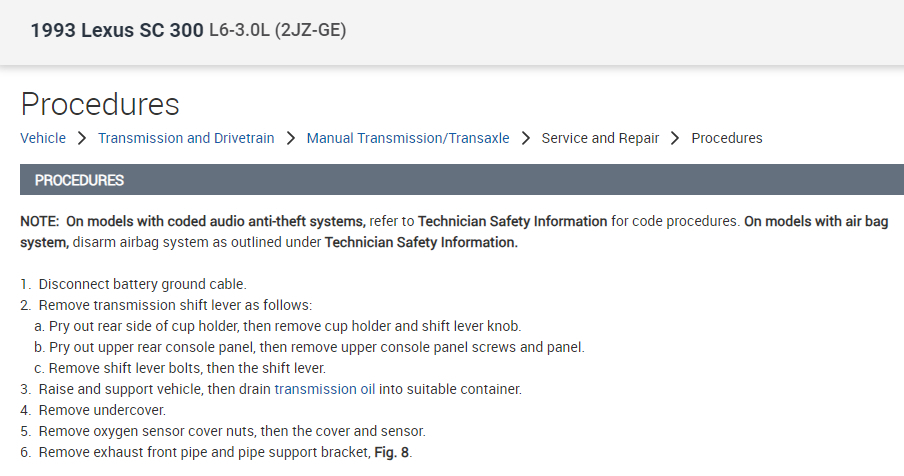

I needed a step-by-step guide with removal of the transmission if you have it. thank you
May 27, 2024 at 12:11 PM
  • 110,244 POSTS
No problem. Below, I attached the directions from my manual for you. Take a look through them and let me know if you have questions.

How do you remove and reinstall the top two bolts on the transmission? There's hardly any room and I'm having trouble. thanks
Jun 1, 2024 at 12:41 PM
  • 110,244 POSTS
Are you able to get them from below with a long extension and a swivel socket? I realize it is tight to work on or around that area.
