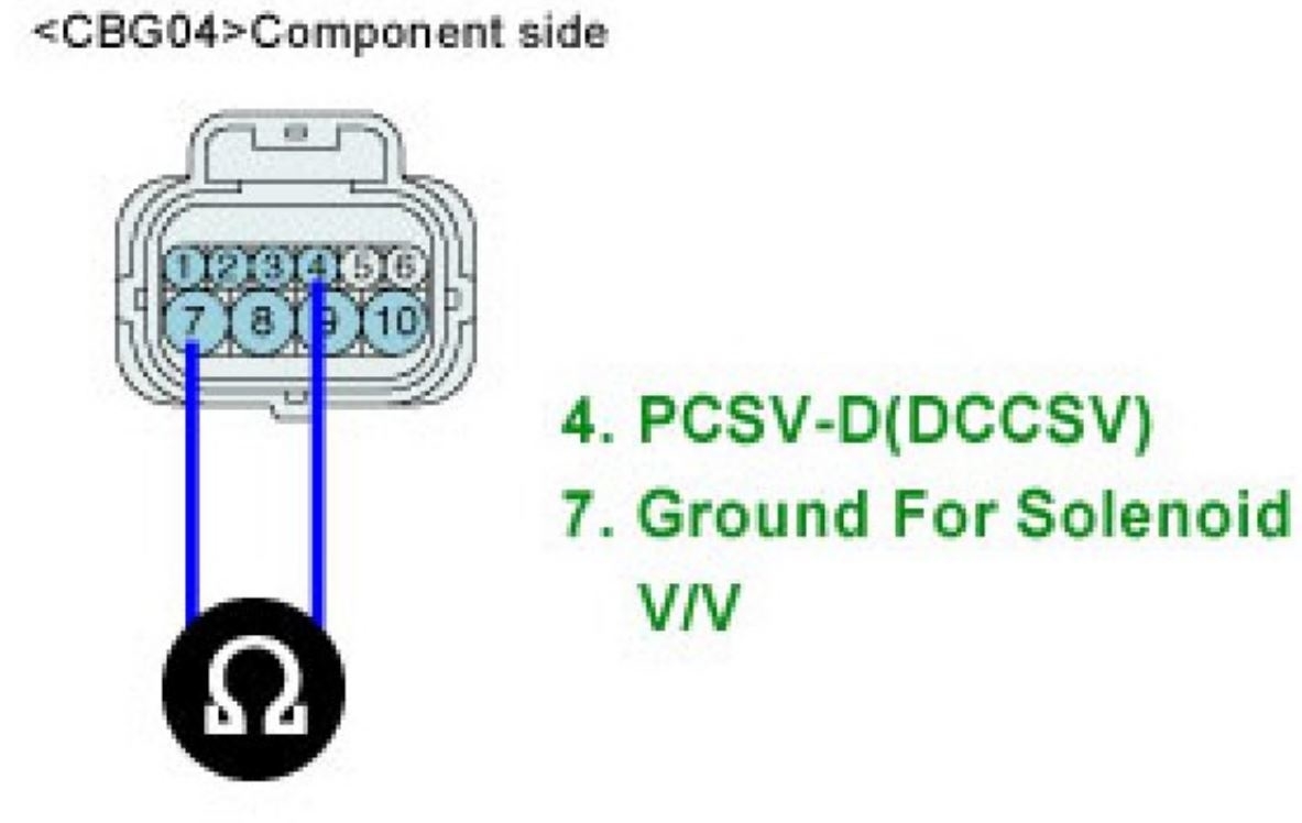

He left me a sheet that just says:
P0743 Torque Converter Clutch Circuit Electrical
and
P0700 TCM Malfunction
Would it be worth it to just have him install new solenoids and a new wiring harness (I have heard there has been an issues with Kia Spectra's and wiring harnesses)?
To have the Kia dealership look at the car, they want $130.00 to have their mechanics analyze it themselves, which I just had done from another dealer.
Sep 6, 2020 at 1:35 AM
STEVE W.
  • 15,352 POSTS
P0700 is a generic -I have a problem in my transmission- code. It pops up only to tell a shop to scan the transmission control system for the real code.
P0743 is the actual problem code and it is a circuit code, which means the TCM sees there is a problem with the converter clutch solenoid or it's control wiring. Either shorted, open or it's getting the wrong feedback from the solenoid. It is very likely the wiring or connector for the clutch solenoid. Testing if it is the solenoid is easy and requires a simple volt ohm meter. You start by unplugging the transmission connector and measuring the resistance between the two indicated pins in the connector on the transmission. You should see 3.5 ± 0.2 ohms between those pins if the solenoid is good. If it tests bad then replace the solenoid pack, if it tests good, then inspect the wiring harness connectors and the harness back to the TCM. It doesn't take much to cause an issue.
