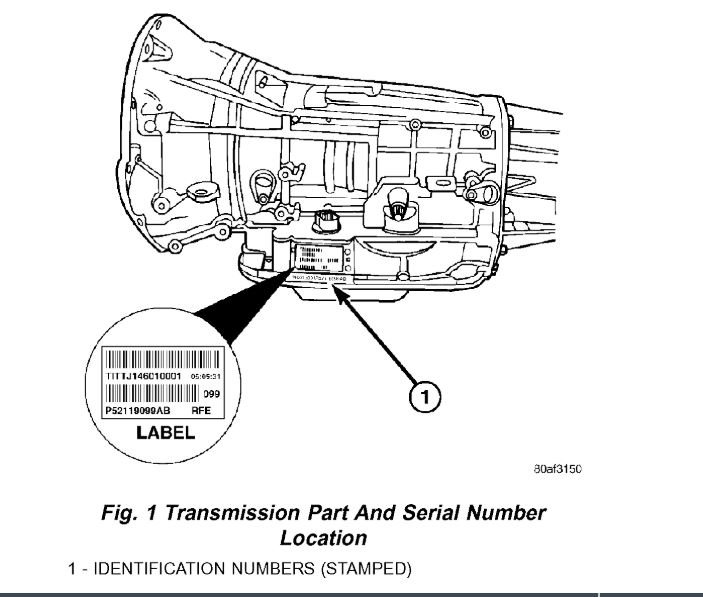

I bought the vehicle listed above Sport for my kid's mom. Long story short, I checked fluids one day and noticed the transmission being low. She added some random ATF to top it off. now it seems to shift pretty rough and is making a noise that I can only think to explain as a component struggling to work/move correctly. With this being said I have two questions I'm hoping to get some advice on.
1. My first instinct is to change the filter and fluid. Am I correct in wanting to do so?
2. How do I distinguish between the 45RFE and 42RLE?? I've had no luck with researching online and the manufacture date is 08 of 2002, which I've read is around the time these two transmissions where in the process of being replaced, one way or the other.. I apologize for any confusion in my explanation and would greatly appreciate any advice or insight on this issue!!

Good morning,
Yes, I would change the fluid and filter. Start with fresh fluid. The other fluid may be contaminated from adding old fluid.
As far as the noise, see if it is still there after the service.
I attached a picture for you of the pan configuration. This is what the vehicle calls for.
TRANSMISSION IDENTIFICATION - 45RFE
Transmission identification numbers are stamped on the left side of the case just above the oil pan sealing surface (Fig. 1).
Refer to this information when ordering replacement parts. A label is attached to the transmission case above the stamped numbers.
The label gives additional information, which may also be necessary for identification purposes.

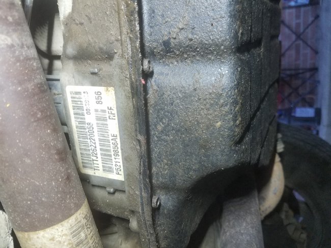

So how can I tell whether the transmission in the vehicle has the shallow pan or not? I'm finding two different filter kits, one for a shallow pan and not. Maybe some of the numbers on the side of the transmission for reference?
Jul 26, 2020 at 9:36 AM
That is the deep pan. The shallow pan is about half as deep.

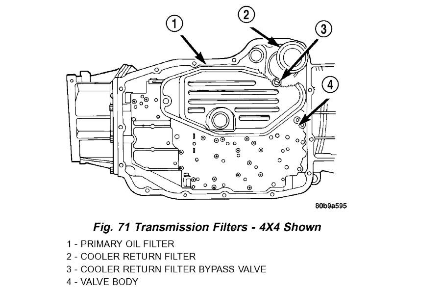

Any idea what the capacity of this transmission is? Or should I just do like 4 quarts, cycle through gears, check level etc? Also with the screw on filter, does it need to be filled with fluid before installing? Does the pan gasket need to have silicone applied? And one last question haha, are there specific torque specs for the pan bolts?
Jul 26, 2020 at 10:29 AM
Specs are below.
Fluid Types
Automatic Transmission Fluid .................... Mopar ATF +4, Type 9602
Capacities
42RLE - AUTOMATIC TRANSMISSION
Service Fill .................... 8.0 pints (3.8L)
Overhaul Fill .................... 17.6 pints (8.3L)
45RFE - AUTOMATIC TRANSMISSION
Service Fill .................... 10 pints (4.73L)
Overhaul Fill .................... 28 pints (13.33L)
Jul 26, 2020 at 10:34 AM

Having the deep pan won't make a difference in capacity?
Jul 26, 2020 at 11:01 AM
The 45 holds 10 pints. That is where you start.
