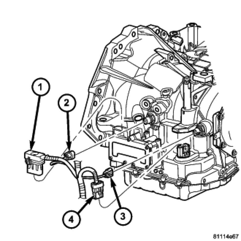

I recently had p0734 code come up so I changed the fluid and filter and now I have P0733. Should I replace the in put and output sensors? Or is this going to be a transmission job? Thank you
Feb 18, 2019 at 1:50 AM
  • 110,240 POSTS
Does the transmission feel like it is slipping in third of fourth gear? Honestly, if it isn't, you really need to check line pressure in the transmission. It could be low. How dirty was the transmission fluid when you serviced it? If it was really dirty, you may want to try flushing the transmission cooler. Also, when you serviced it, was there any metal debris in the pan? Was the filter partially plugged? It could be a pressure switch or internal damage. The odd part that leads me to believe it is a pressure issue is the fact it changed from a 734 which is a fourth gear issue to a third gear problem (733) issue. If the transmission was slipping, I feel it would remain consistent with one gear. At this point, it's a theory.

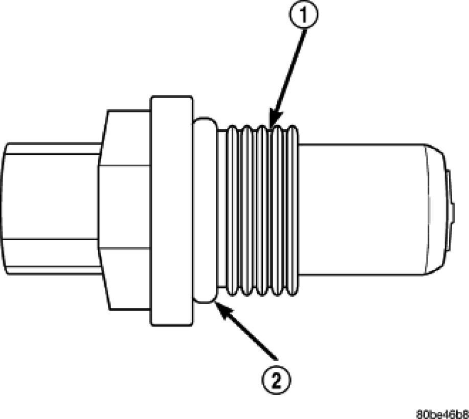

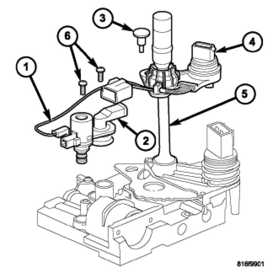

Here are the directions for the sensors. First is the input speed sensor. The attached pictures correlate with these directions.
REMOVAL
REMOVAL
Picture 1
1. Disconnect battery negative cable.
2. Disconnect input speed sensor connector (2).
Picture 2
3. Unscrew and remove input speed sensor (1).
Picture 3
4. Inspect speed sensor O-ring (2) and replace if necessary.

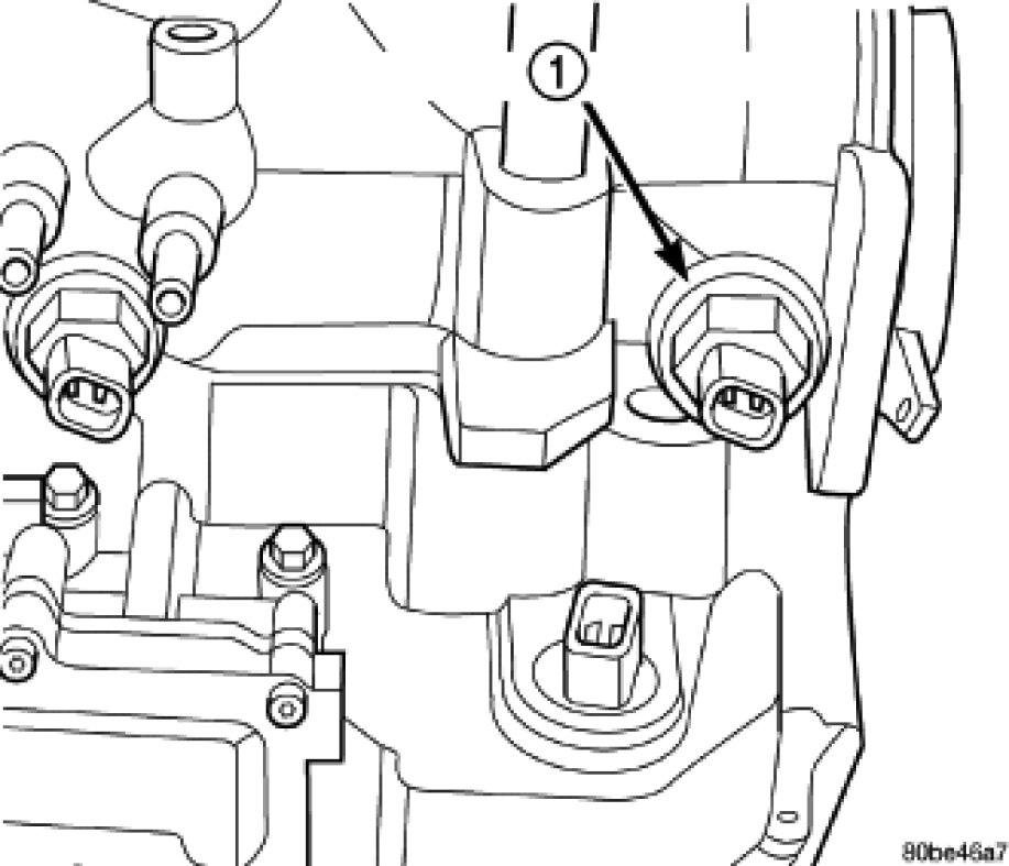

Output speed sensor
REMOVAL
Picture 4
2. Raise vehicle on hoist.
3. Disconnect output speed sensor connector (3).

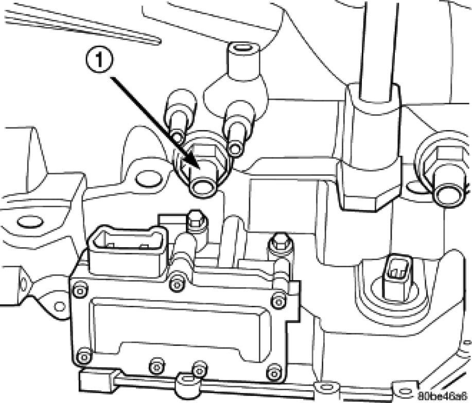

Picture 5
4. Unscrew and remove output speed sensor (1).

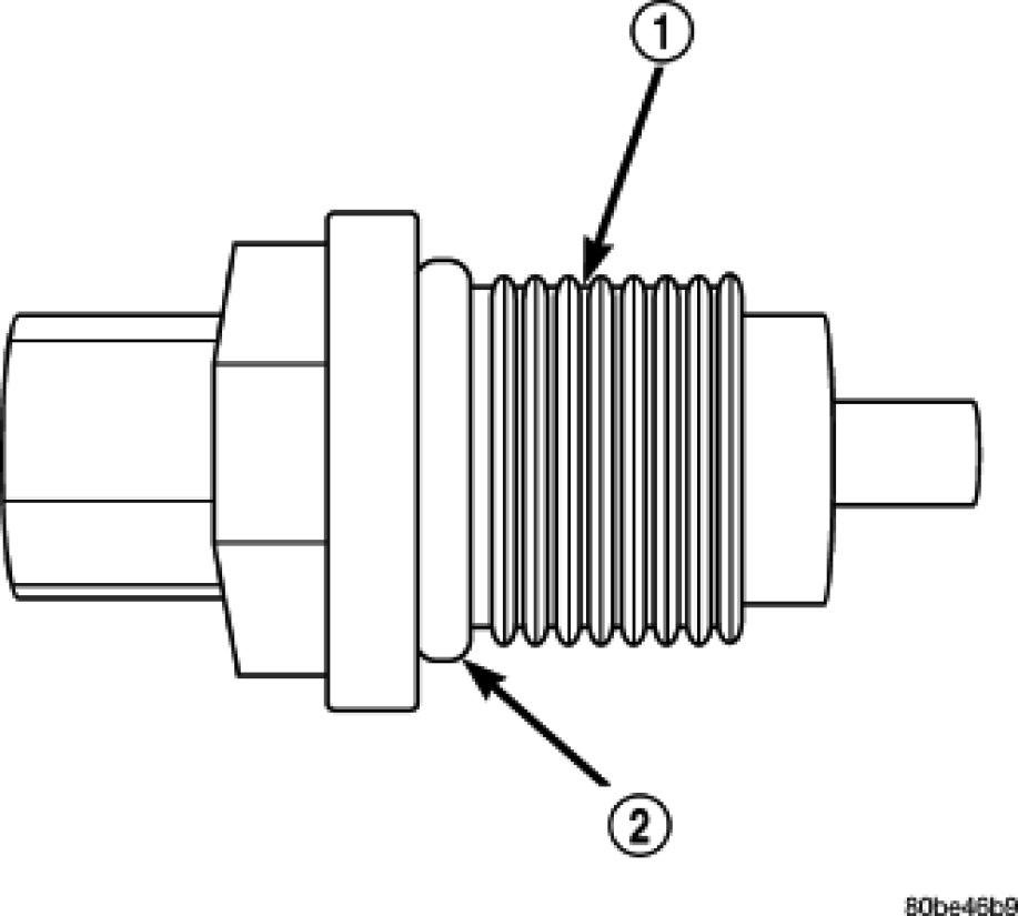

Picture 6
5. Inspect speed sensor O-ring (2) and replace if necessary.
