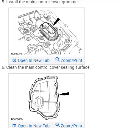

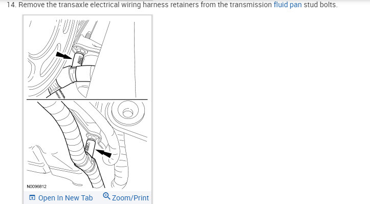

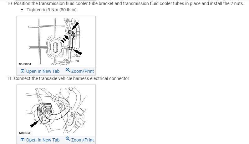

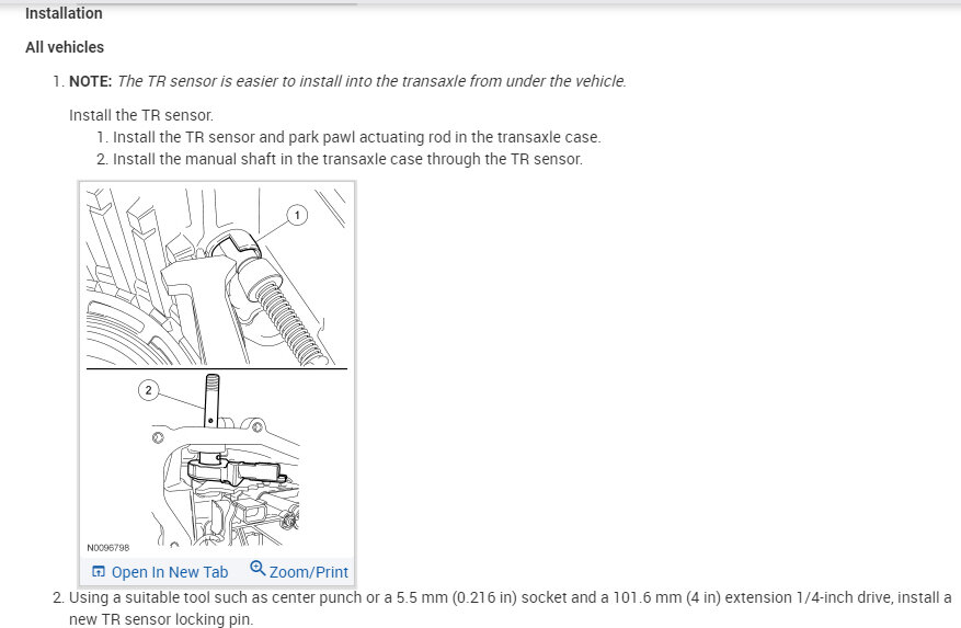

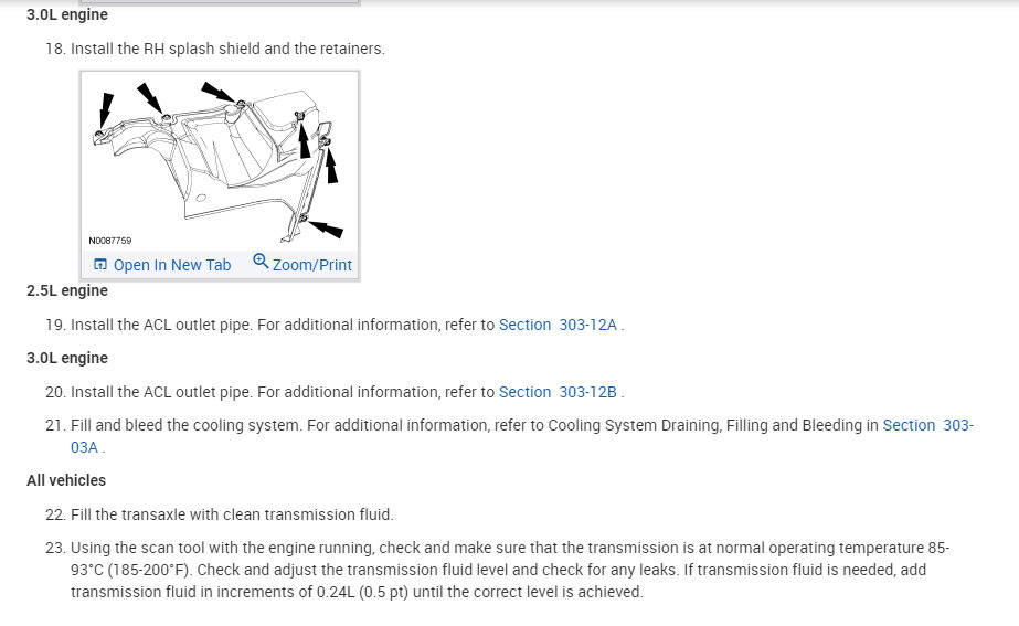

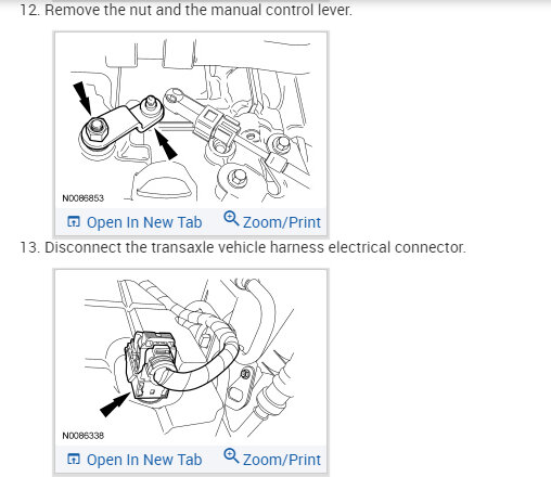

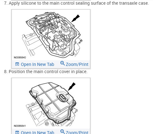

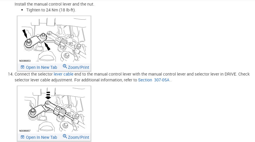

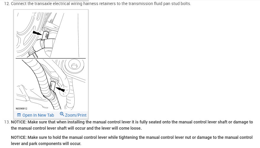

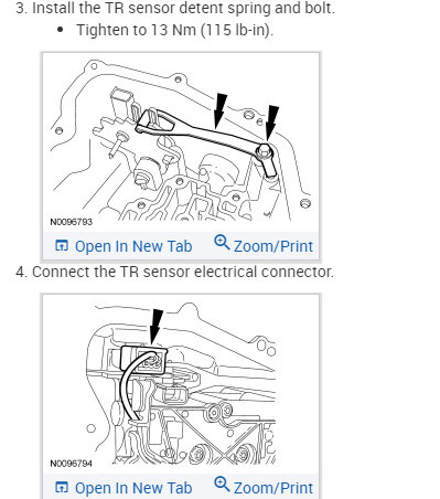

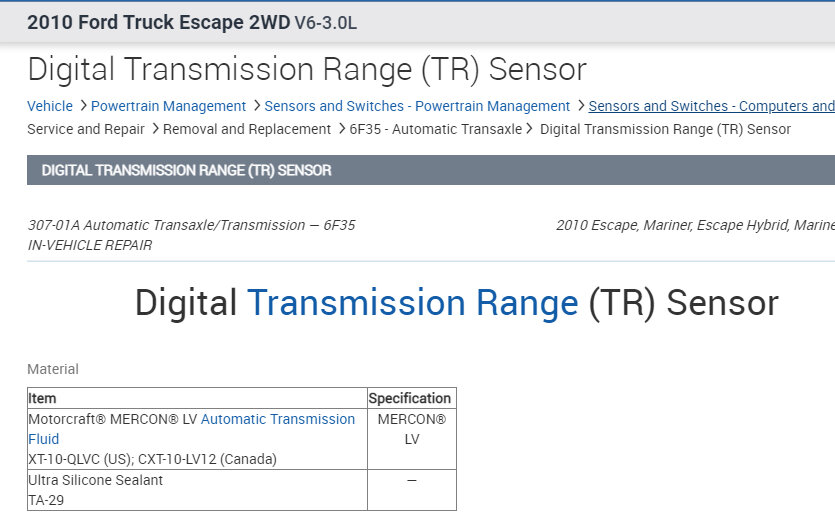

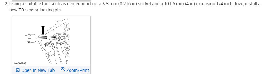

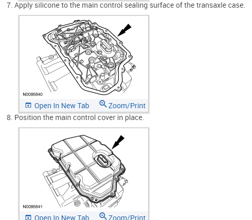

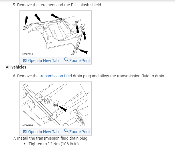

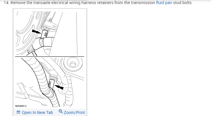

Trying to locate the transmission range sensor.
Apr 1, 2023 at 11:15 AM
  • 110,194 POSTS

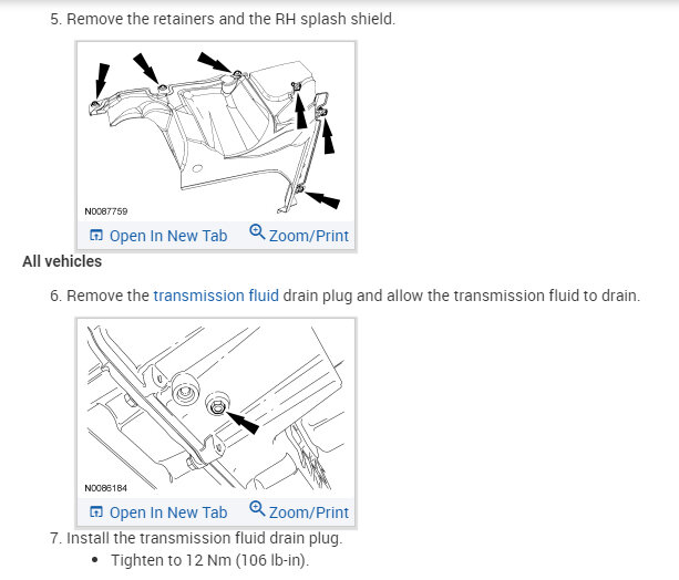

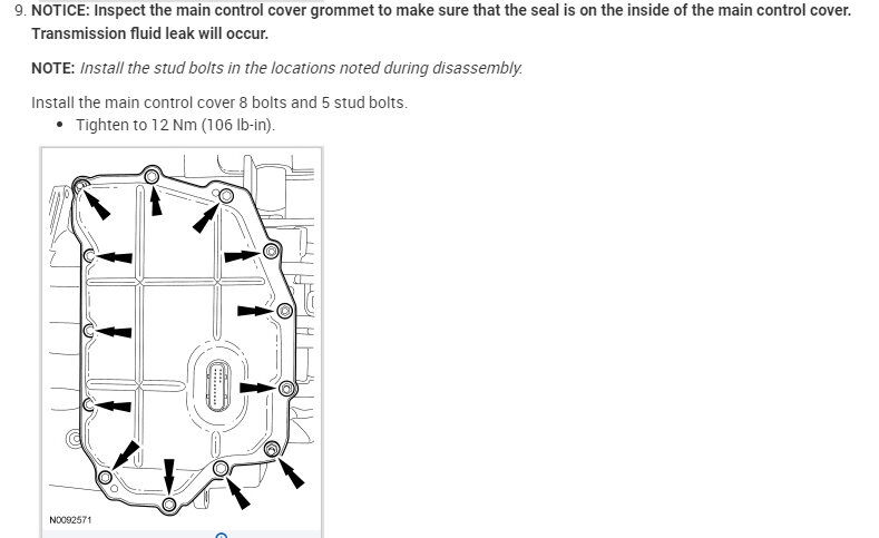

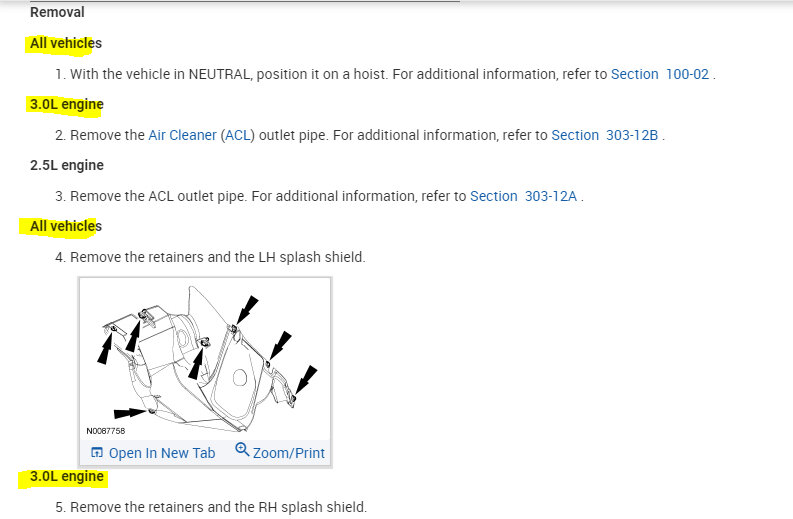

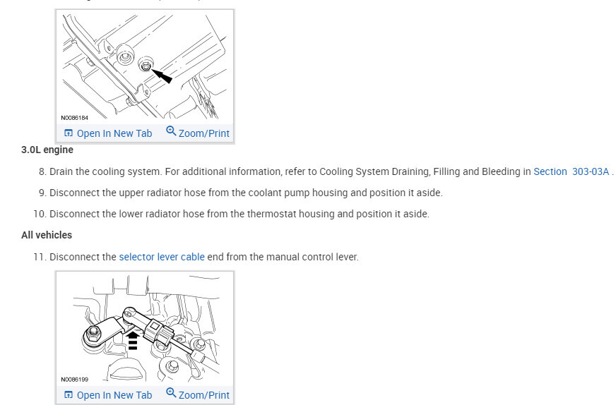

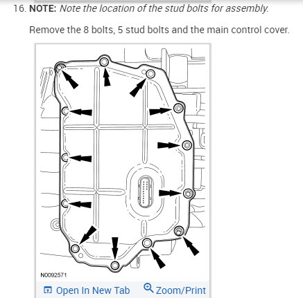

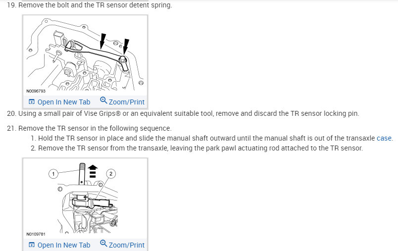

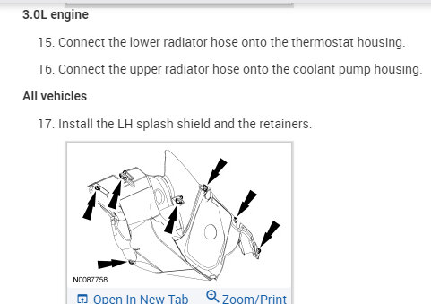

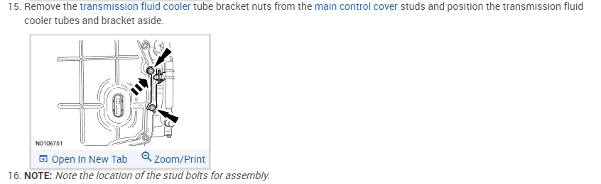

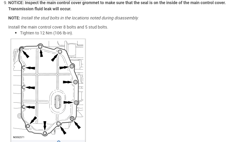

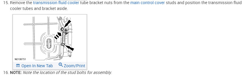

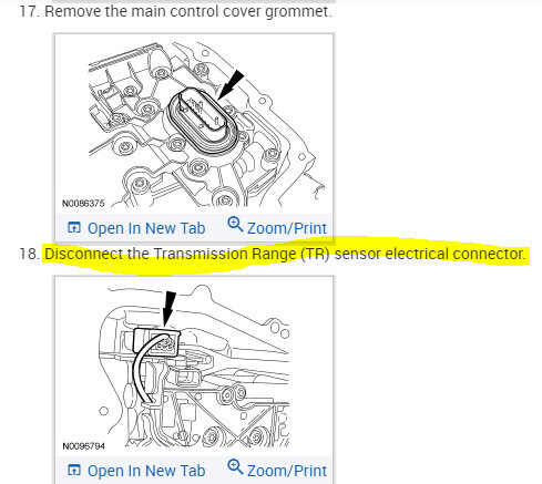

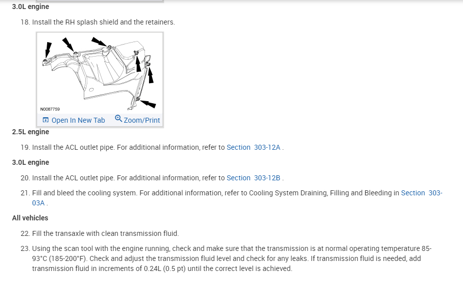

The range sensor is internal. It requires the removal of the fluid, pan, and I believe the valve body.
I attached the directions below for the removal and replacement of the range sensor. Take a look through it and let me know if you have questions.
Apr 1, 2023 at 5:26 PM
DIESELDOG92
Thank you. How easy is this to do on my own? (Not very huh)
Apr 1, 2023 at 6:00 PM
  • 110,194 POSTS
It is doable, but it really isn't a quick or easy job for anyone. LOL If you feel confident, I suggest doing it. If you run into trouble, I'll be here to help.
