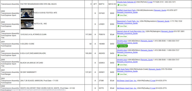

Good afternoon,
No, the transmissions are pretty much the same for about 5 years. You are better off getting the exact replacement. Otherwise, the replacement may be different electronically causing it not to work correctly.
I attached just one page of many available for you from Car-Parts.com. A good site to get used parts.
I attached a youtube video of the procedure for you for the replacement of the transmission.

01 EDGE
Transmission slipping when warmed up. just bought it 2 weeks ago 207,000 on engine. I believe he said had been gone through it visually looks very very clean.
Jun 27, 2021 at 8:26 AM
Most likely it is an internal issue. Replacing it with a used or rebuilt transmission would be a good idea.
I would contact people around you from the site I sent you for price and availability.
