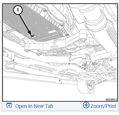

Location to fill transmission fluid?
2013 DODGE CHARGER
60,000 MILES • 3.6L • 6 CYL • 2WD • AUTOMATIC
PINE74

Sure here is how to check the transmission fluid level:
STANDARD PROCEDURE - CHECK OIL LEVEL
To properly check and fill the transmission, perform the following procedure:

Remove the fill plug from the right rear of the transmission case.
Add transmission fluid until it trickles from the fill opening.
Install the fill plug.

A full transmission will have fluid at the fill hole with the transmission between 30°C (86°F) and 50°C (122°F). Do not over fill.
Remove the fill plug and allow excess fluid to drain from fill hole or add fluid as necessary.

Check out the images (below). Let us know if you need anything else.
