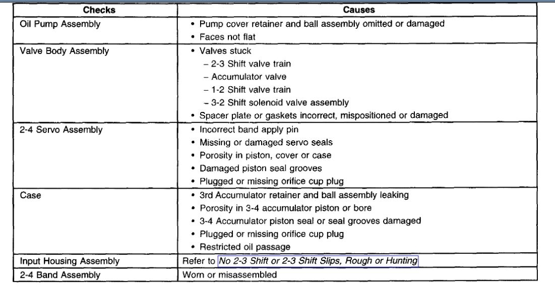

My truck listed above with the 4L60-E has to rev high to catch third and won’t shift into overdrive.

This sounds like it is slipping. In most cases, this happens when the clutches are worn out and cannot lock up and continue to pull the Truck.
How long since you replaced the fluid and filter? A clogged filter could cause this issue but I doubt it.
You most likely will need to either have it overhauled or replaced.

What if the shifter solenoids goes out? Because it catches 1st and second.It doesn’t catch 3rd.2nd just kicks into the passing gear. i'm thinking that the solenoid went out.Which you can get to from the pan.But I’m not 100% sure.

You have a 3-4 solenoid and a lock up solenoid. If you have lost 3rd and lock up you would have 2 bad solenoids. Not likely.
First thing that will cause this is 1 quart or more low on fluid.
Then plugged filter.
A bad pressure solenoid.
A filthy pan allowing junk into the valve body and hanging up valves.
Could be a worn out pump also. A pressure test wouldn't hurt. You can get a pressure gauge for about $20.00.
This is where I would look first.
If all that checks okay then you've likely lost 3rd gear and need a rebuild.
