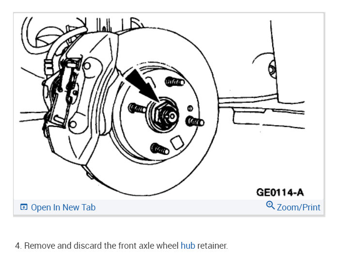

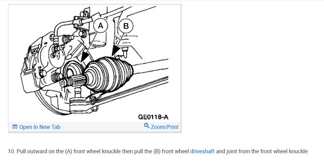

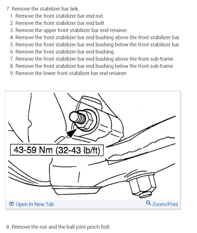

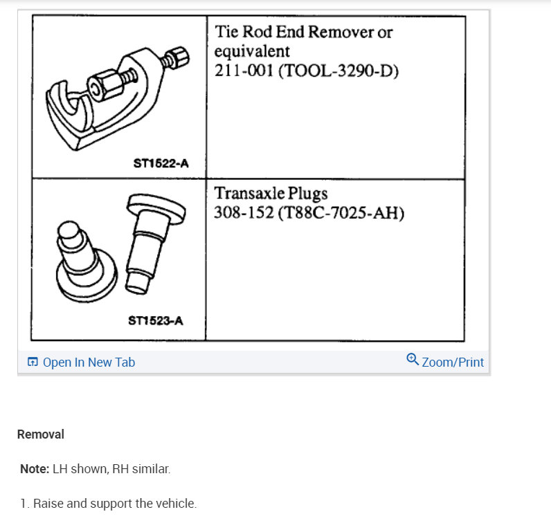

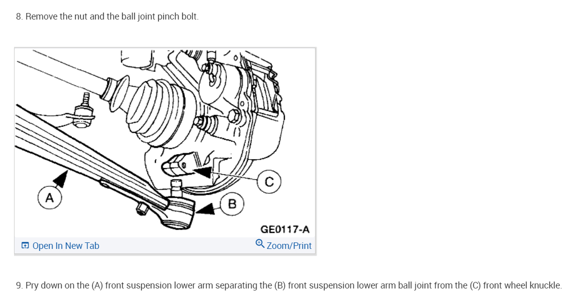

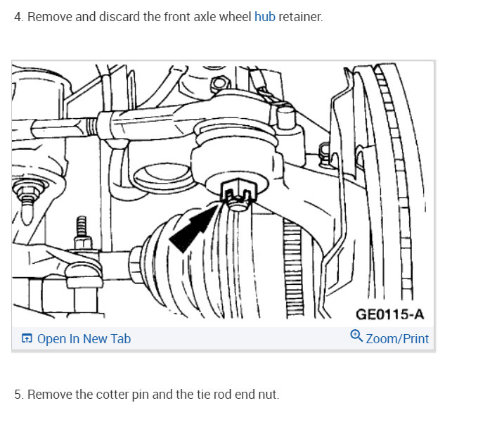

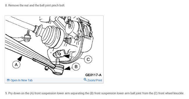

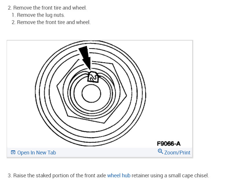

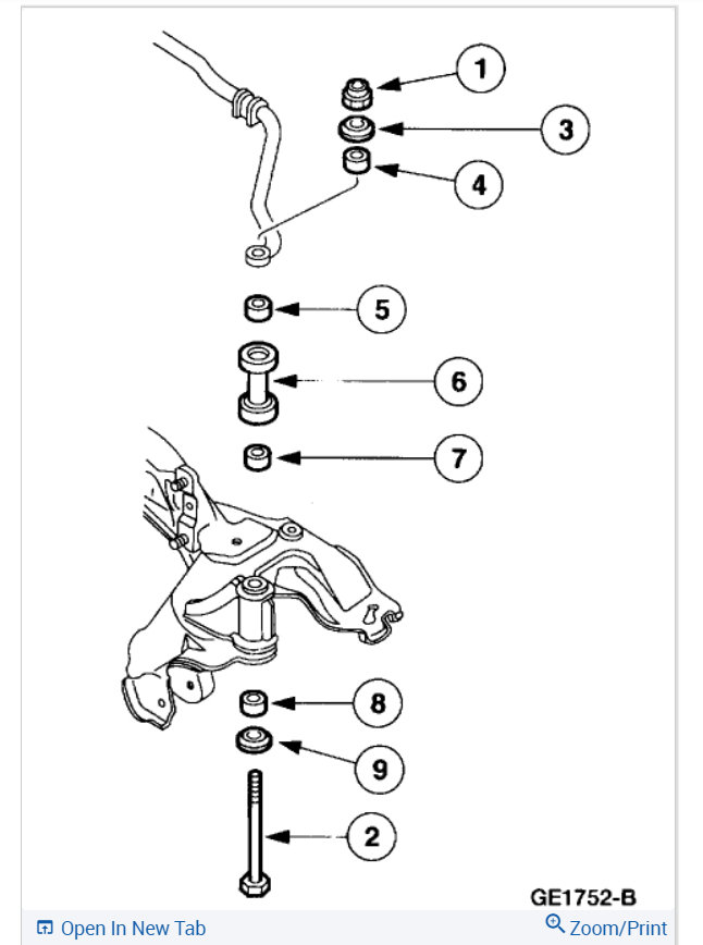

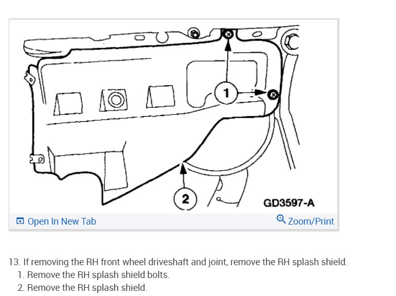

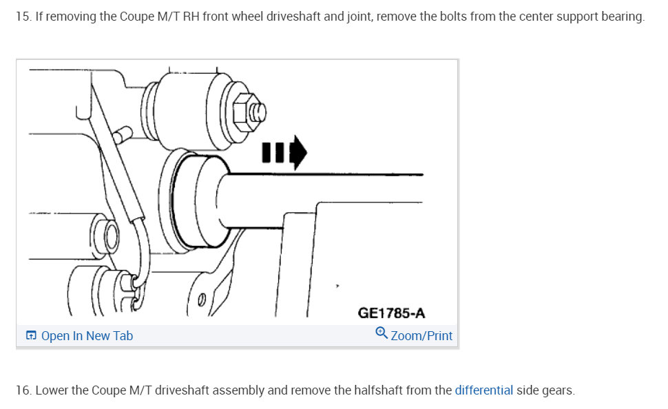

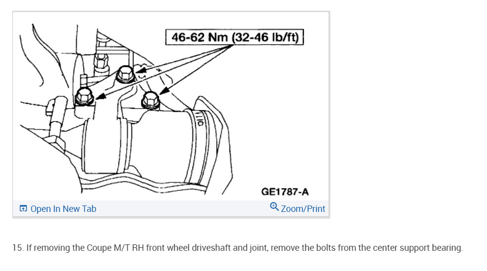

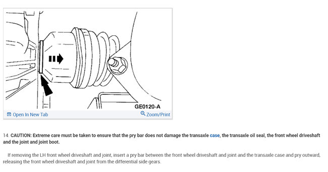

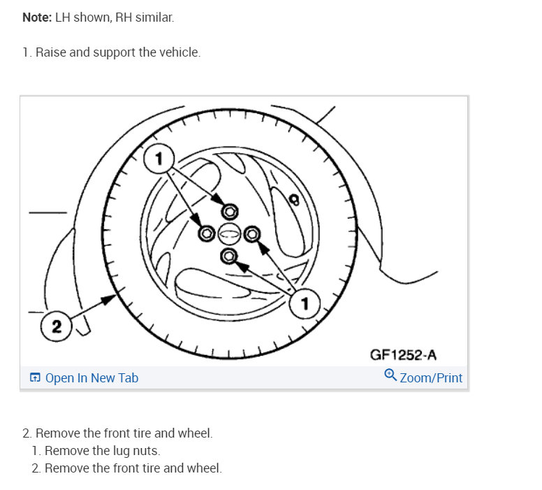

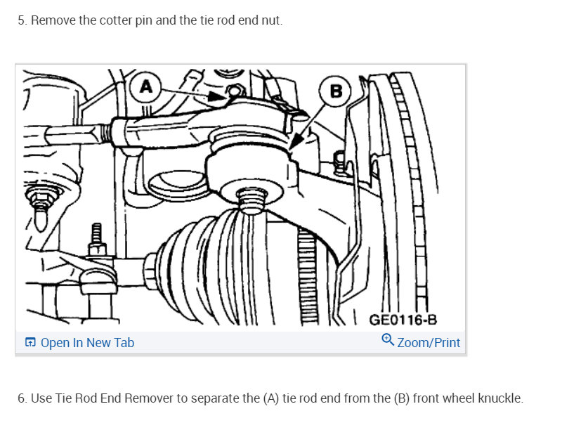

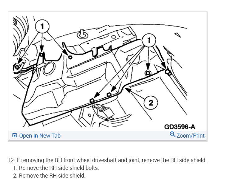

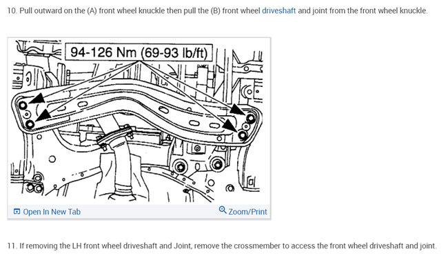

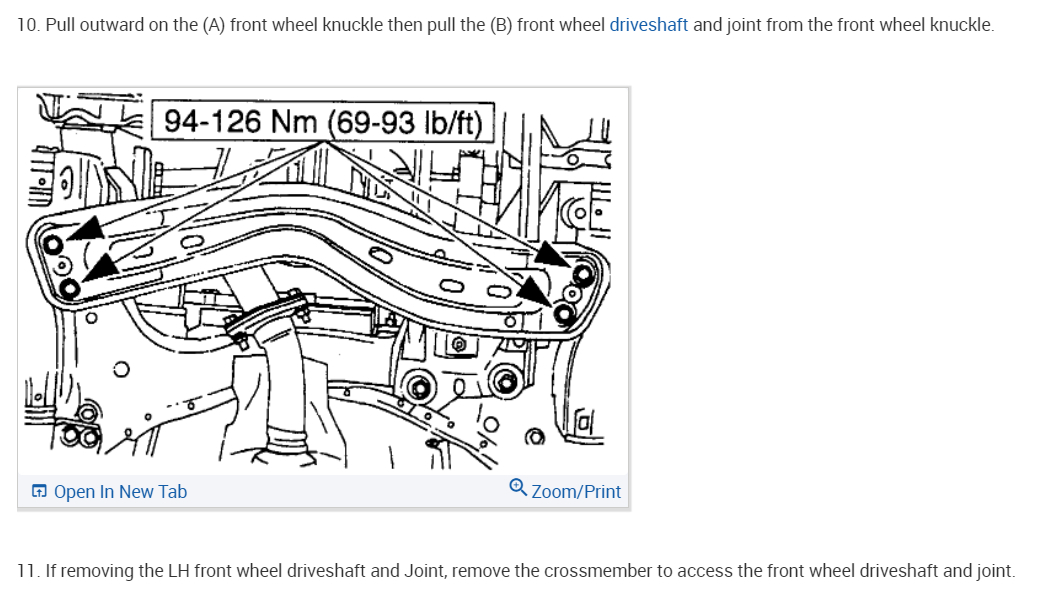

This sounds like a CV axle or axle bearing is locking up, did the car make any strange sounds before this? I would remove the axle shafts and lift the car to see if the front wheels spin. Also check the drive shaft CV joints to make sure they are in good shape. Here is a guide to help you get the job done with diagrams below to show you how on your car:
https://www.2carpros.com/articles/replace-cv-axle
and
