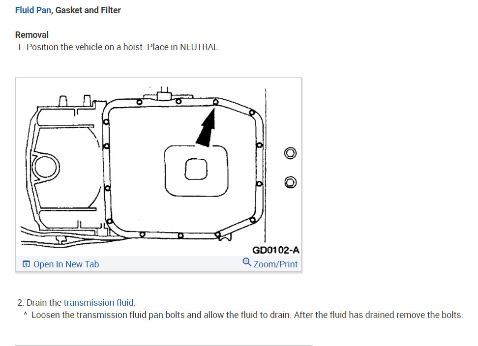

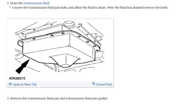

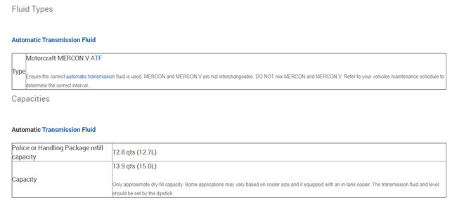

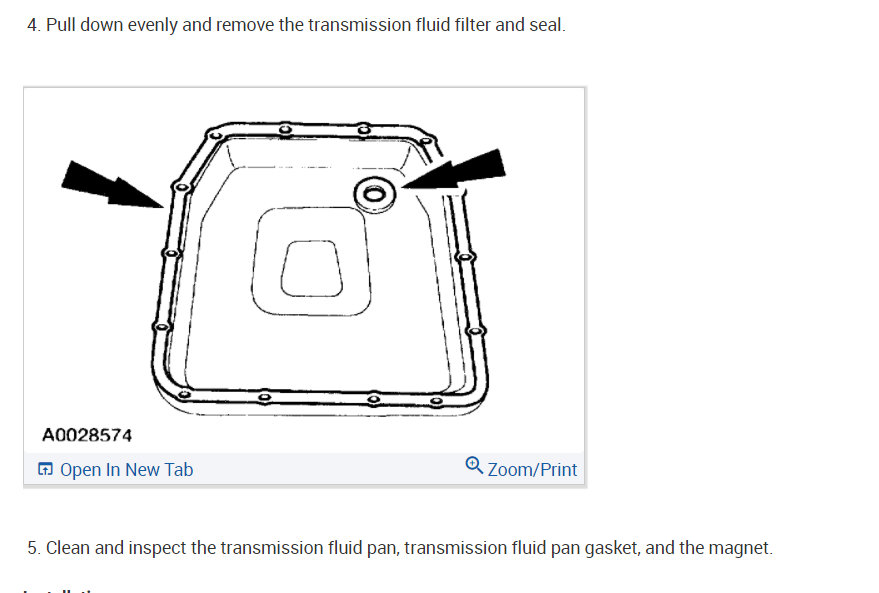

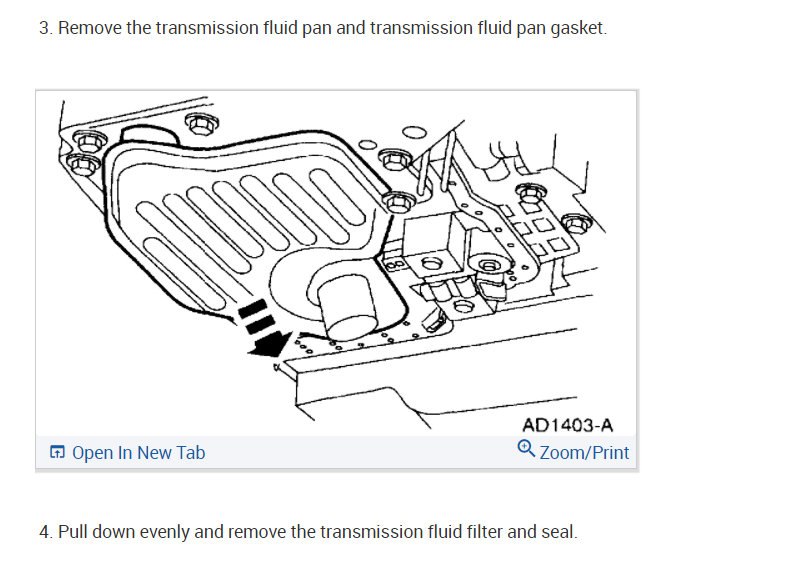

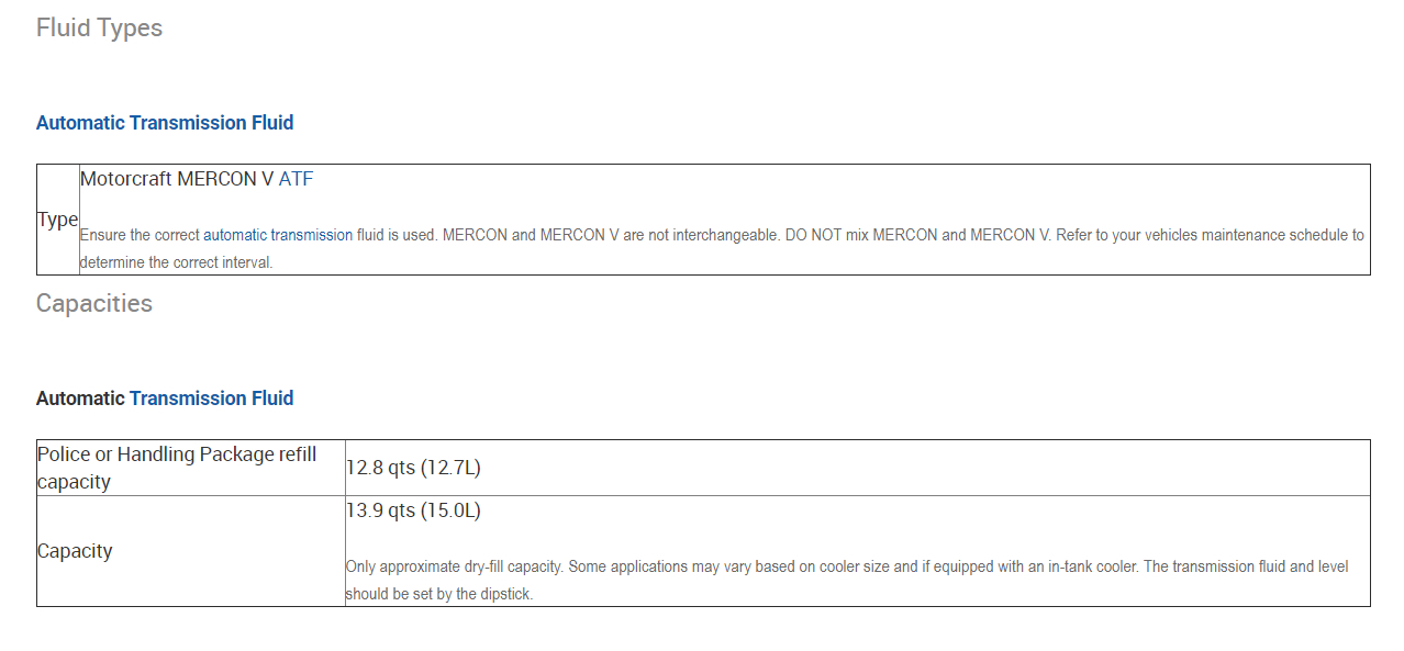

transmission fluid is really dirty and it's a little hesitant on stop and go I don't know when the fluid was changed but it looks like it has been a long time it's very dark brown time for a change. would it be recommended to flush or change the fluid and filter? Because I have heard some cases a flush actually cause the transmission to stop working because of possible debris being in the transmission. what would be the recommendation? it has got over 200,000 miles and I bought the vehicle used.

Good evening,
I would change the fluid and filter. I would not do a flush at all. The chemical used for flushing has been known to damage the clutches in the transmission.
