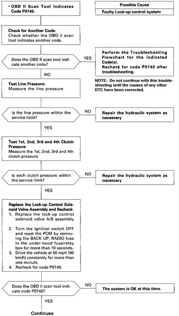

Transmission will shift into gear and then while driving it will eventually slip into neutral and will have to turn the car off and back on to move a couple feet. Then repeat just to move the vehicle. It threw these codes so I thought it might be a TCC solenoid:

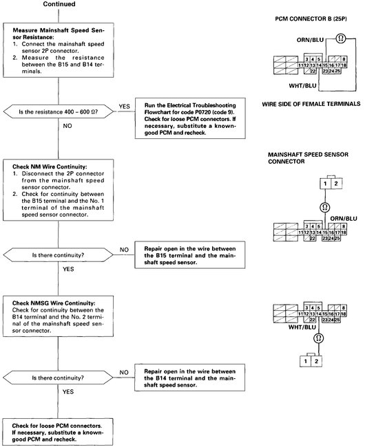

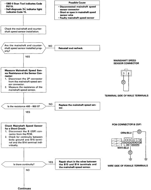

There can be a few problems causing this. The first code, P0715 deals with the main-shift/counter-shaft speed sensor. The first two pictures I attached are a diagnostic flow chart to locate and identify this problem. Please keep in mind, this code does not always mean there is an electrical problem in the main-shaft or counter-shaft speed sensor circuit; it may also indicate a mechanical problem in the transmission. Any problem causing irregular counter-shaft to main-shaft speed difference can cause this code.

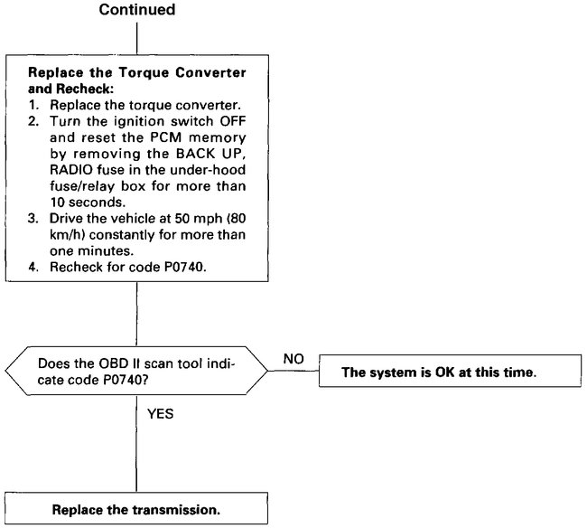

Code P0740 does deal with the TCC solenoid. I have attached the diagnostic flow chart for that too. It is pictures 3 and 4.
Let me know what you find after reviewing these tests.
