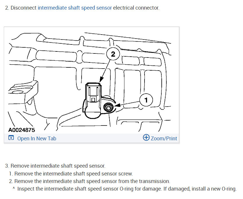

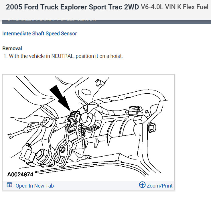

Are there any check engine lights on? If so, you may have an intermediate shaft speed sensor that needs to be replaced but the fact that the fluid is burnt both times you serviced it is not good and the transmission may need to be rebuilt. Here is a video that shows how the transmission will be removed and the location of the intermediate shaft speed sensor location in case you want to try swapping it out.
https://youtu.be/3vJAojsrfuU?si=IGRgVSMOFO-KH-VK
Check out the images (below). Please upload pictures or videos in your response of any problems so we can see what to help you with.
