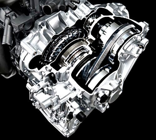

When I drive the car changes gear and while it changes it vibrates, especially when I speed up to overtake, it goes in a lower gear to speed up and while that happens it vibrates, shakes the car.
What could the problem be?
Dec 3, 2019 at 3:13 AM
STEVE W.
  • 15,352 POSTS
I'm sorry to hear that. The Note uses a CVT transmission as shown below. They are very problematic and seem to fail far more often than they should. It is one of the reasons why other companies tried them and then stopped using them shortly after. Vibration and roughness during shifting can be a sign of the drive belt inside the CVT starting to fail.
However another item that could cause a shake when you increase the load on the engine would be an intermittent misfire, with the 3 cylinder engine there isn't any extra power pulses to help hide them. Is the check engine light on or has it ever flashed while the shaking was happening? If not then it is likely the CVT starting to fail.
There have been a few updates to the software that are supposed to help improve the transmission, you might want to see if those have been applied, a dealer would have done them and should be able to look up the VIN number to see if they are there.

Greetings, the problem was caused because of the CVT oil needed change. it has been a while but I thought I'd just give an update.
