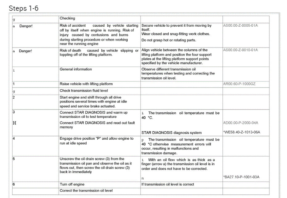

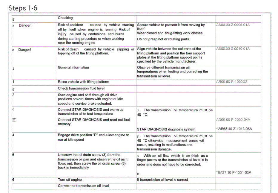

Have you checked to make sure the transmission fluid is both clean and full?
I attached the directions below, but they require a scan tool.
Also, is the check engine light staying on when the engine is running? If so, you may want to consider performing a scan of the can-bus system. CAN stands for controller area network. Basically, all the computers/modules are tied together via a few wires. This type of scan will identify trouble codes regardless of the module storing them. Here are directions and a quick video showing how it's done:
https://youtu.be/u-4syLc-ifQ
Let me know what has been done at this point, and can you explain exactly what is happening.
See pic below.
