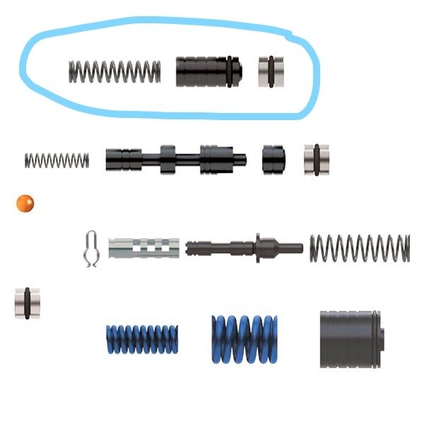

When starting the car for the first time in a day all is okay with shifting from park to reverse and to drive after a few hours of running errands. However, when the vehicle is hot for some reason when backing out of a parking space when shifting to drive it will not shift, everything else will works; reverse, park, and neutral, but trying to shift it in drive it will not take. almost as if the vehicle is on neutral. i have changed plates, cleaned the valve body and changed the pressure point on the TCM and still nothing. fluids are also good.

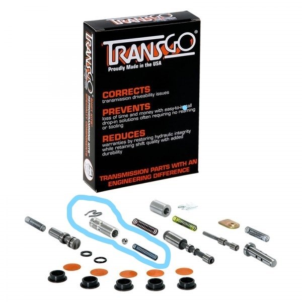

Yes, took valve body apart and bought a repair kit for it there was one valve that looked different that i left the way it was because didn't know if that needed to be changed. The first image is the piece that was already there and didn't know if i needed to change to the other on image 2. Also, when i tried to put tips with rubber ring it would go through kept getting stuck.

What did you do to get it to work and not bind?

I left the other end tips on because they still worked, or maybe should i put in the new pieces, but I don't know what kind of grease to use to make valve move with new tips and rubber rings. a video on YouTube and the guy on there did it with no problem.

This may be the actual problem.
We use Vaseline jelly. Good lubricant.
