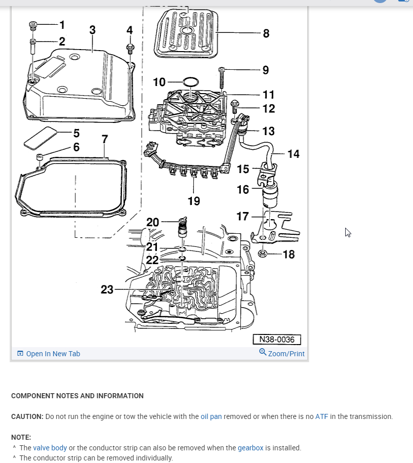

Car will not shift into any gear only reverse and in drive it only drives 10 to 15 miles per hour and accelerates max, but doesn't go any faster. Changed relays and now the car will not start or crank. OBD2 says needs solenoid A B C and D changed.

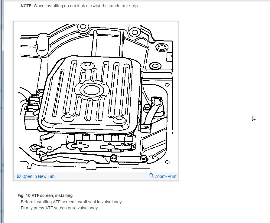

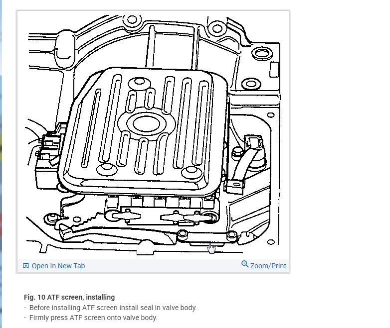

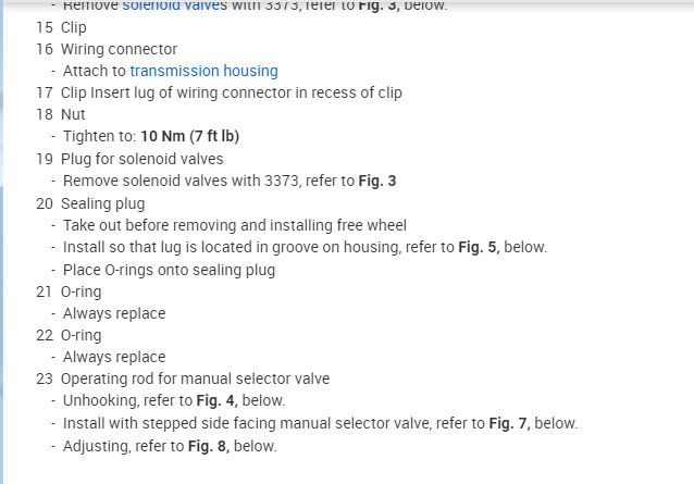

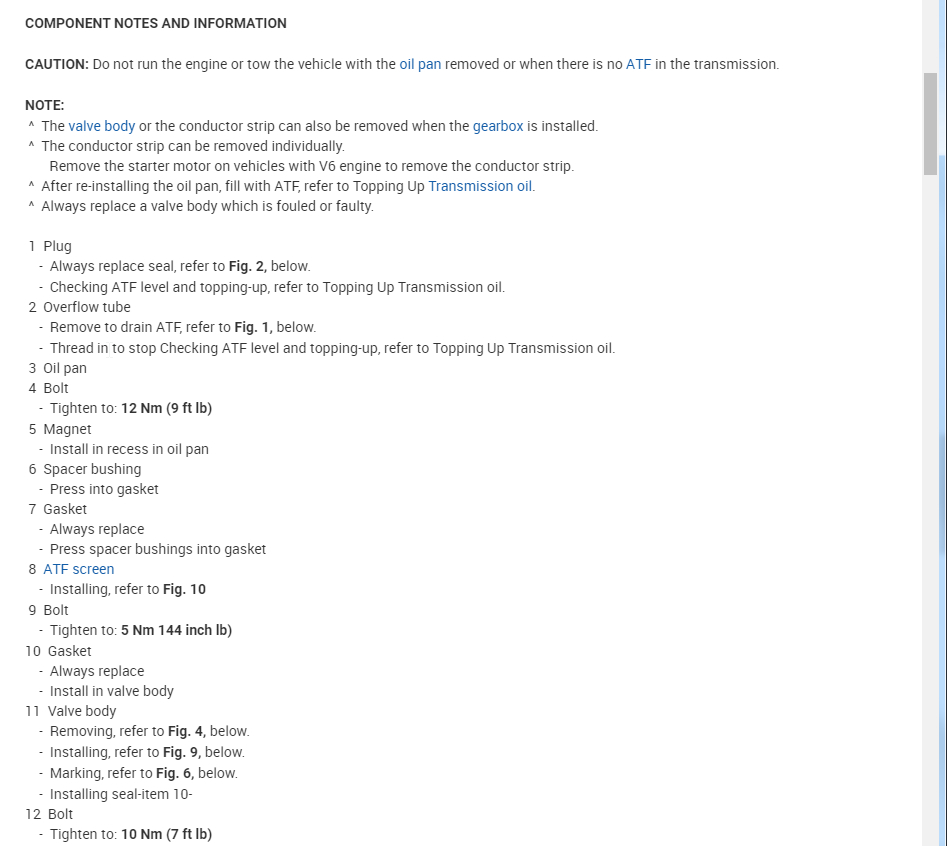

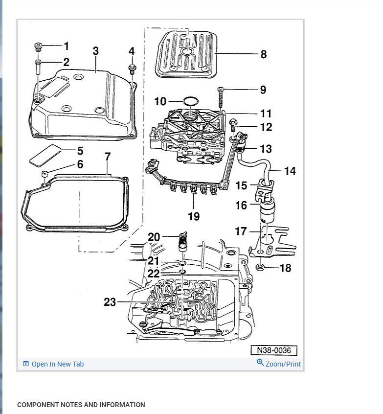

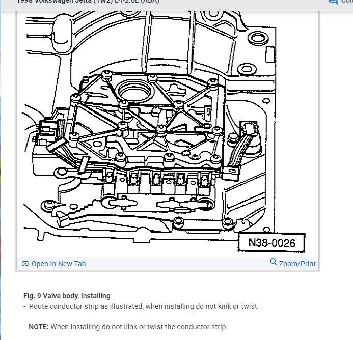

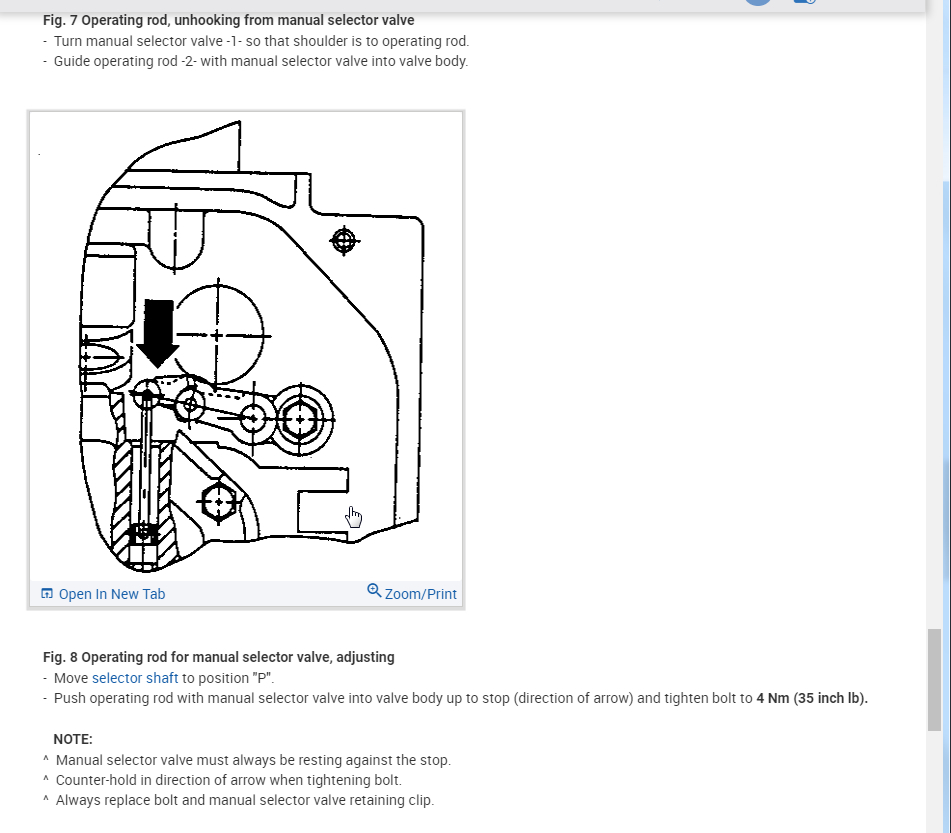

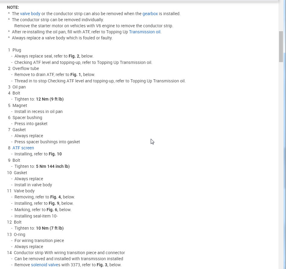

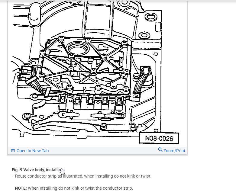

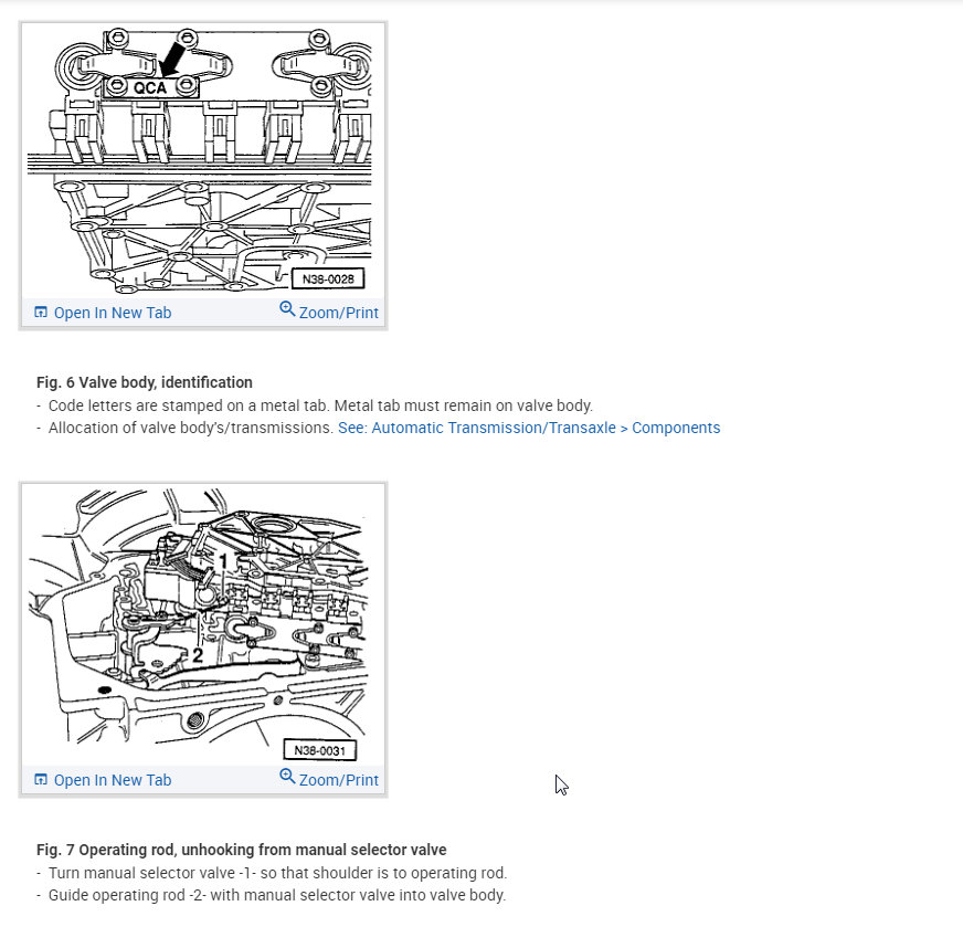

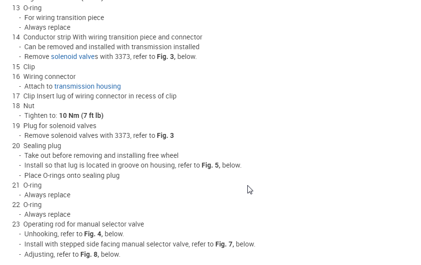

If you provide me the actual codes I can double check if they are in need of replacement or what the other causes could be. First of all the codes normally don't tell you to replace a part. They tell you what the issue is and there are multiple reasons for that to fail. The fact that you have 4 solenoid failures, I suspect there is a greater issue causing them to not operate. Which means just replacing all of them will not fix it.

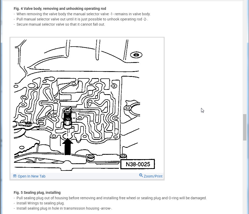

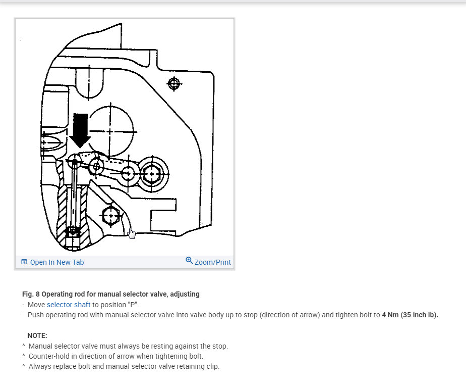

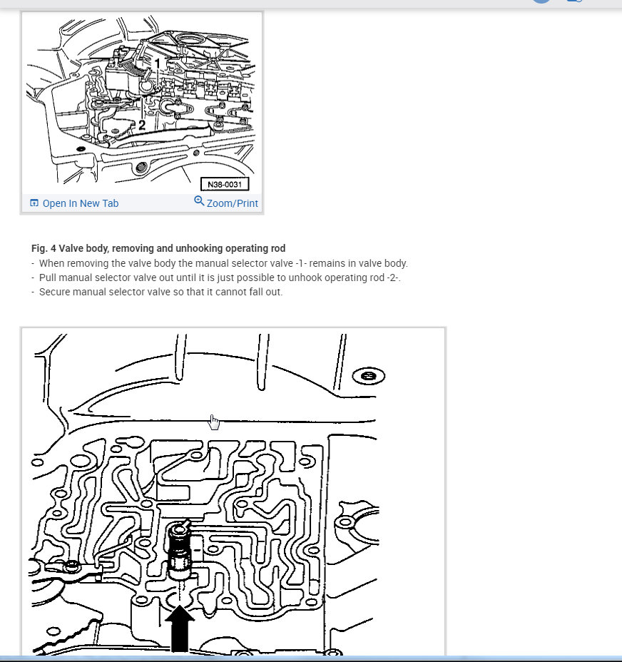

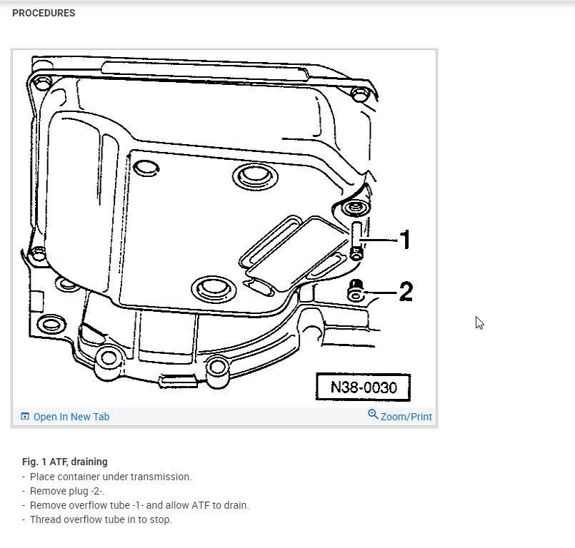

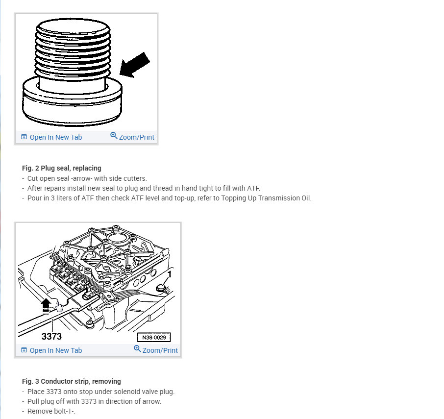

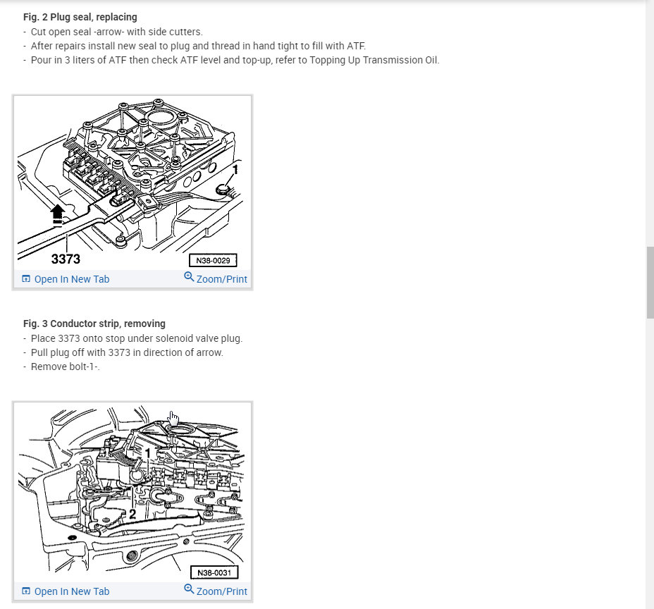

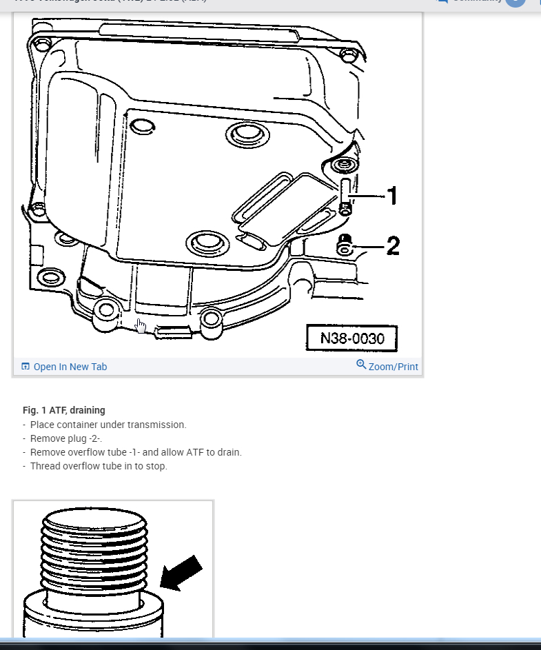

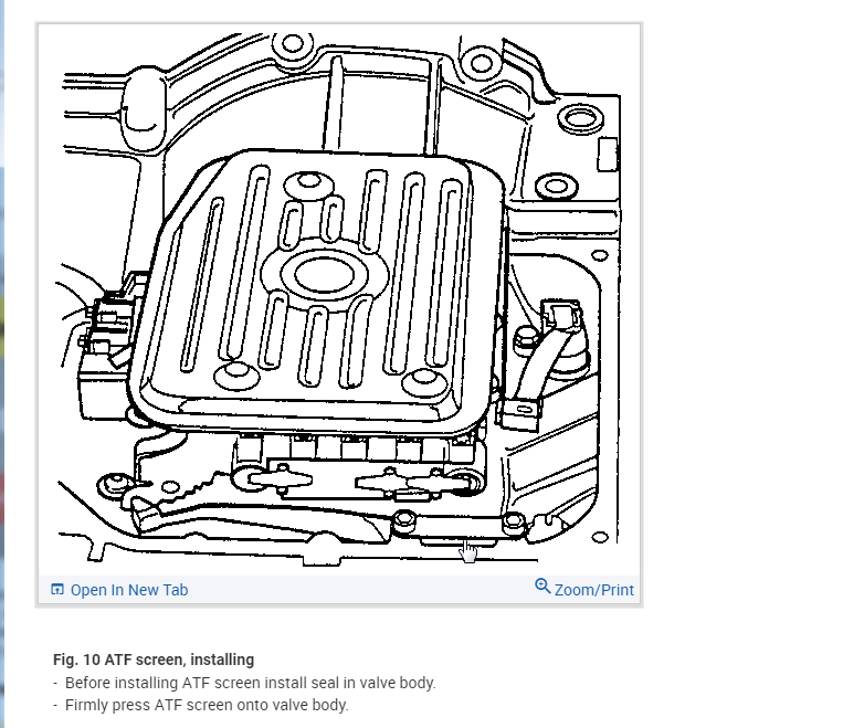

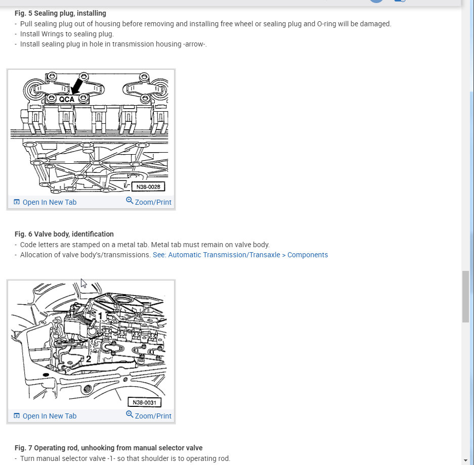

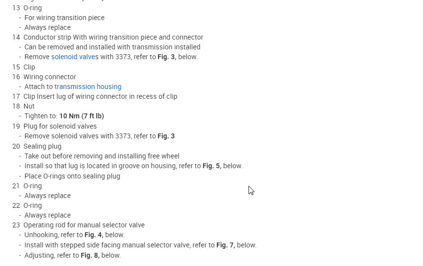

However, if they do need to be changed, here is the process to get the valve body out which houses the solenoid valves.

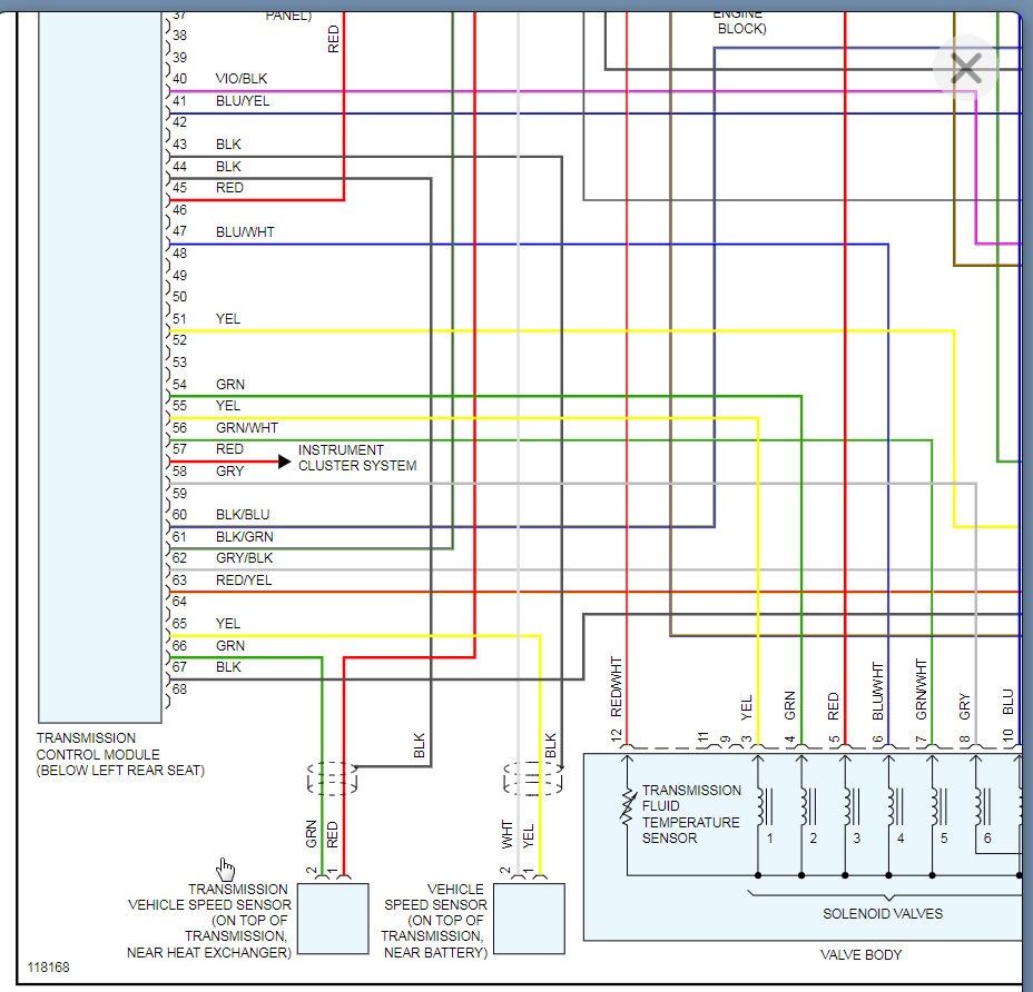

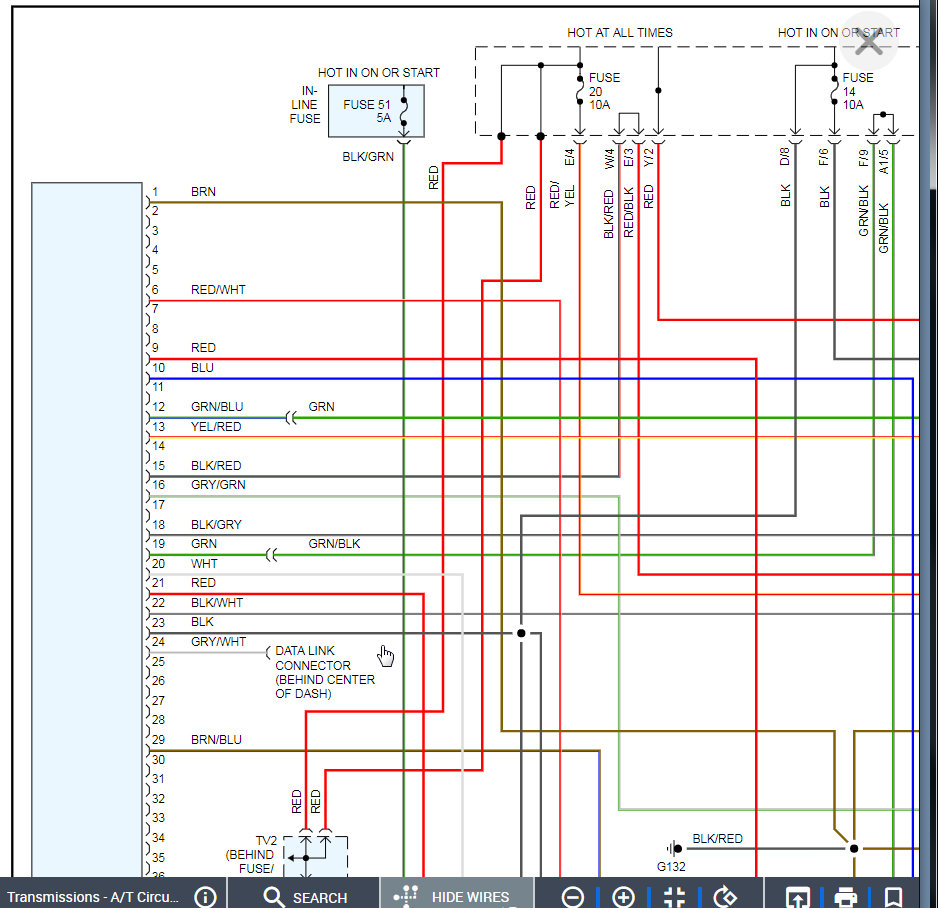

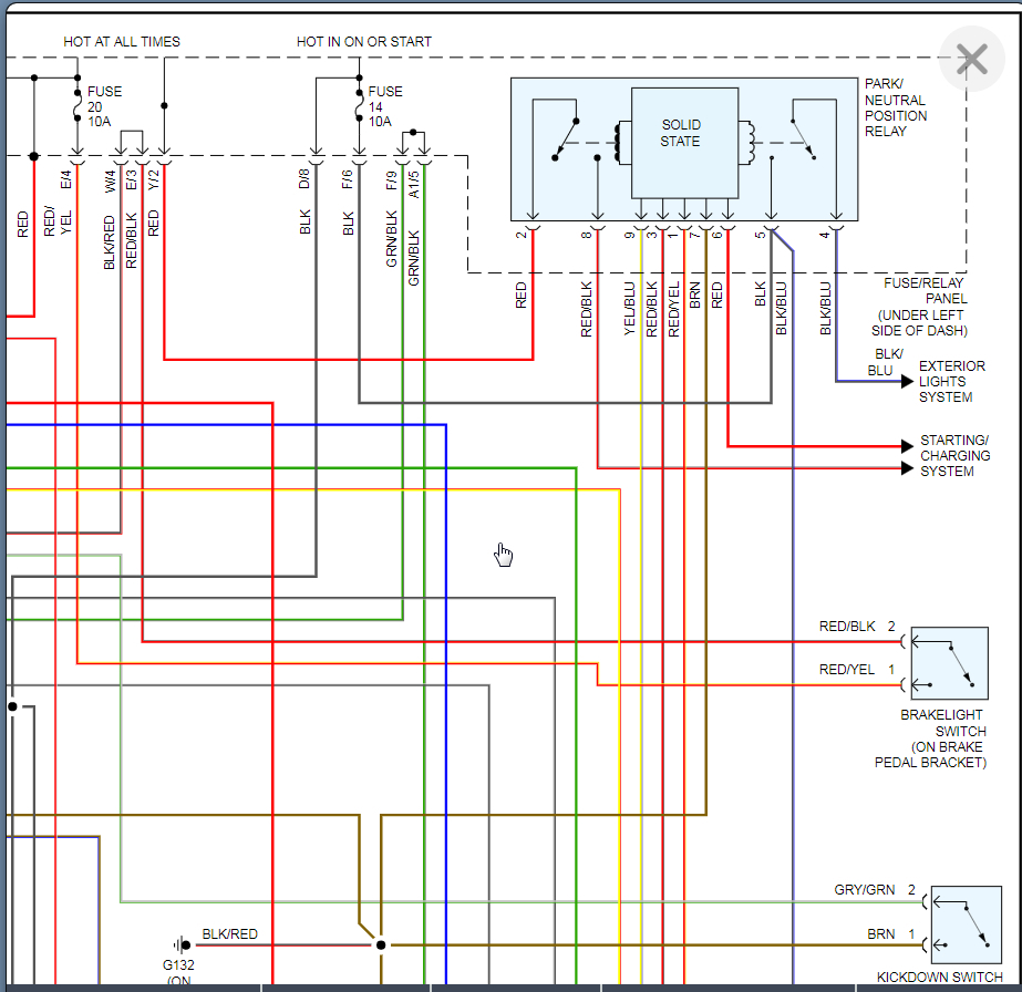

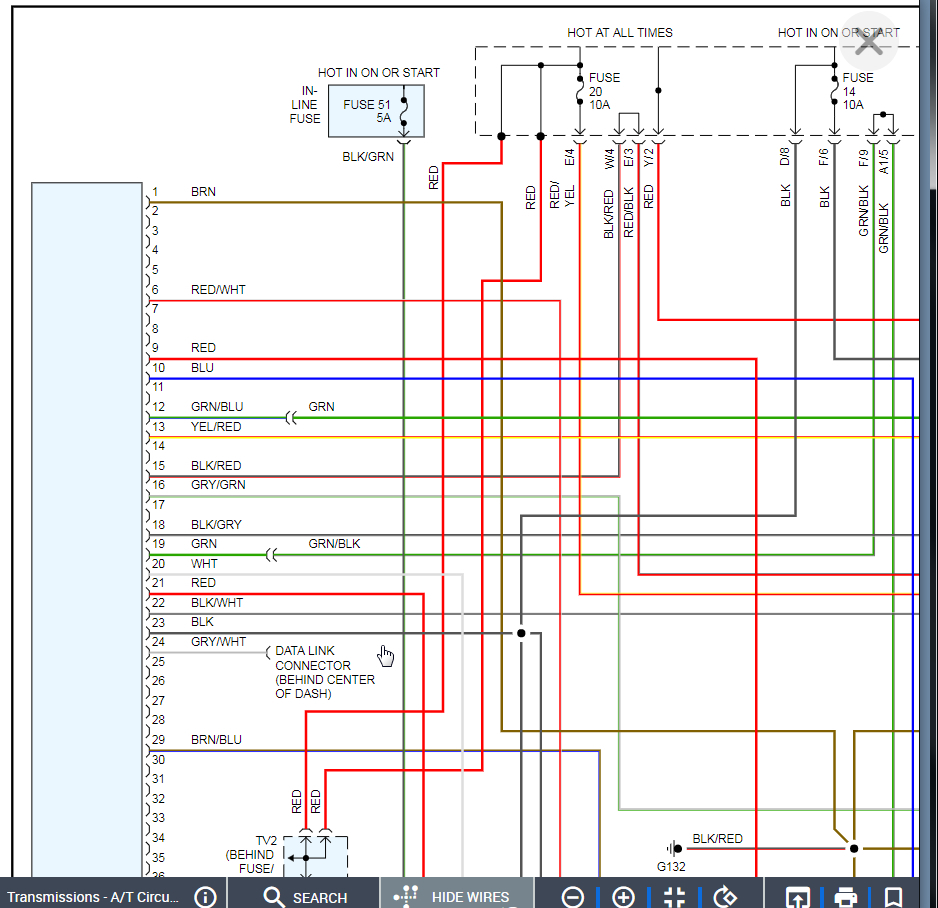

I can get them for you I just have to charge my battery, but in the meantime can you pull me a diagram of the car before the oil pan the wiring diagram? Could be a sensor.
Friday, January 10th, 2020 AT 2:46 PM

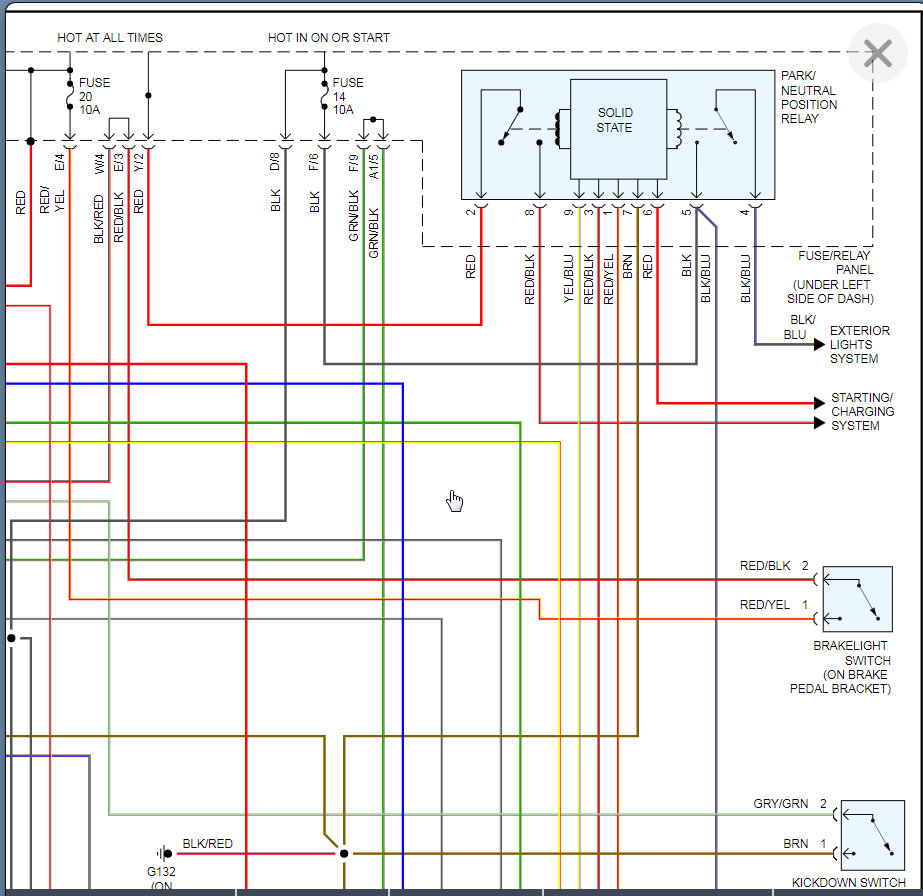

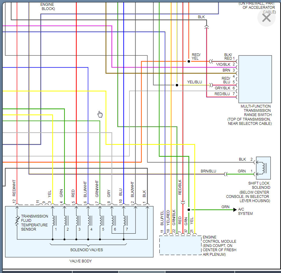

I am sorry. I am not understanding what you are looking for. You want a diagram of the solenoids?
Here is a diagram of the complete transmission circuits including the valve body with the solenoids. Let me know if this is not what you are looking for. Thanks

Here is the list of the codes that came up: p0341, p0753, p0758, p0763, p0768, p0773, p1778, p0748, p0715.
Saturday, January 11th, 2020 AT 8:14 PM
P0341 - Camshaft Position Sensor circuit performance Bank 1
P0715 - Input speed sensor Circuit A
P0748 - Pressure Control Solenoid A
P0753 - Shift Solenoid A
P0758 - Pressure Control Solenoid B
P0763 - Shift Solenoid C
P0768 - Shift Solenoid D
P0773 - Shift Solenoid E
P1778 - Solenoid EV7 Electrical Malfunction
The cam sensor code is not related but all others are. It does look like the valve body is the issue. I would go ahead and replace it.
