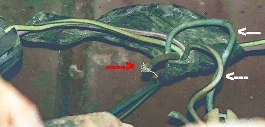

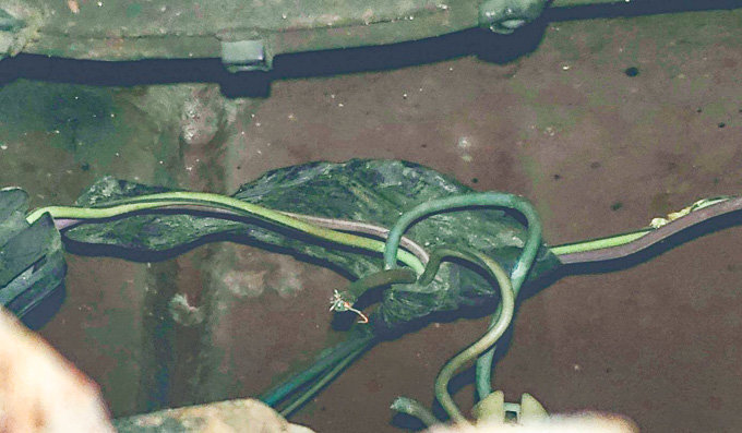

Here is my other problem with some broken wires that are toward the back top of transfer case, they appear to be "glued" to the back floor of the truck. There are two wires broken which might have to connect together? You can see in the picture which two wires and a white connector of some kind on the very bottom of the image. Is that a speed sensor, and should those two wires be connected together? If those aren't connected, what problems will I run into with 4wd operation?
The green/black wire might affect my fuel gauge system?, that stopped working correctly years ago.
There is also a green/black wire leading off to the right that is frayed, but I haven't tracked down where that goes as yet. Any help there would be much appreciated.
In case anyone asks, I have already worked on the front wiring pigtails to the actuator etc. they were corroded and were replaced. Now I just need to connect that wire to transfer case and repair the others you see there.

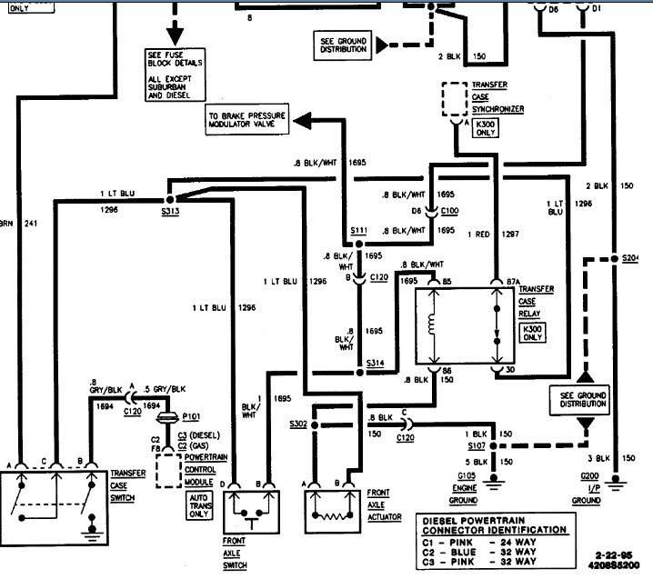

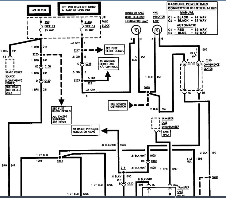

I've attached below the transfer case wiring diagram you requested .I've cut the picture into 2 pieces to make larger.Hope this helps and thanks for using 2CarPros.

Thank you, Danny. That diagram is going to help a lot! Question: Does the wire with the stripe at the bottom of the photo look gray and black to you? And the one to the right of it light blue? I haven't gotten under the vehicle yet today, it's bitter cold at the moment in the garage, so I haven't taken a closer look at those. I need to clean them up a bit to see the color a bit more clearly. Thanks again. :)

Sorry, was referring to my picture. On the diagram I can see a black/gray wire connected to the transfer case switch, and a light blue wire. In my photo I see what could be a black/gray wire and a blue wire coming out from the plastic connector(?) at the bottom right in the photo where the white arrows are.
This would indicate that IS my transfer switch, I hope. The broken wire above that with the wires sticking out of the end is a mystery to me as yet,(in the photo where the red arrow is)

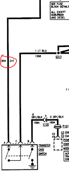

As per the photo you provided that looks like a brown wire. If so, That would be the Brown wire the feeds to the transfer case switch on the second picture diagram I sent to you previously. See picture below circled in red. Hope this helps and thanks again for using 2CarPros.

Danny, your diagrams and info were essential for this repair. thank you so much.
I have repaired the wires and cleaned corrosion on the pigtail plugged into the transfer switch. I now have 4wd operating! I will need to replace the corroded plug, but it will have to wait for warmer weather.
