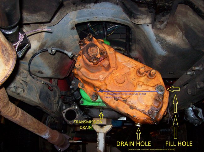

I have some pics from my '77 CJ-5
View is my head near the rear axle looking forward.
1) "My" fill plug used to be a "square headed pipe plug" I changed it to a "Hex" headed pipe plug (that's just me) Some plugs have a square hole that you use a ratchet in. MY FILL PLUG is seen on the right side, it's brass and just above one of the cover bolts.
Note: The case is never full! The fluid levels out at the same height as the bottom of the plug hole and gets sloshed around with the gears turning!
Your location/ type of fluid/ plug style probably differs. If you respond and want it, I may be able to pull up a diagram of yours from "Prodemand"

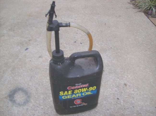

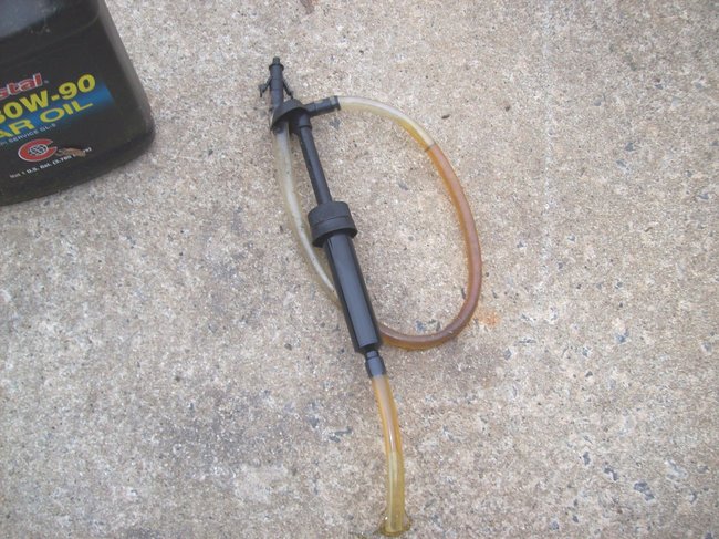

2/3) This is the cheap, very effective pump, (stuck in the gear oil "I" have to use.
Trying to squirt fluid in straight out of a quart bottle usually don't work because you cannot get the bottom of the bottle high enough with crap in the way! (this pump will fit into a quart bottle too!)

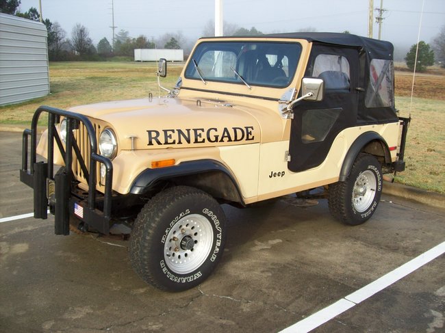

4) My '77 CJ-5

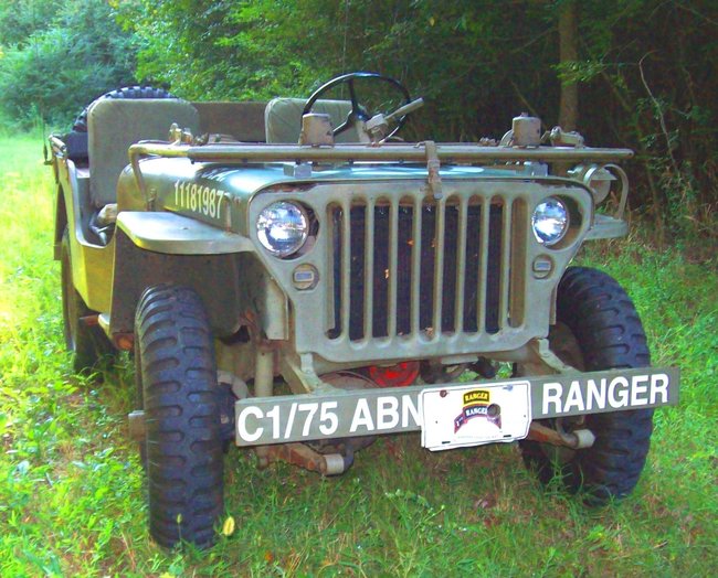

And below with my 71 year old Willys.
