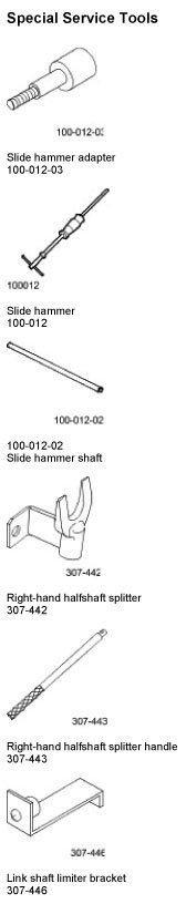

What is the special tool required to remove the top left retaining bolt in step 13?
Aug 25, 2018 at 11:21 AM
  • 110,241 POSTS
I am not sure what step 13 is in the directions you have. Step 13 in my directions deals with driveshaft removal. Here are the directions from Alldata. I have also attached a picture of the special tools required. All pictures correlate with these directions. I hope this helps.
_______________________________________
Transfer Case (46.10.01)
Special Service Tools (see pic 1)
Special Service Tools (See pic 2)

In those directions it is step 27. I need to know what that special tool is?
Aug 25, 2018 at 11:35 PM
  • 110,241 POSTS
Welcome back.
That is a 13mm x 3/8" drive torque adapter. It is in picture 2. Its only purpose is to tighten or loosen torque converter mount bracket bolts. If you check online, you will find them for sale. Just look up Jaguar special tool # 303-1069.
