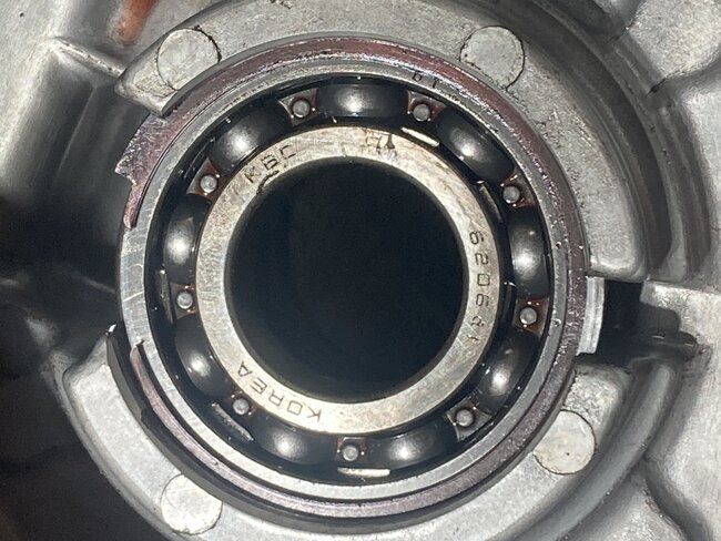

See photo. How do I get that clip out of there?

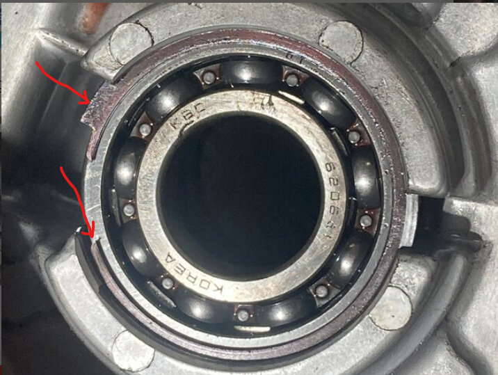

Yep, those are tricky, you need to use a small screwdriver and work one of the ends to get it up and out of the groove then slowly work the clip around and out of the retainer. I don't know of a tool that can remove that style of clip. Check out the images (below). Please let us know what happens.

Thanks, I will let you know if I succeed!

Please wear safety goggles!

Success! I got it out! Thanks!
