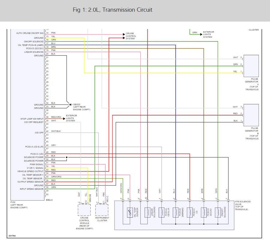

Had engine light with code p0713 popped up, it went into limp mode. So asked local shop if they give me quote, they did said most very likely sensor needs replacing according to they information they had. I Decided to test temperature sensor, seemed to be within specs until it reached operating temp at 178f+ at 3.44kohms, should be approx 1.08kohms, no over heating either, no burn fluid either. Finally took it to trans shop they replaced temp sensor w/ wire harness, code persists p0713 - high input A circuit electrical. Shop told me possibly bad PCM/TCM, maybe external wires. Any ideas? I figure sensor was acting up anyway but doesn't seem damaged and old harness looks okay upon inspection of solder points/connections. Didn't think much of it but I did have small amount of water pool in floorboard through sunroof that didn't drain properly, didn't consider it cause this issue since PCM/TCM/ECU is located by battery under hood anyway, right?

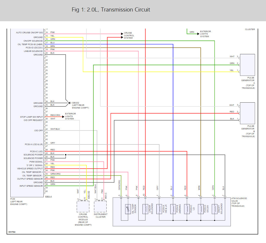

Yep, I would check the connections between the transmission and PCM before replacing the PCM. here is a guide to help you with the transmission wiring diagrams so you can see how it works and what to test:

Hey Ken, looks like only .01v at temperature sensor connection from PCM, so went to connector at PCM and found plug was slightly corroded and nearly impossible to unplug and cover was slightly loose on connector but no corrosion inside just sprayed some lube. made sure it's secured and no loose wires, problem solved! No check engine light on, cleared codes with obd scan tool but still car is in limp mode. not sure how to clear or flash or reset it, or update any TCM software etc. any thoughts on that? if I use diy diagnostic 20pin plug connect in at engine side under hood, will that allow me to clear flash trans? I still think original temperature sensor was not reading right at operating temperature so probably needed replacing.

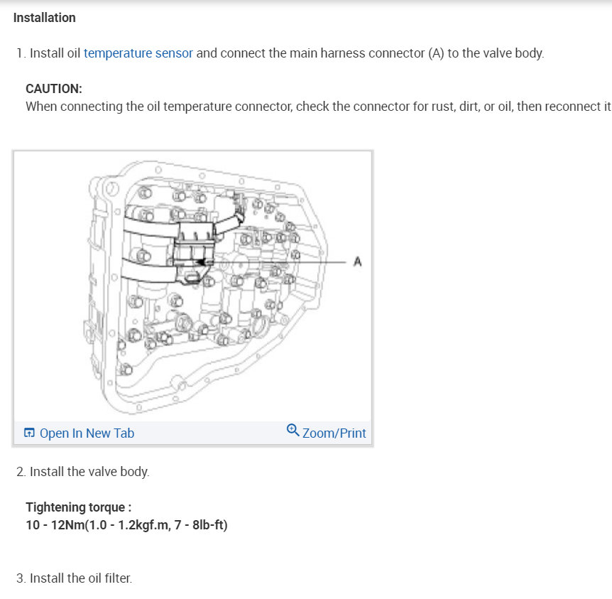

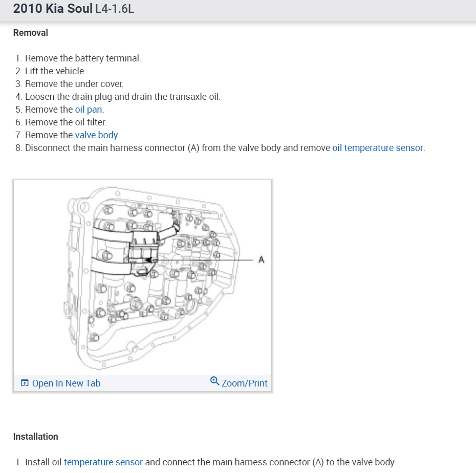

BTW- I wonder why none of the TSB's specify reprogramming for temperature sensor replacement, not the specifically for this type sensor within wire harness transmission à4cf2 nor the '11 type with one screw in type with trans a6cf1, is it only required if transmission goes into limp mode? Everything I read seems like if transmission temperature sensor related repairs calls for no reprogramming, just plug-in and play.

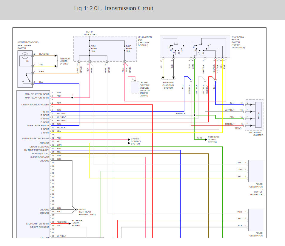

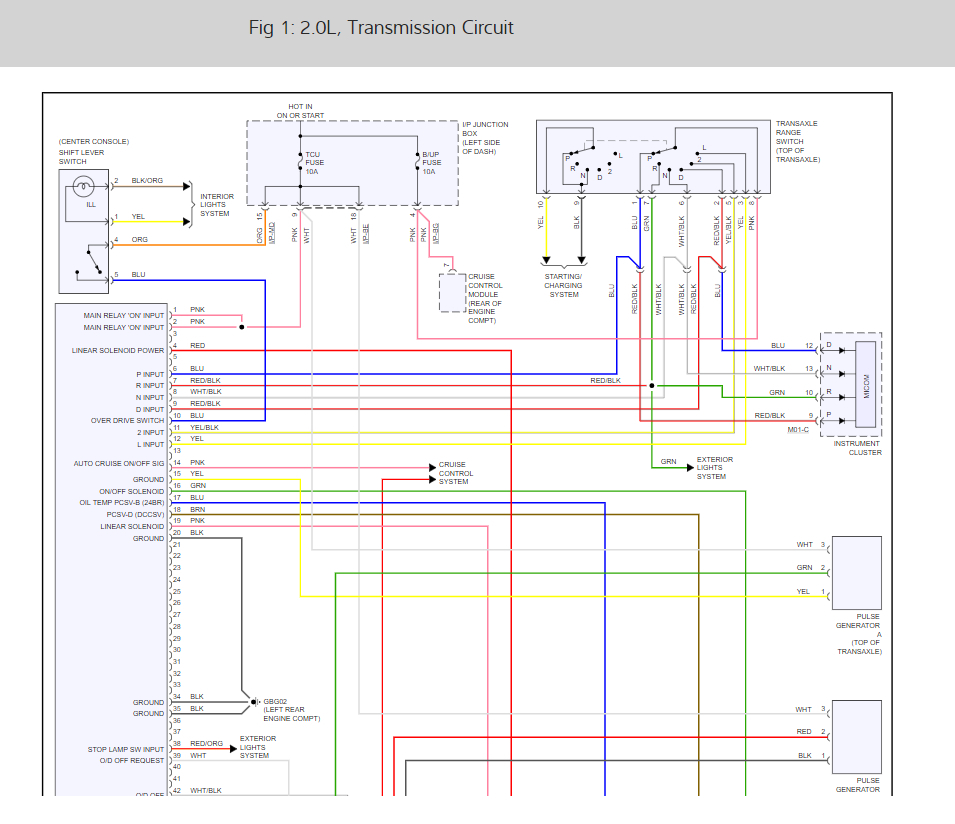

well here is what i discovered, +/- at trans plug for temp sensor don't match diagram, instead of pink+/greenW/orange-, it's light grey /blue -. also probed #6 temp sensor (+) shows power 4v approx. but when using #7 (-) but only .02v when probe #5 (-), same with #6, same goes for #5 shows - when i probe other pins like #1, #2 etc. so power is going to those wires. and pcm seems fine since i got replacement unit at junkyard for $5 to try and same codes pending p0713, with p0765 following afterwards. i feel as if something else im missing here that's simple or easy solution, some switch or relay or something that maybe went bad when original temp sensor "failed". also, not sure but #2 trans wire for 2-4brake is listed as temp sensor, how it plays in this role? also, what else feeds into this whole "temp sensor" function? i did have shift cable that broke and i had shifter in "park" but used the trans selector in "neutral" to start and move it manually by hand under the hood, maybe that shift selector switch solenoid failed that's on top of trans which attaches to shift cable? seems like bit after that all this started, maybe related or not?
Jul 19, 2019 at 2:51 AM
  • 55,433 POSTS
p0713 circuit high so the sensor has gone bad or the wiring is not right. Lets recheck the connections. Check out the diagrams (below). Please let us know what happens.
Jul 19, 2019 at 10:22 AM

  • 9 POSTS
seems like the #5 ground wire towards the trans connector, voltage seems to swing wildly if i massage and play with it approx 6-10" from connector plug going up, .20v to 3-4v depending on how it's bent and twisted, not sure if it's rotted in the sheathing or what but will unravel that wrapped tape to expose the 10wires but #5, maybe #6 or both shorting or grounding out. seems like that's the prob area there. thanks

  • 55,433 POSTS
Yep you found it bad harness it sounds like. Please let us know if you need anything else to get the problem fixed.
