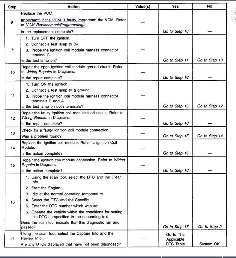

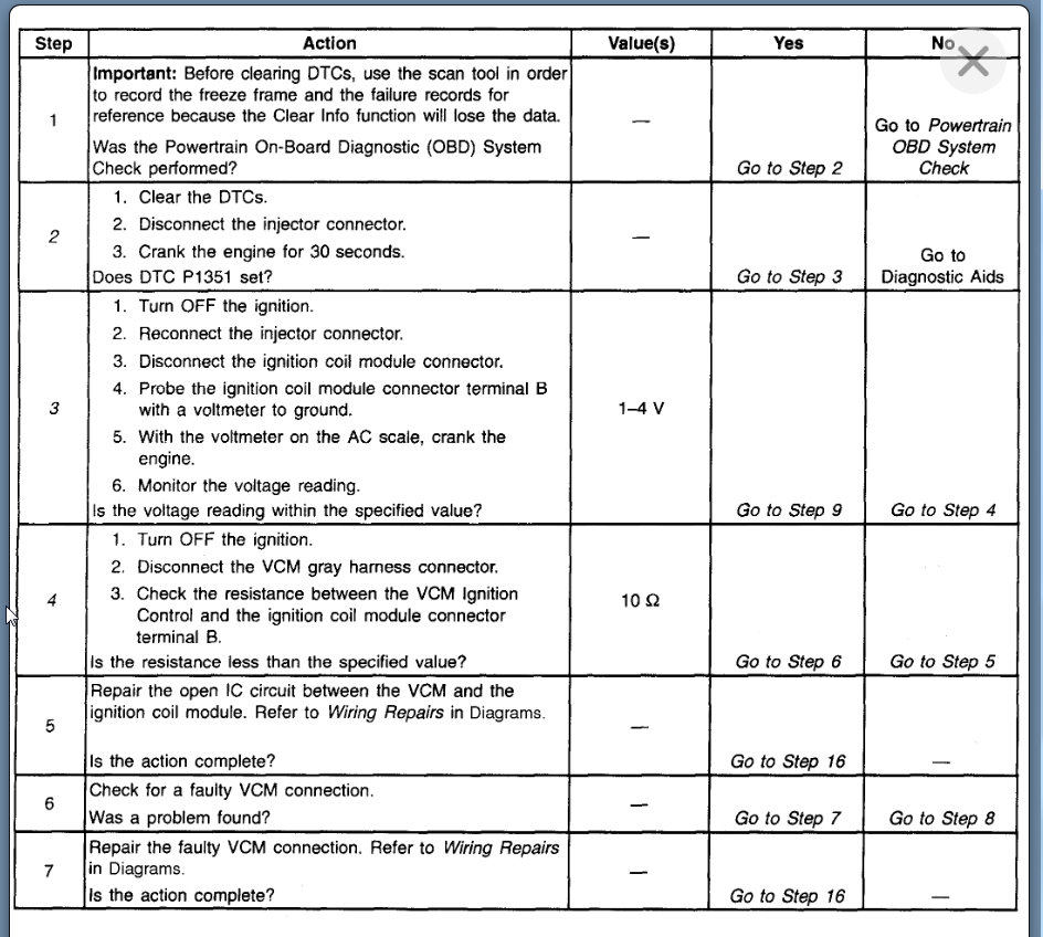

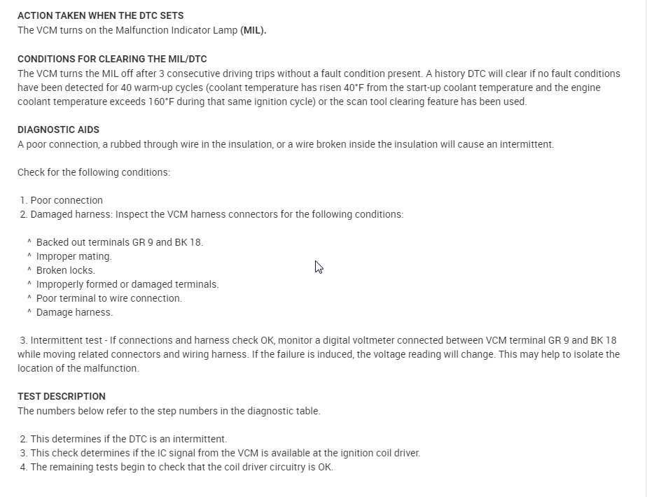

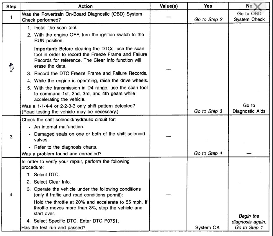

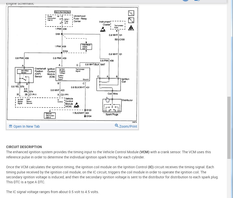

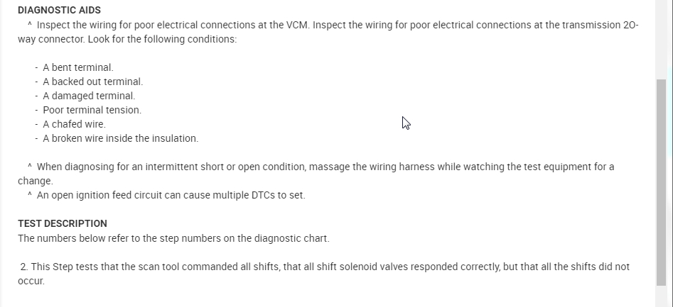

These codes are all pointing to an electrical issues or control module. I attached the testing that we need to run through in order to find out what this is. I attached the testing for the P0753 and P1351 as these two are the most likely cause or at least lead us to the issue. Each of the others are considered redundant or secondary codes.
Let's run through this and we can go from there. Thanks
