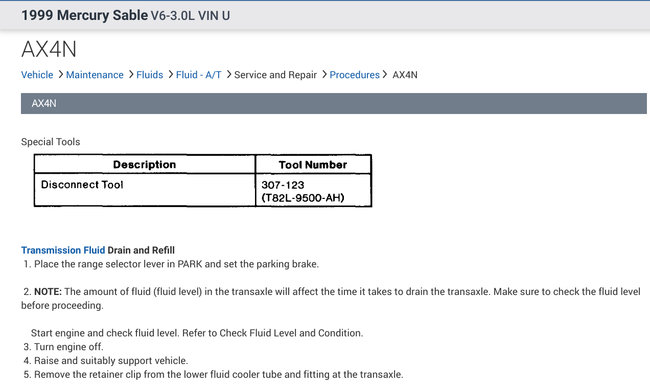

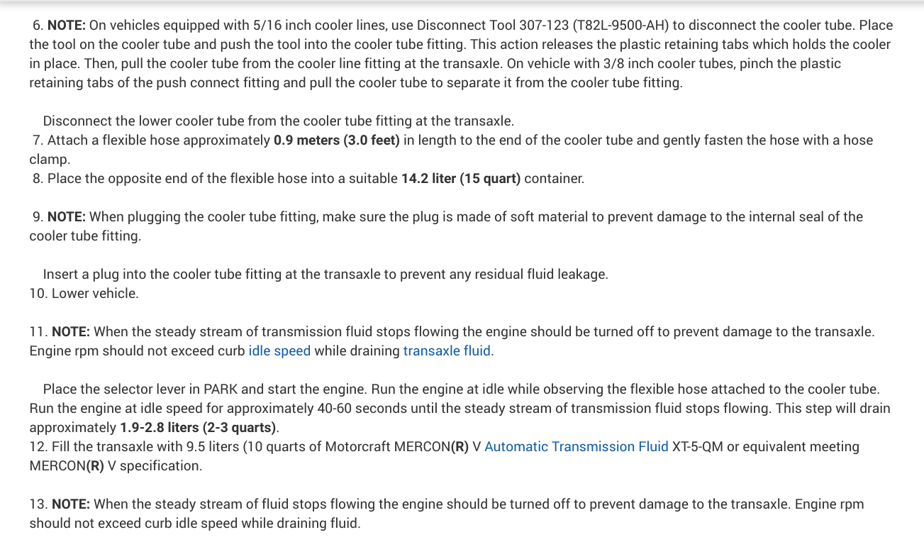

Just want to know about what it would cost to go get a transmission flush? trying to help my neighbor out and you guys were so great helping me with my fuel pump in my Jeep.
Mar 1, 2020 at 8:16 AM
SCGRANTURISMO
  • 4,897 POSTS

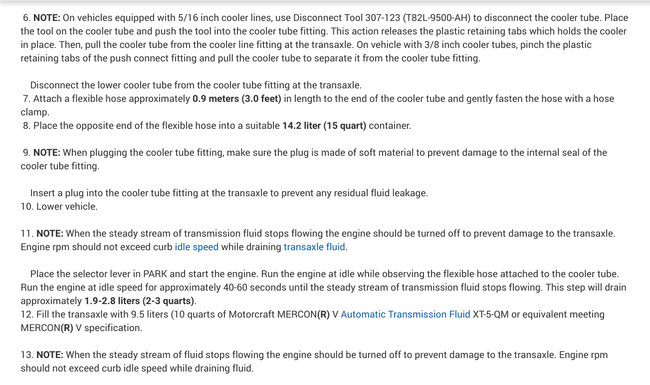

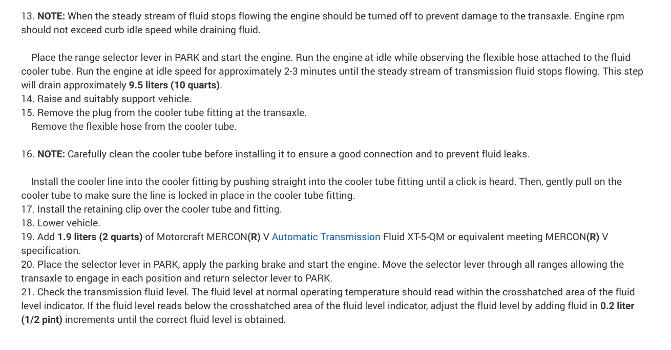

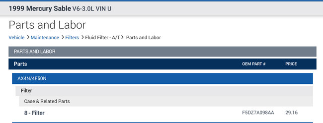

My estimate would be around $40.00 to $50.00. In the diagrams down below I have included the instructions for the draining and filling of the transmission fluid in your vehicle and the Original Equipment Manufacturer[OEM] part number for the transmission filter. Please get back to us with how everything turns out.
