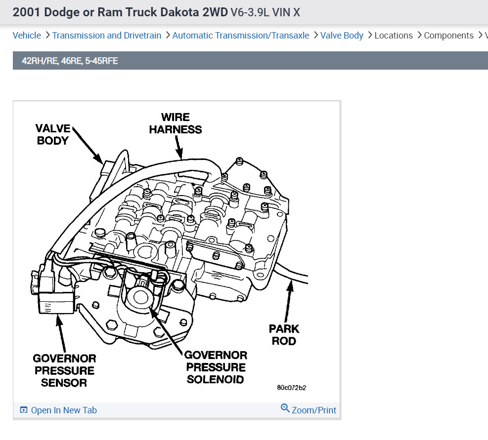

I'm getting a code on transmission and need to know about replacing it p1767. Sensor likely. At light it advances forward at times after 30 seconds.

Here is what is said about the p1767 code:
The P1767 code in a 2001 Dodge Dakota indicates a problem with the transmission's governor pressure solenoid circuit.
So, make sure the fluid is clean and full and if so let's change out the filter and the pressure control solenoid. Here is the location of the part in question in the images below. Also check the wiring to the solenoid as well. Check out the images (below). Let us know what happens and please upload pictures or videos of the problem so we can see what's going on.
