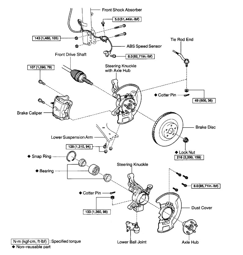

Traction control lights?
2004 TOYOTA RAV4
214,000 MILES • 2.0L • 4 CYL • 2WD • AUTOMATIC
RODNEY CONAWAY

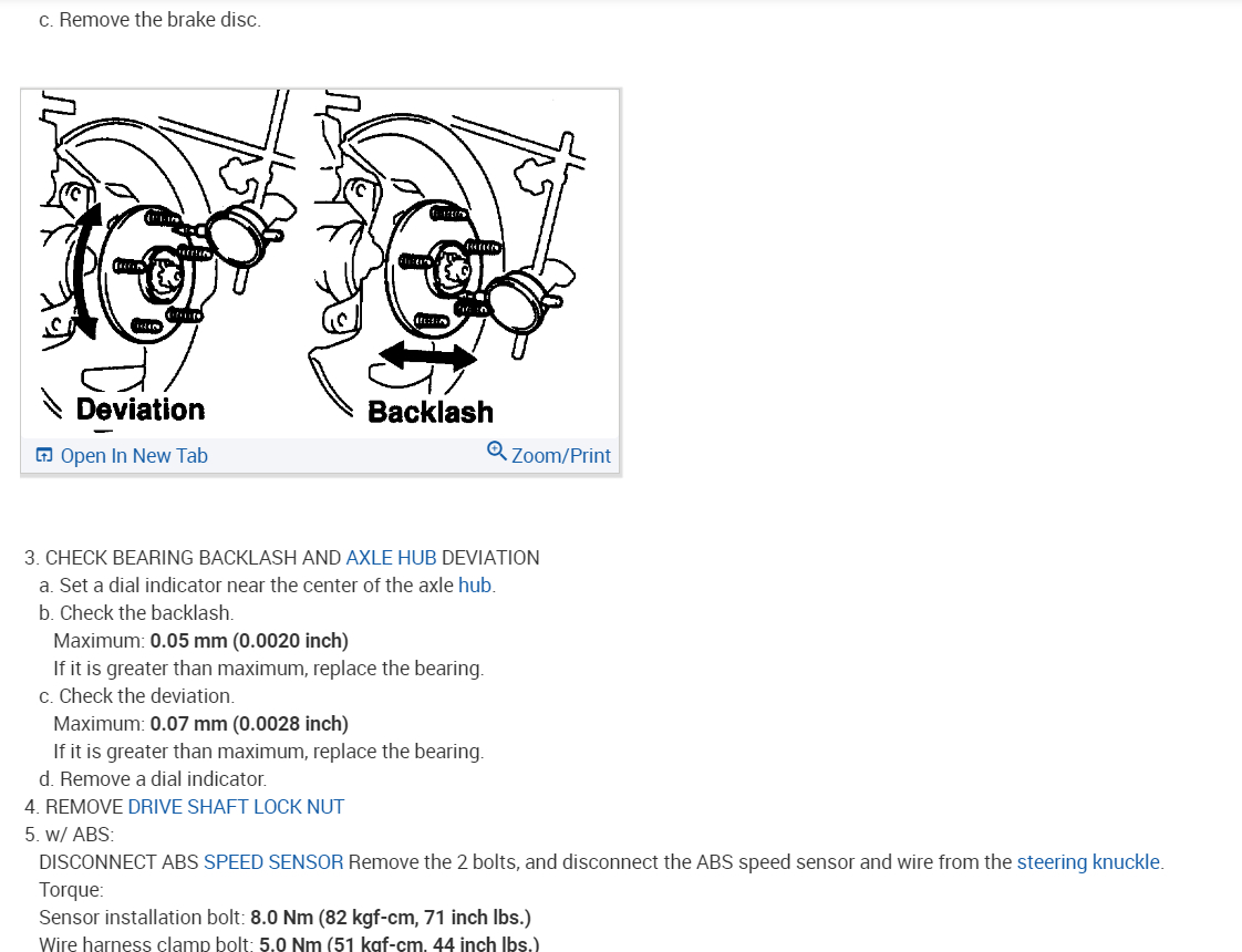

It will come on now and then light an beep, and it will pull to the right like brakes slammed on.
Aug 11, 2023 at 9:06 AM
  • 55,433 POSTS

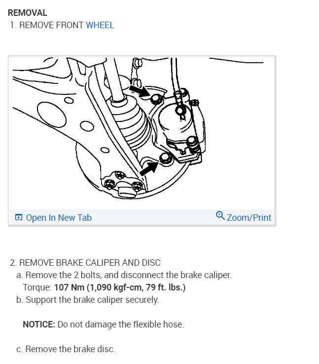

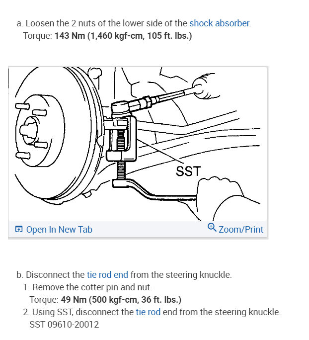

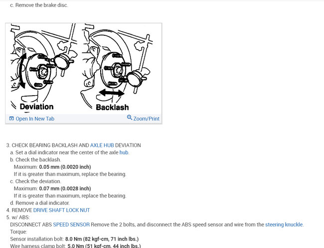

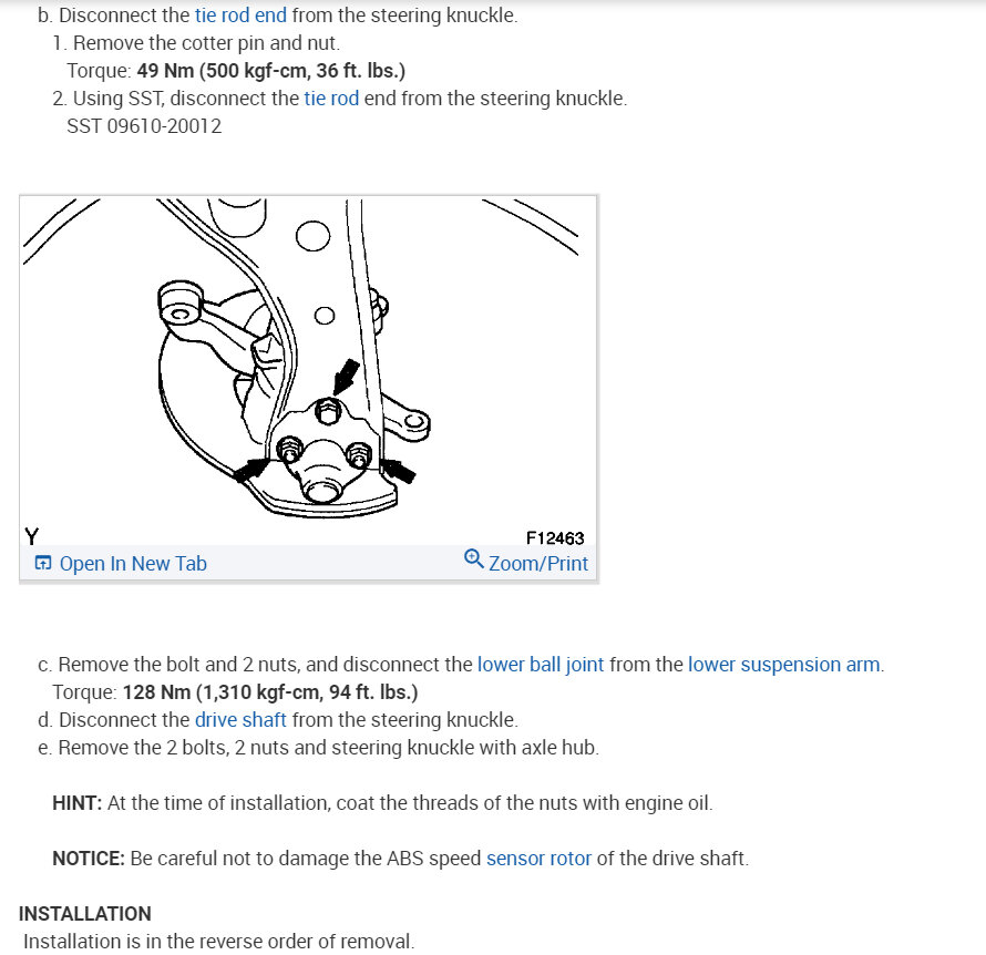

Okay, i would lift the front end and grasp the right front wheel to see if the bearing hub is loose and if so, this is what is causing the problem of the transaction control light and the pull to the right.
Aug 12, 2023 at 7:31 AM
RODNEY CONAWAY
Thank you, I will try that!
Aug 12, 2023 at 8:06 AM
  • 55,433 POSTS
Please let us know what happens :)
Aug 14, 2023 at 4:10 AM
RODNEY CONAWAY
It was the bearing hub, thank you so much I'm going to tell my family, and friends about this.
