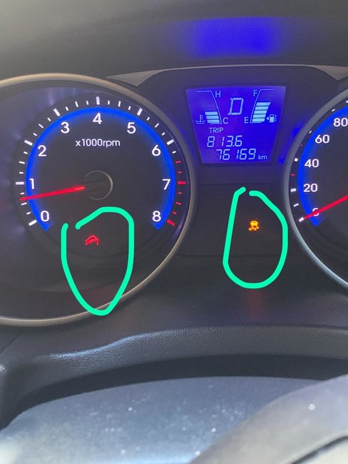

While driving the car listed above ix35, all of a sudden the traction control and hill descent control warning lights came on. I have switch off the car and started it again but the lights remains on. Is it a bad wheel speed sensor?or some wiring problem? Just like to know where first i should diagnose the problem.

After arriving to my destination I switched off the engine and restarted it again. the warning lights were gone, but still I went on to put the scanner( Autel al619) and there was no code found..

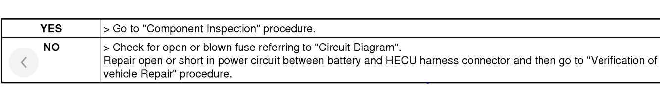

I found a code "C1513 brake switch error" after accessing the ABS system.
May 13, 2020 at 2:59 AM

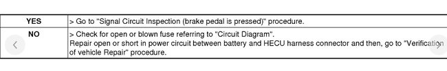

Okay, below is a description and flow chart for the code. It is related to the brake switch control circuit.
Electronic Stability Control
C1513 Brake switch error - Scantool Diagnostics
Monitor GDS Data
1. Connect scantool to Data Link Connector(DLC)
2. Ignition "ON" & Engine "OFF".
3. Press the brake pedal.
4. Check the service data related to "Brake Switch" on the GDS.
Specification :The brake switch's signal changes from OFF to ON.
5. Does the service data change normally?

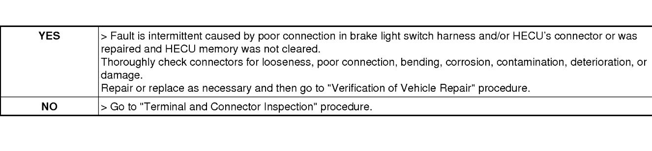

C1513 Brake switch error - Component Inspection
Terminal and Connector Inspection
1. Many malfunctions in the electrical system are caused by poor harness(es) and terminals. Faults can also be caused by interference from other electrical systems, and mechanical or chemical damage.
2. Thoroughly check connectors for looseness, poor connection, bending, corrosion, contamination, deterioration, or damage.
3. Has a problem been found?

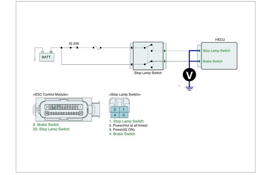

Signal circuit inspection
Signal circuit inspection (brake pedal isn't pressed)
Open or Short Check
1. Ignition "ON" & Engine "OFF".
2. Measure voltage between brake light switch (brake switch) terminal of the HECU harness connector and chassis ground.
Specification :Brake light switch - 0V
Brake switch - B+
3. Is the measured value within specifications?

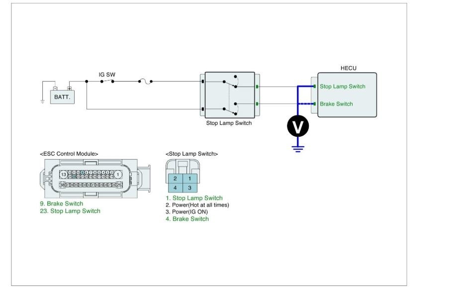

Signal Circuit Inspection (brake pedal is pressed)
Open or Short Check
2. Press the brake pedal.
3. Measure voltage between brake light switch (brake switch) terminal of the HECU harness connector and chassis ground.
Specification :Brake light switch - B+
Brake switch - 0 V
4. Is the measured value within specifications?

During a detailed inspection on wiring I found the connector on the brake switch to be loose and one of the wires has some chaffing on it. Had to repair the wire and secure the connector.
May 30, 2020 at 4:06 PM
Okay, did the lights go out and everything return to normal?
May 30, 2020 at 8:31 PM
MARK87
  • 61 POSTS
Yes, everything back to normal. many thanks.
