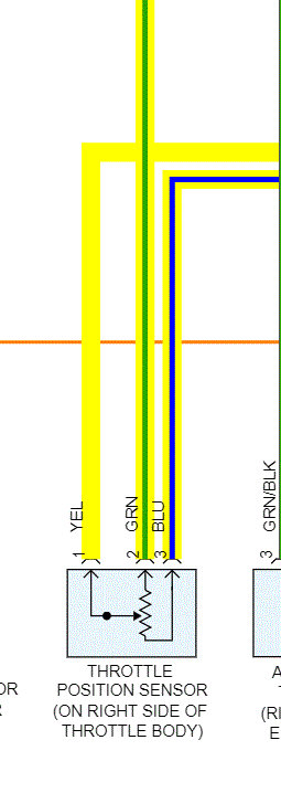

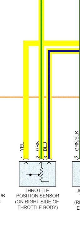

On the accent there are three wires to the TPS. Yellow is sensor signal, blue is ground, and green power. Are those the same as your vehicle? If they are, there should't be 5.7V on ground which I feel you already know. Since you basically have 5v on all three wires, my first suspect is the connector has shorted internally and allowing power to each pin.
Most importantly, let me know if the wire colors you are dealing with are the same. I don't want to jump ahead and provide incorrect information.

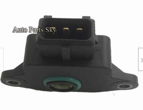

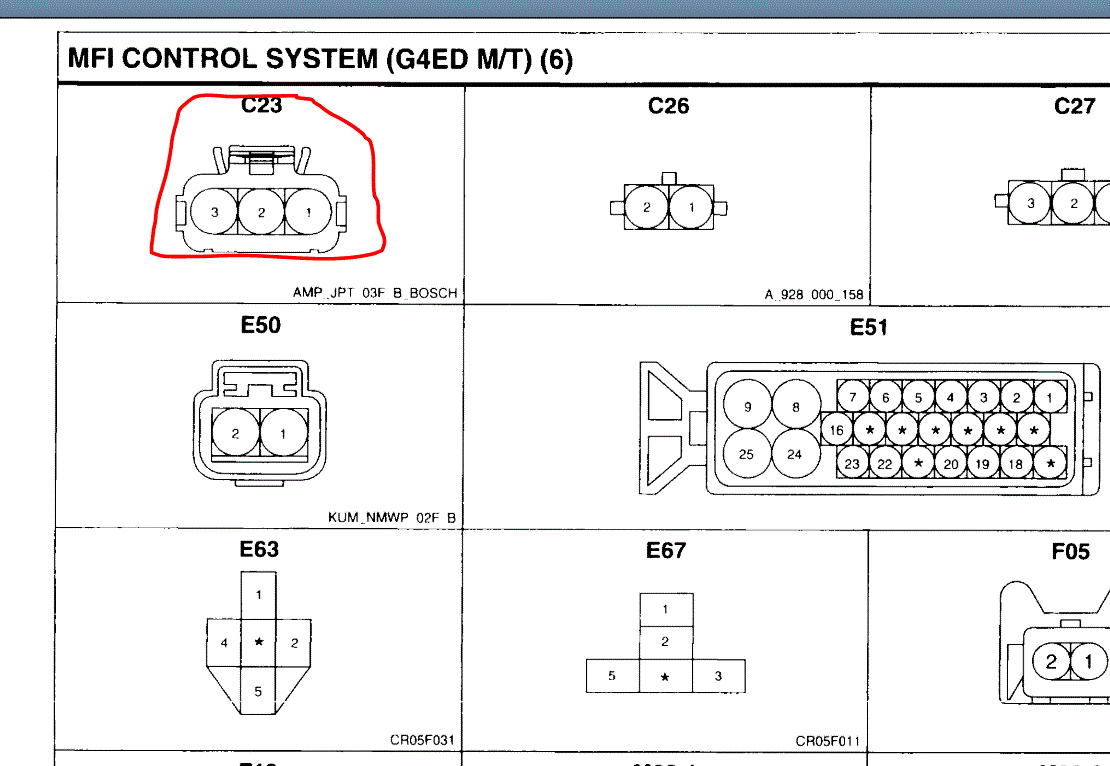

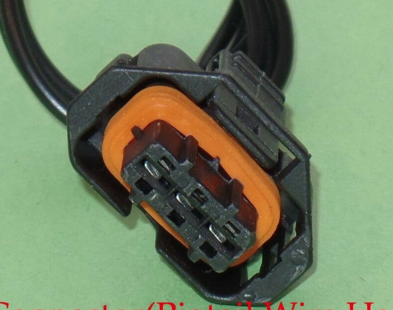

Thank you for your fast response. well, the car has gone through tons of repairs and even its transmission, ECU, motor and almost everything (except the car chassis) was changed lol, the connectors were kind of remade because the car transmission was replaced from manual to automatic, so the TPS has 3 wires, 2 green which are the +ve and signal, 1 grayish black which is the ground wire. I guess the transmission replacing process messed the whole thing up.
I heard from some people suggesting that the problem may be due to a short-circuit on the ECU board or on the TCM.
So, how to make sure of the main cause of this problem? And why does the ground wire gives 5.7v not even 5v?
I have attached photos of the connector and the TPS.

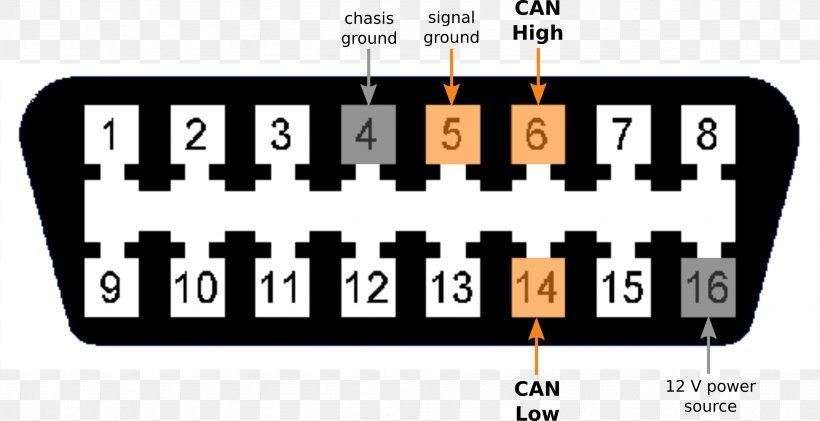

I connected the chassis ground (Pin 4) to signal ground (Pin 5) on the OBD connector and the problem is solved. what does this indicate?
May 1, 2020 at 2:25 PM
  • 110,194 POSTS
Is the vehicle now running? Honestly, it sounds like someone disconnected or damaged the signal ground. Ugh!!! I feel bad for you trying to fix this one.
