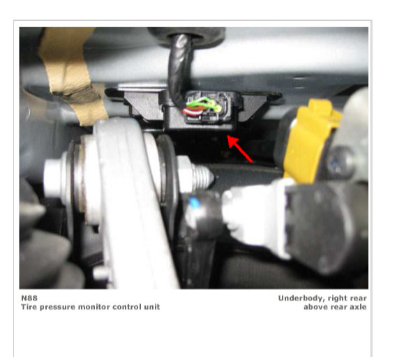

Hey, there. The TPM system shows an error like the sensor is missing or something (the all four sensors are on wheels ). Anyway, the real question is: can you help me locate the TPM receiver on e class w212? so there is a module the sensors (on wheels) but what about the receiver(s)? The module includes the receiver or what? Where is the receiver? Or is there a receiver? I read it should be located behind the front passenger kick plate. Still have no clue. So please can someone draw a map/diagram? Thanks a lot.

On this vehicle the module is located above the suspension on the passenger side rear tire.
I am attaching the pictures below. However, can you provide the codes that you are getting?
There is a chance that there is another issue so we need to see what the actual code is, and we can get the testing and go from there.
Below you will see the pictures which illustrate the location of this part. Please let us know if you have other questions. Thanks
